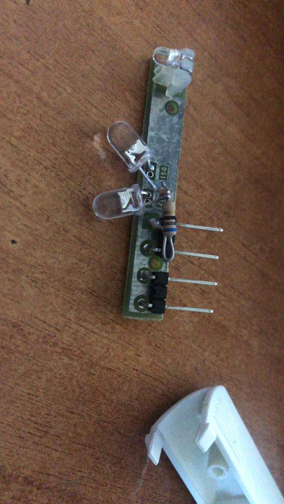

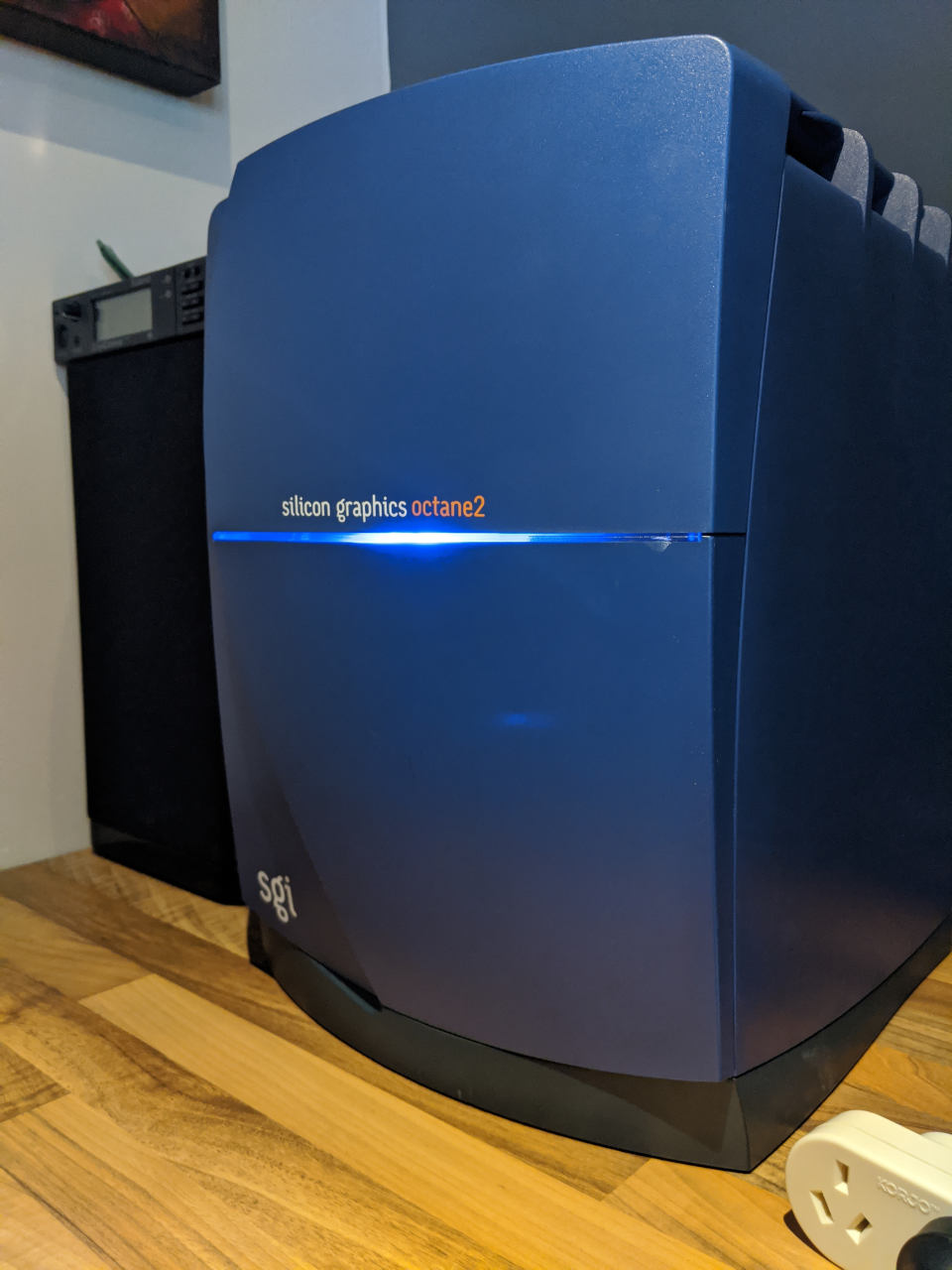

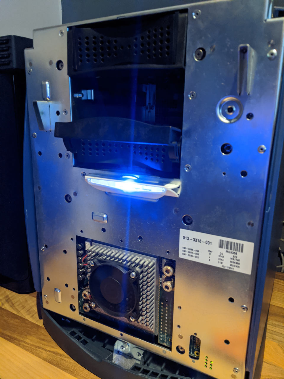

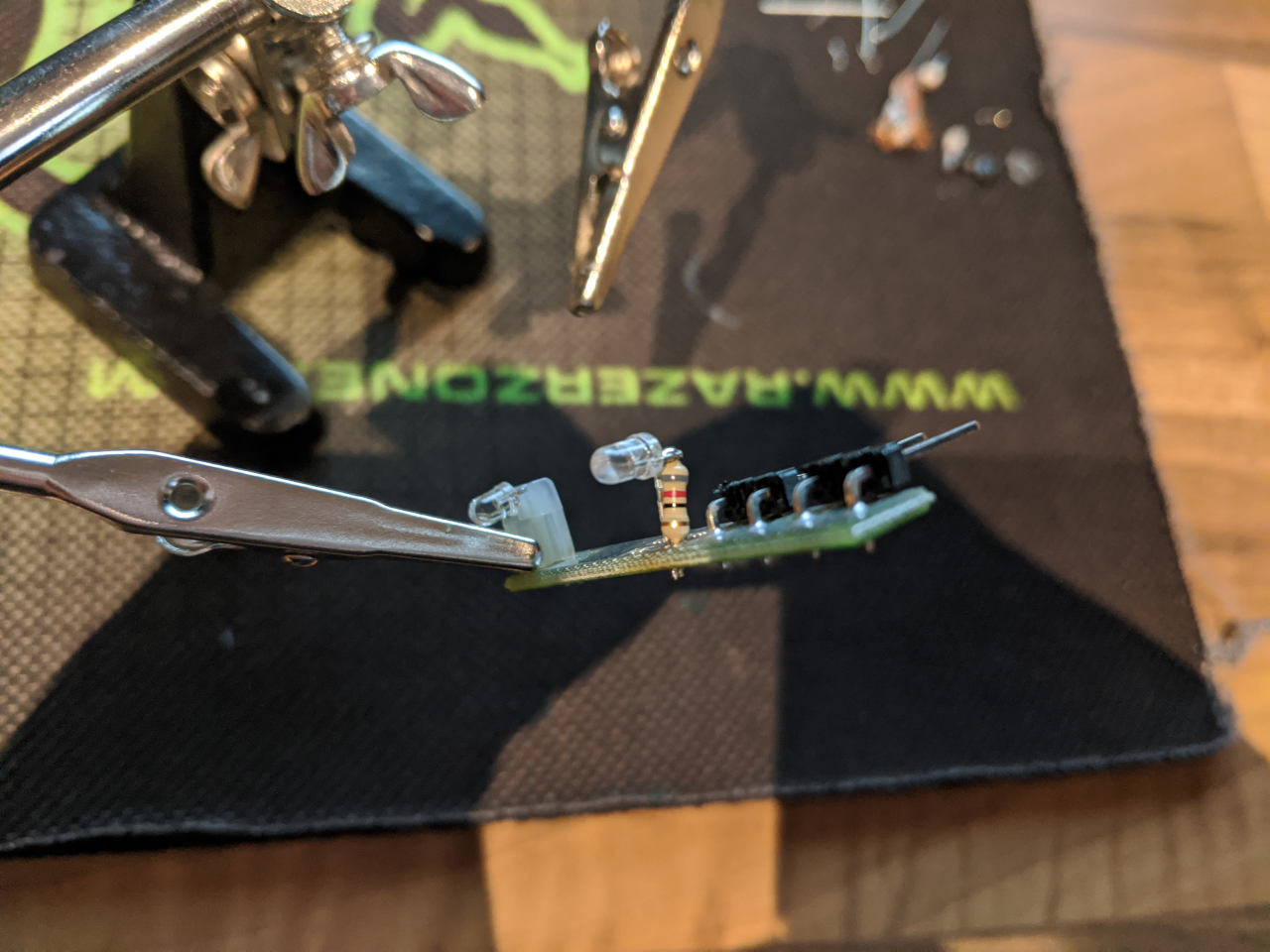

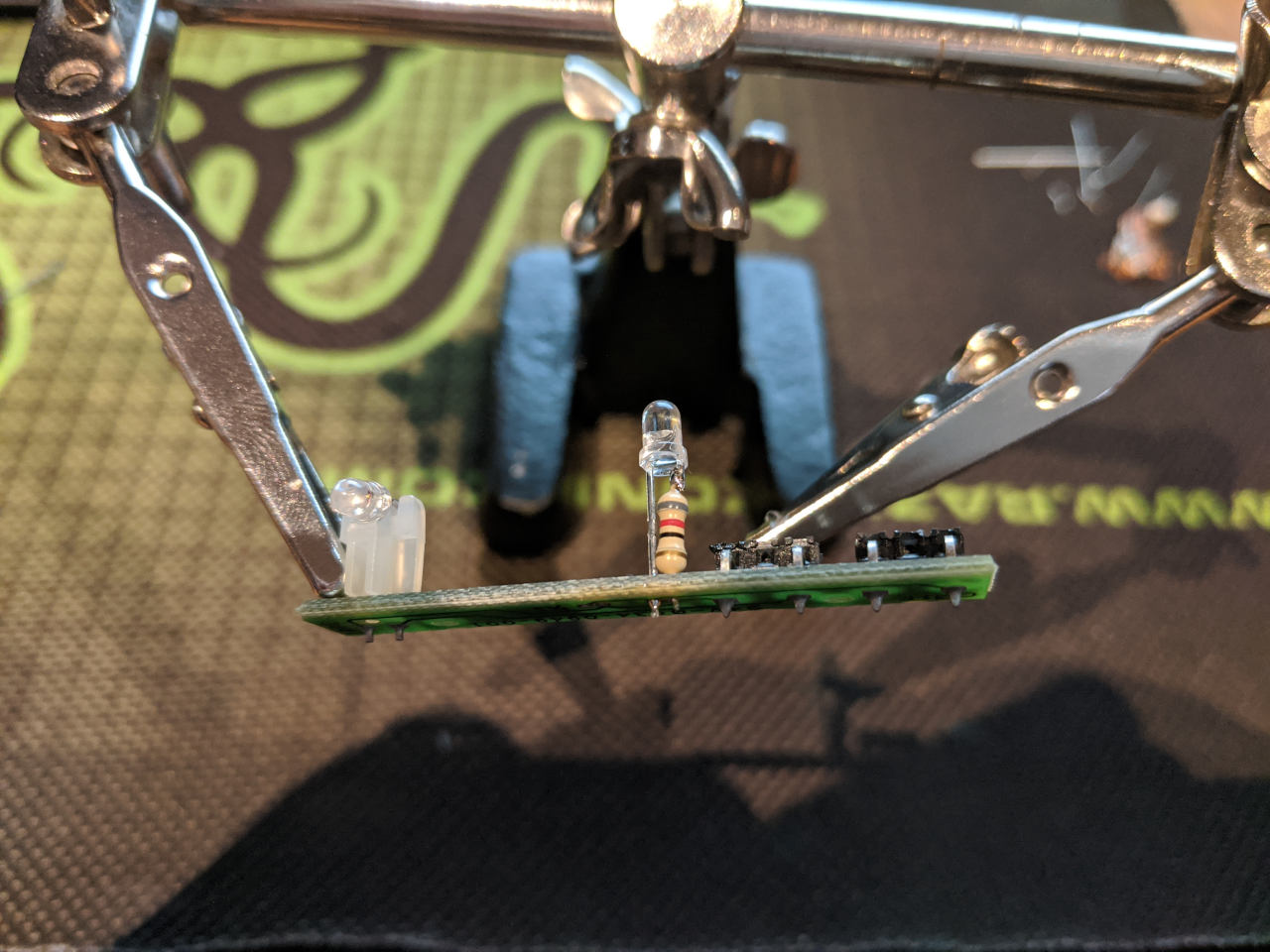

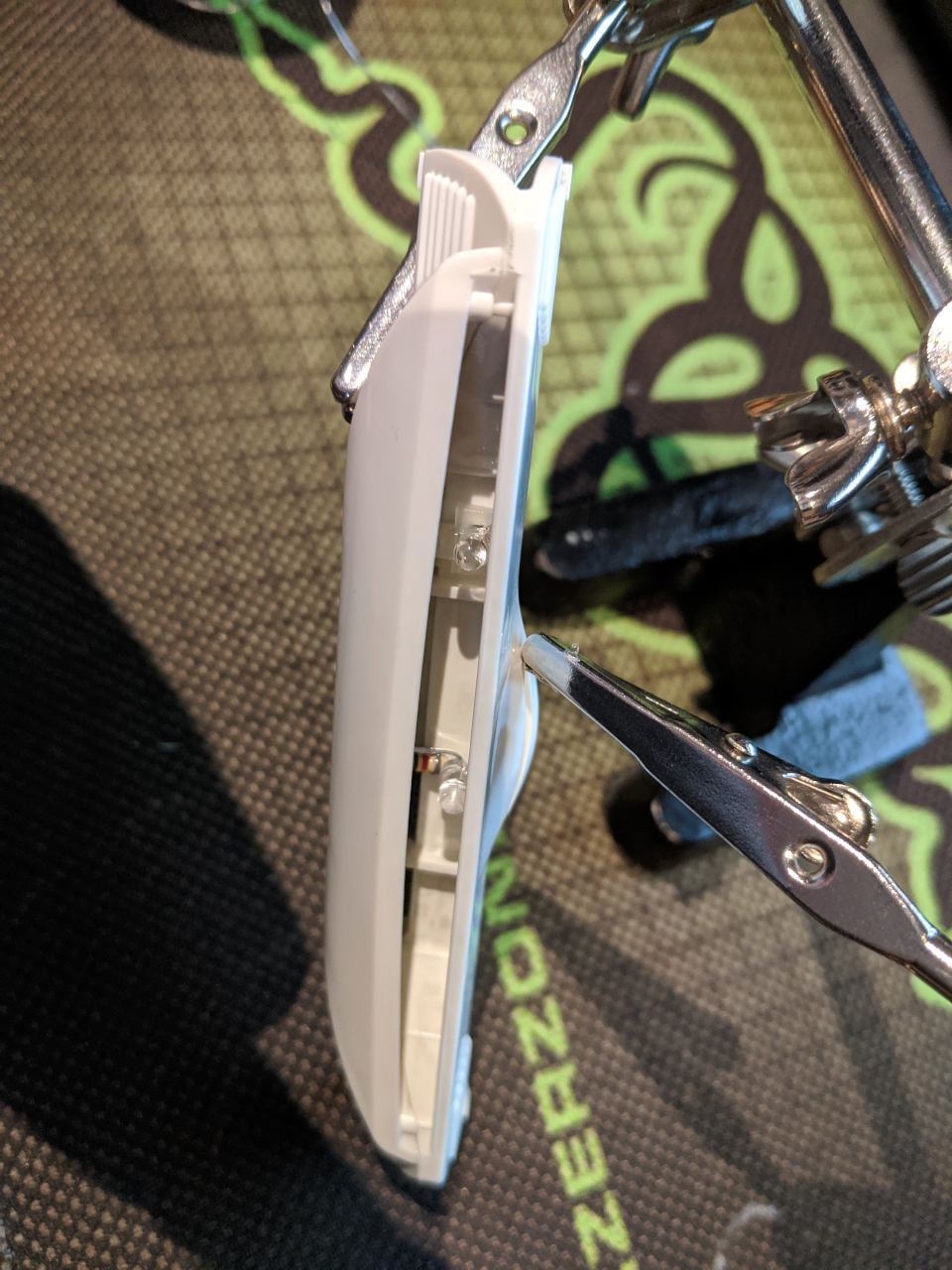

Most LEDs are 3v which is the reason for the resistor. I just completed this mod on my octane, here are some photos:

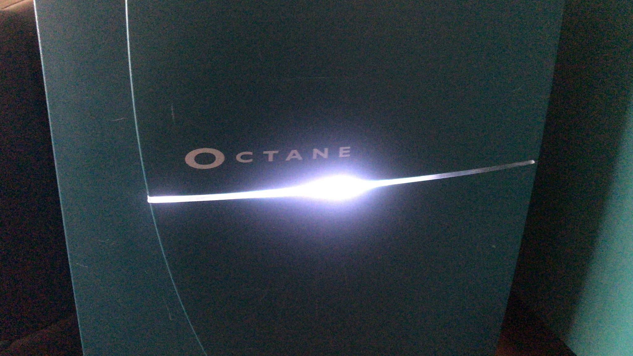

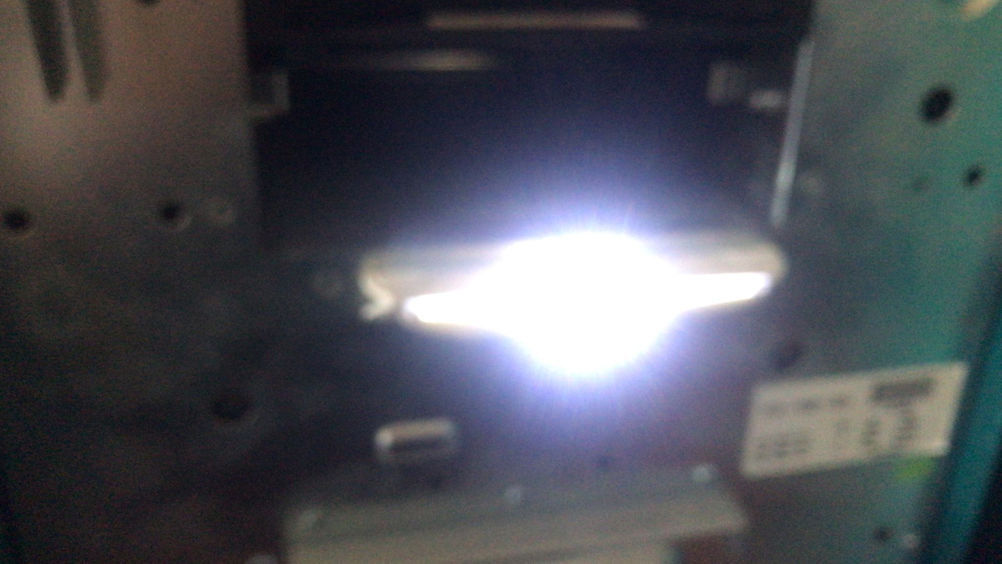

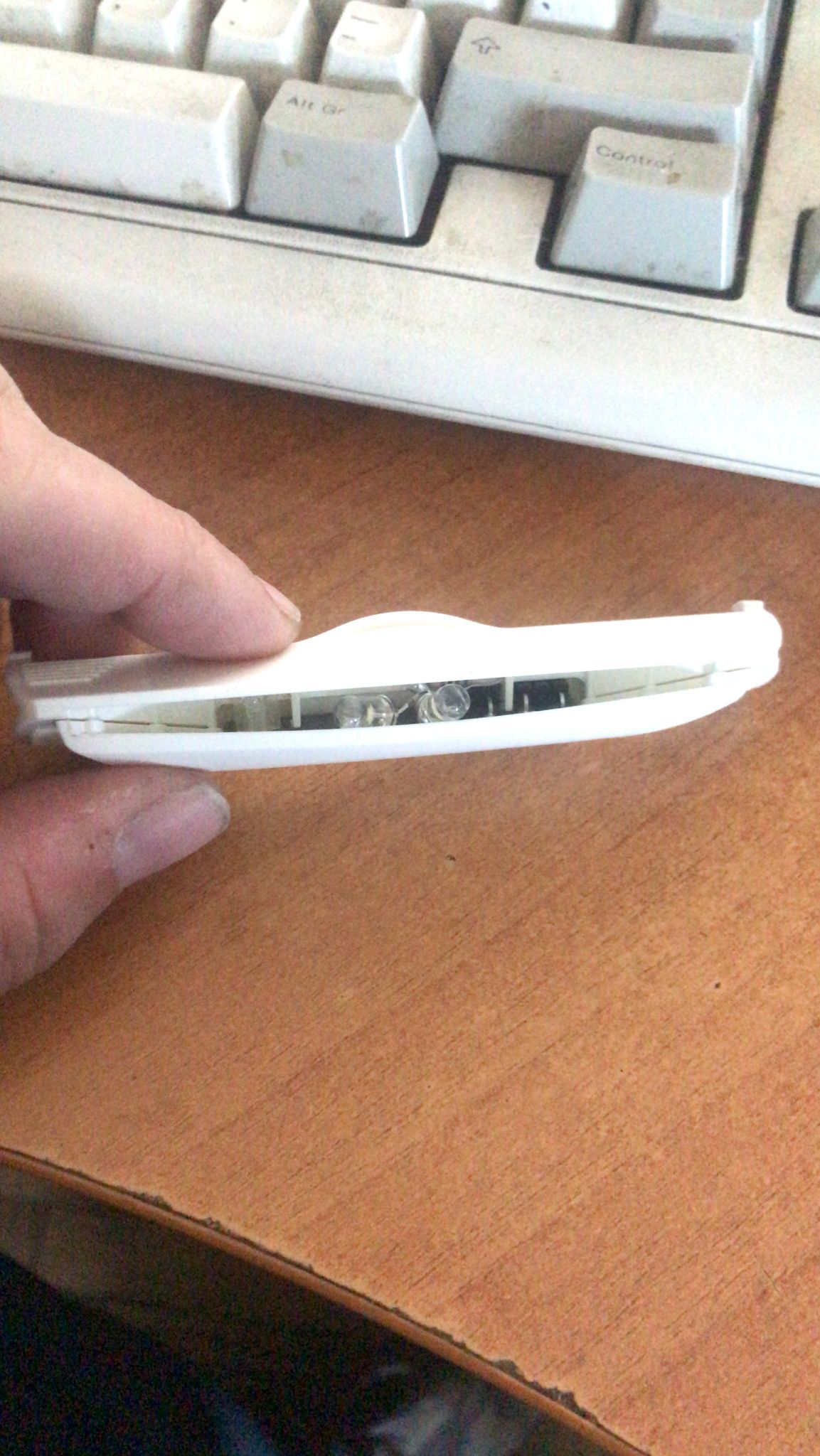

Ended up using white leds.
Took me a while to get to do it but sure it glows Biggrin.
