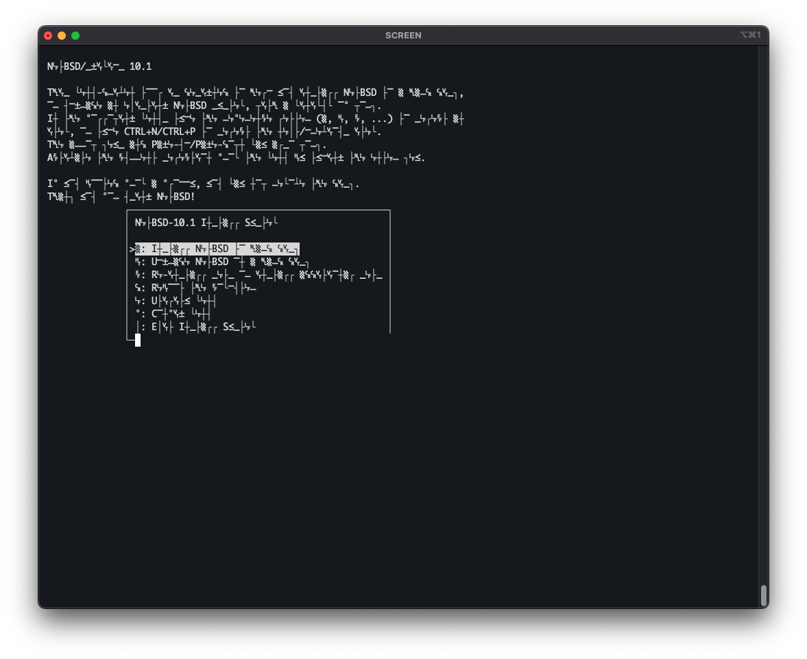

I just tried something I hadn't tried before, using the BlueSCSI as both the hard drive and CDROM drive. I put the NetBSD image on there as a CD, and it actually booted. However, the installer screen is all garbled and just redraws over and over. I've attached an image, it's very odd!
