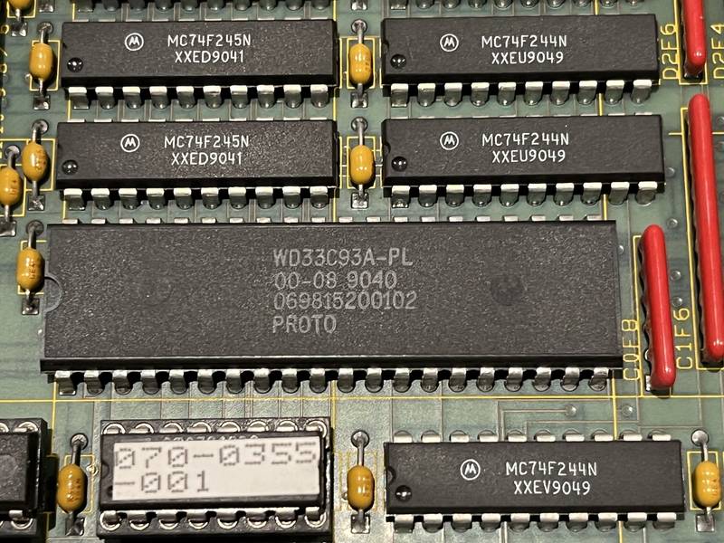

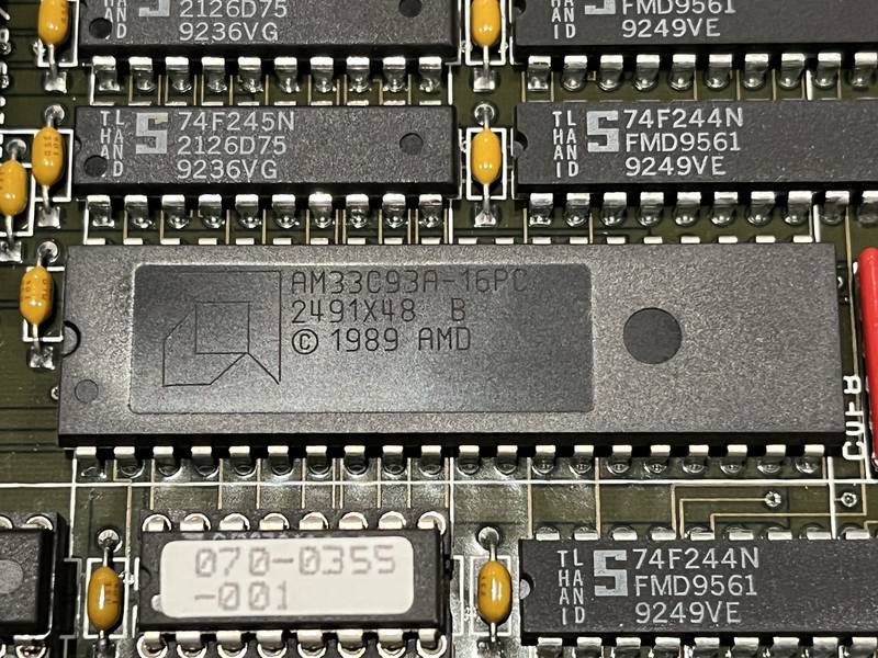

Yes, the gold-standard would have been to check the IO3B-board with an MSO for possible failures. But I only have a DSO at hand, and to 'logic-analyze' the board I'm lacking the proper training.

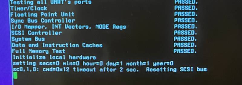

So there were 3 things that led me to believe the SCSI-controller-chip(s) were damaged:
1. CB_HK had problems with one of his SCSI channels some time ago:  WTB: Spare Crimson IO3B (FOUND)
2. During boot Crimson gave me persistent SCSI Controller Reset errors (wd93-errors, see 1st post)[url=https://techpubs.jurassic.nl/manuals/0630/admin/IA_ConfigOps/sgi_html/apb.html][/url]
3. The Amiga 3000 uses a AM33C93A-16PC chip as well; in the Amiga-hobbyist-scene this is known to fail very often
