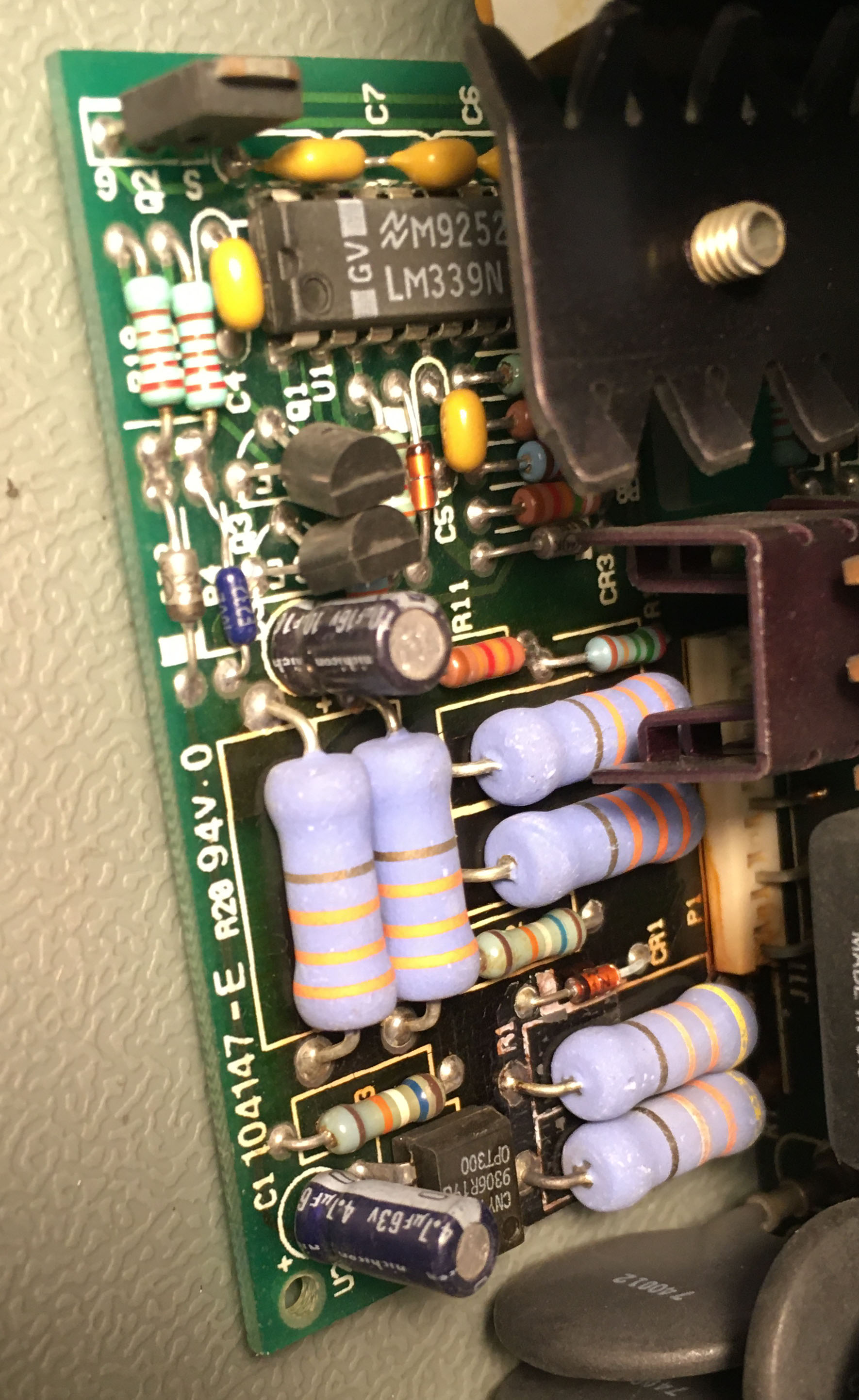

I guess you mean the circuit breaker on the PS3 status panel PCB?
[Image: crimson_ps3.jpg]
The Crimson Field Service Handbook refers to it as the over temperature breaker. On the back side of the system, above the backplane, there's a small PCB with a blue cooling fin on it. It's attached to a temperature sensor located above the card cage. I had that circuit go bad in a 4D PowerSeries years ago and it tripped the breaker. I guess it's supposed to save you system if too many fans in the card cage fail, but I wouldn't count on it.
There's a bunch of voltage status LEDs and test points on the PS3, but if they trip the breaker then at least the terminology in the Field Service Handbook is off. It might light the fault LED. I don't have the pinout for the flatcable so I can't test PS3 functionality outside the system, and I'm not going to subject my Crimson to voltages far enough out of spec hoping to trigger it and see what happens...

Yes, the PS3-board (status panel assy, I forgot the name).
Crimson's "power delivery circuitry" only works correctly with boards installed inside the cardcage: The ciruit braker also tripped while I tested the PSU with all boards removed (didn't want to fry them on the test run, because there is no such documented try on using an LH-PSU in Crimson).
Without cards installed, the PSU only sends 8 Volts instead of 12. I think that this extremely low voltage failed the temperature sensor, which needs power itself. This, and/or that was also the case:
Thermal circuit braker - Trips when the system air temperature exceeds 140 °F (60 °C) [...] The breaker will also trip if the system senses a DC voltage that is 40% out of range. --Field Service Handbook p2 - 11
I asked myself what this PCB on the back does, now I know that it is the temperature control unit. :-)  (I checked all fans recently, I won't let this machine ever run unattended)
(02-21-2022, 09:15 AM)Jan-Jaap Wrote:  There's a bunch of voltage status LEDs and test points on the PS3, but if they trip the breaker then at least the terminology in the Field Service Handbook is off. It might light the fault LED.
Yes, I used all these test points to check the voltage. And the fault light on the corresponding LED ("-12V UVP) and the "fault LED yellow" lit, when I undervolted the system.
