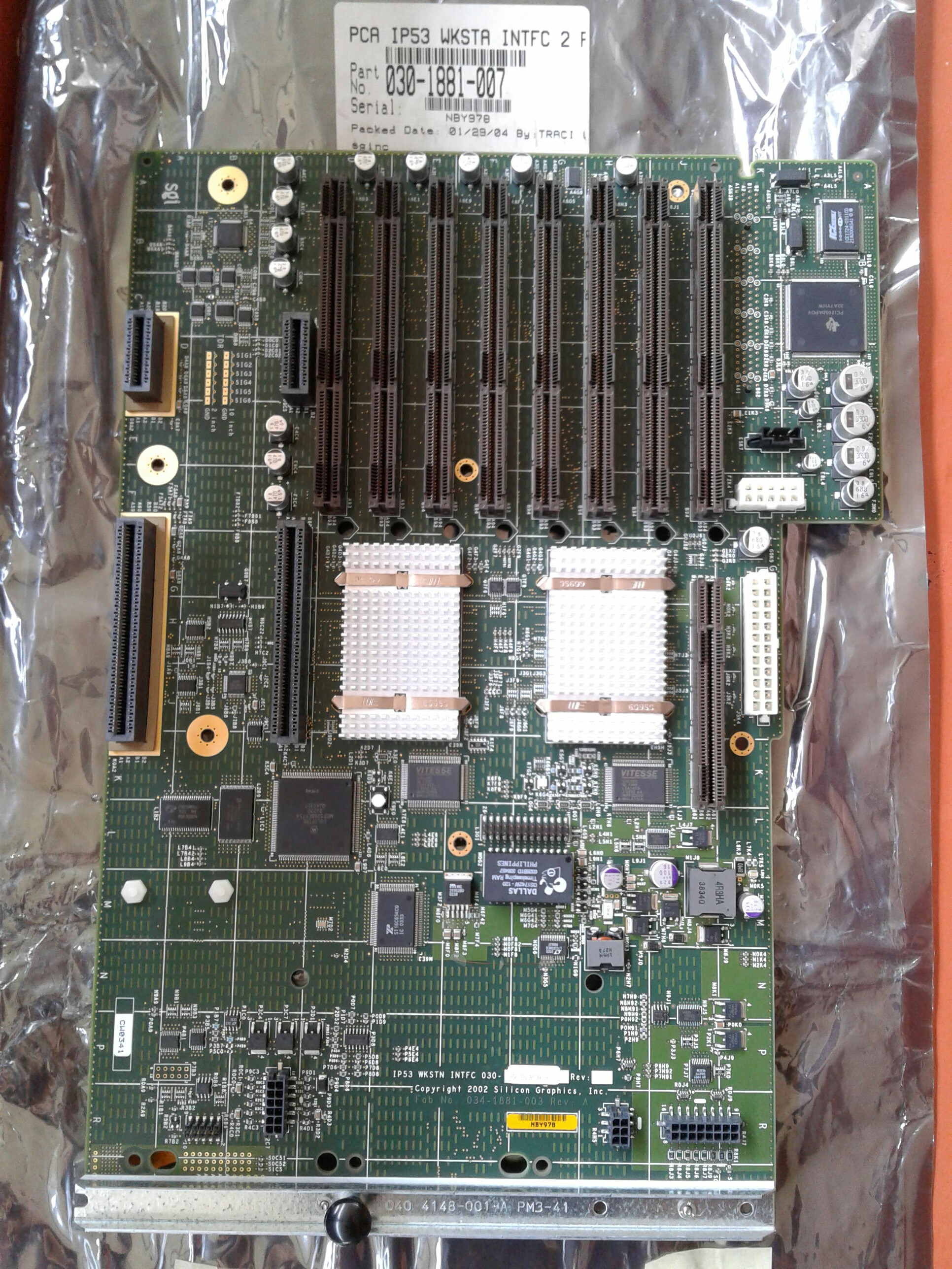

(10-22-2020, 01:47 AM)weblacky Wrote:  For newer...I thought it was buried inside a co-processor on like the L1 processor itself?  We've never heard from anyone that proved where the firmware lives.
All of the SGIs I've looked at have mostly used off the shelf components, with the custom silicon reserved for where it really matters eg., the processors, graphics and memory interconnect. Outside of those things rolling their own is just going to increase cost. Even in things produced in large volumes with security requirements the flash chips still aren't usually integrated into the processors.
On the Tezro, for instance, looking at photos of the (I think) nodeboard (in this thread) there's a what looks to be a Coldfire MCF5206 (m68k-ish) microprocessor (next to two chips that look like memory. I would posit that is this is the L1, and that one of those chips is RAM and the other flash ROM. They look like standard chips (one looks like it's made by Cypress and the other maybe TI) but unfortunately I cannot read the part numbers.
