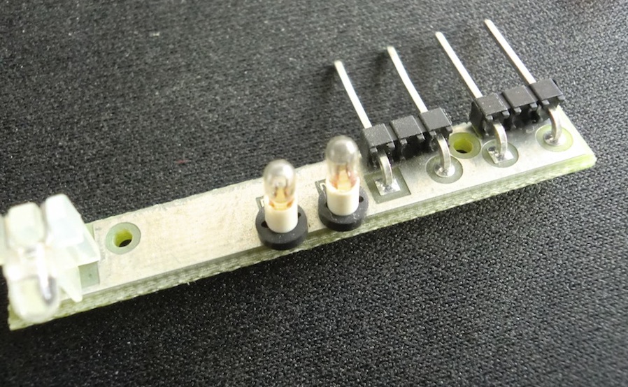

Oddly, I think I found them.  Without taking them out to verify dimensions these are actually standard bulbs (Assuming 5V, because people use 5V LEDs for the mods): Miniature Bulb G3.17 Base - 5 Volt
Picture from: Reviving Octane Light Bar.
Possibly:
https://www.bulbtown.com/7362_Miniature_...p/7362.htm
https://www.amazon.com/Miniature-Incande...B07B1C8HZC
I'll have to desolder the old ones, but they are a 2-pin bulb...still made..actually a standard, this only took me 20 minutes to find...why is it I never found this info on Nekochan or the like?  Odd, really.
So, there's the answer!  Good thing I need three sets (6 bulbs), because they are so cheap that shipping would hurt.

10-06-2020, 05:14 PM
RE: What's the replacement part number for the Octane lightbar incandescent bulbs?
Bulb Height (top of bulb to bottom of base, no spacer, measured off board): ~7.35mm
Bulb Base Diameter (white section): ~2.5mm
Bulb Glass Diameter: ~2.32mm
Bulb Pin Diameter: ~0.50mm
Bulb Pin Spacing (outer edge to outer edge): ~1.70mm
Bulb Pin Gap (inner edge to inner edge): ~0.7mm
Board Pin Spacing (outer edge to outer edge): ~1.94mm
Bulb Height (top of bulb to board including spacer): ~8.55mm
Measured with Mitutoyo Calipers
So those G3.17 bulbs are too big

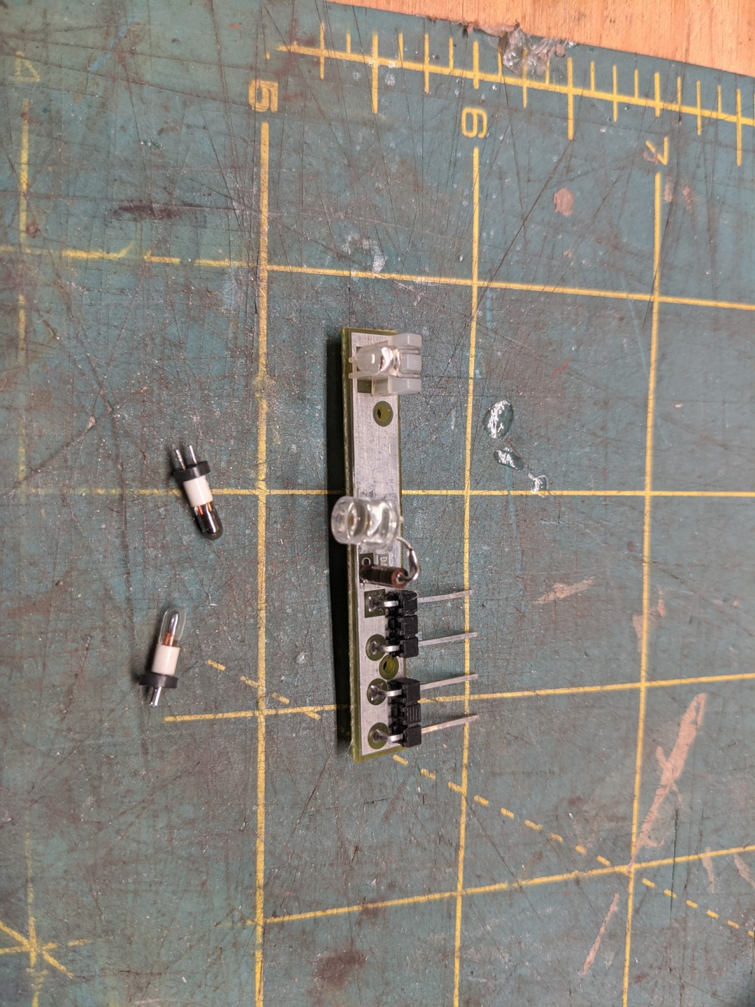

10-07-2020, 11:20 PM
I did more work on this today. I took a light bar, desoldered one of the bulbs and took both to our bulb supplier. They also only came up with the same bulb I did (of course I mentioned this). I left a bulb with them because the customer agent said he’d call around and try to find a bulb that actually matched those measurements out of their suppliers.
He did say that the base standard was correct but that when they are this small, they don’t follow a standard if they are under a 7714.
So, I mentioned to him I understand if there is a minimum order. I’d hope even 100 bulbs wouldn’t be much money.
They’ll likely call me within 5 days to follow-up.
Fingers crossed they find something, but yeah, the 7714 could fit on the PCB but it’s be very close to the power pins and the rubber guard would have to be discarded, I didn’t bring the white enclosure, but I do think it would fit.
