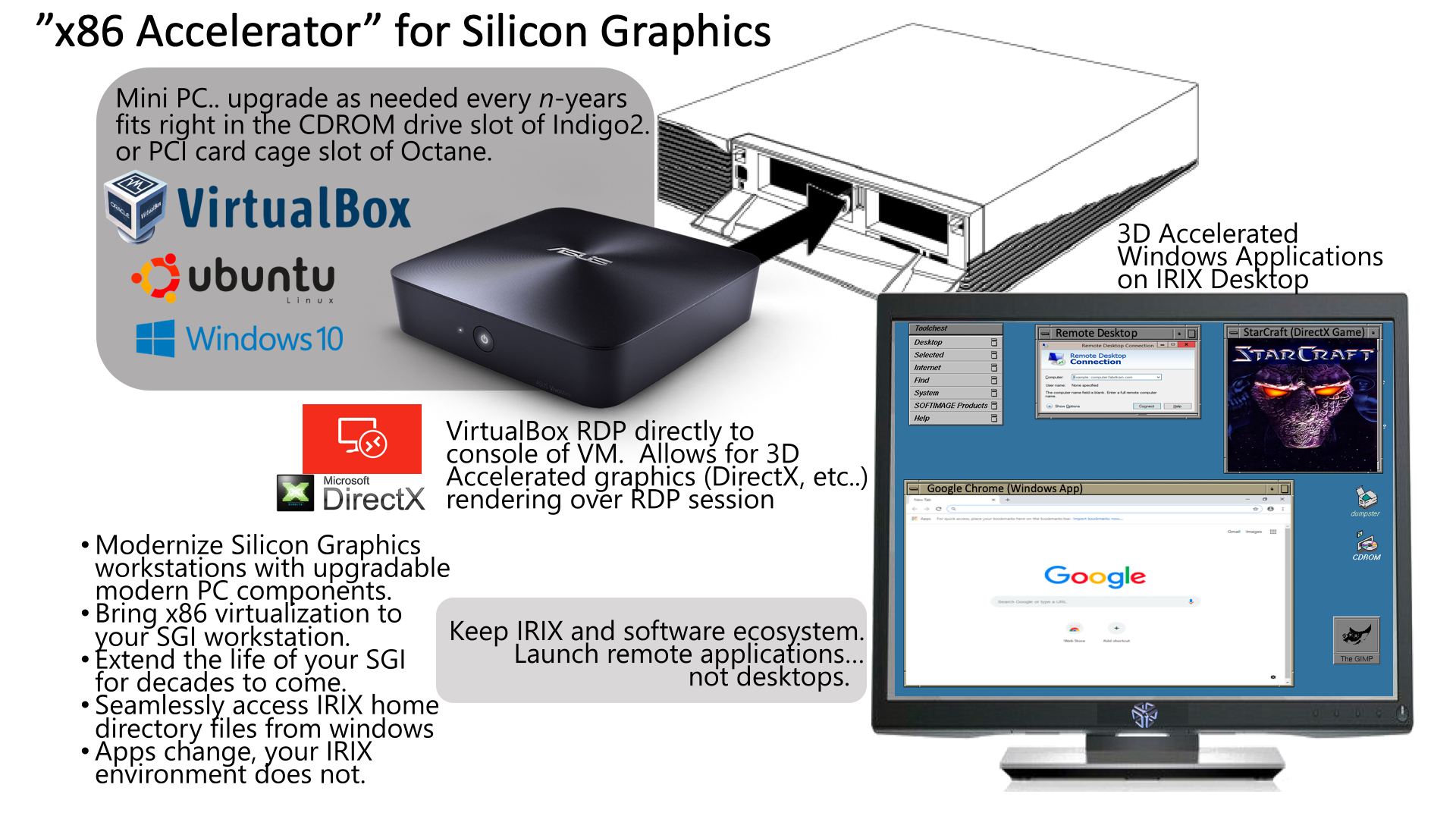

I still stuff an ASUS UN62 mini-PC (i5 CPU and 16GB RAM) stuffed in the Octane's PCI cage space.  Fits perfectly.. in fact you could put 2 units in there and get a cluster/VM farm going.  Any other type of smaller device on the market seems to run slow for web browsing and running multiple VMs at the same time.  With VirtualBox running on it, you can rdesktop into a VM's console (VirtualBox runs the RDP server) and have full 3D accel avail to you remotely to run some games, or other apps that need 3D.  DirectX games work over rdesktop this way where they would not if you rdesktop to the Windows VM itself.  At least this way you can run various Windows software... MS office, etc... or even MacOSX all viewed from the same IRIX desktop supporting cut/paste between them all.
Even on a Modern Mac.. I still run many VMs..  so on SGI hardware.. its the same thing but with hardware assist from a mini-PC.
