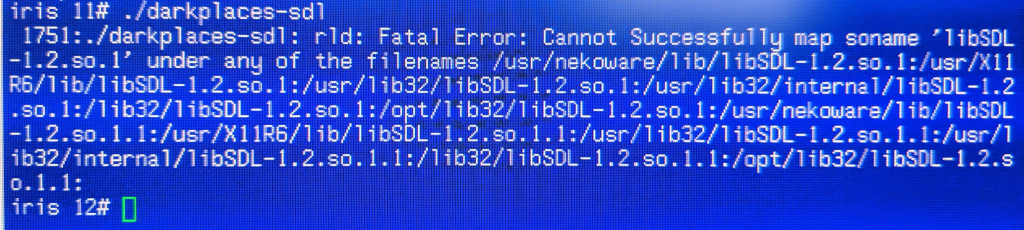

(05-24-2019, 08:19 PM)Irinikus Wrote:  Is it neko_quake you've installed?
If you've installed neko_quake, look in the nekoware bin folder for the following file: "darkpalces-sdl", and copy it into the quake folder. This is the correct executable for the game and will allow you to run the game at 1920x1080 in GL-mode.
Yes neko_quake - I followed your instructions exactly but the same result. I have a feeling that I might be missing SDL dependencies? I know many programs I try to install cry and ask me to install lots of SDL programs.

confirm you installed it properly? It's funny that it didn't call for libSDL when you did the install?
You're going to need to install "neko_libSDL-1.2.so.1.1" it's available in nekoware.

I'm getting there lol! Maybe one more hurdle? I load the game, the screen goes blank but stays in 1920x1200, the game is playing in the background but no display. I bring down the quake console from memory and type /quit. My desktop comes back, and this is the terminal output:
Any ideas? It seems it cannot find a 640x480 output in opengl or something...

Try typing in ./darkplaces-sdl -width 1280 -height 1024
If it still doesn't work, try installing neko_quake3, as this should require you to install the correct dependencies when you install it.

Update: Guys I managed to get the bog-standard version of Quake 2 to run - I'm happy with that! I just wanted to make sure the graphics card was working Smile I'll leave the other Quakes on the 'back burner' for now and just go ahead with other apps I want installed.
So far I'm rocking 1920x1200 and it's awesome, with my custom background as well thanks to all the help.
