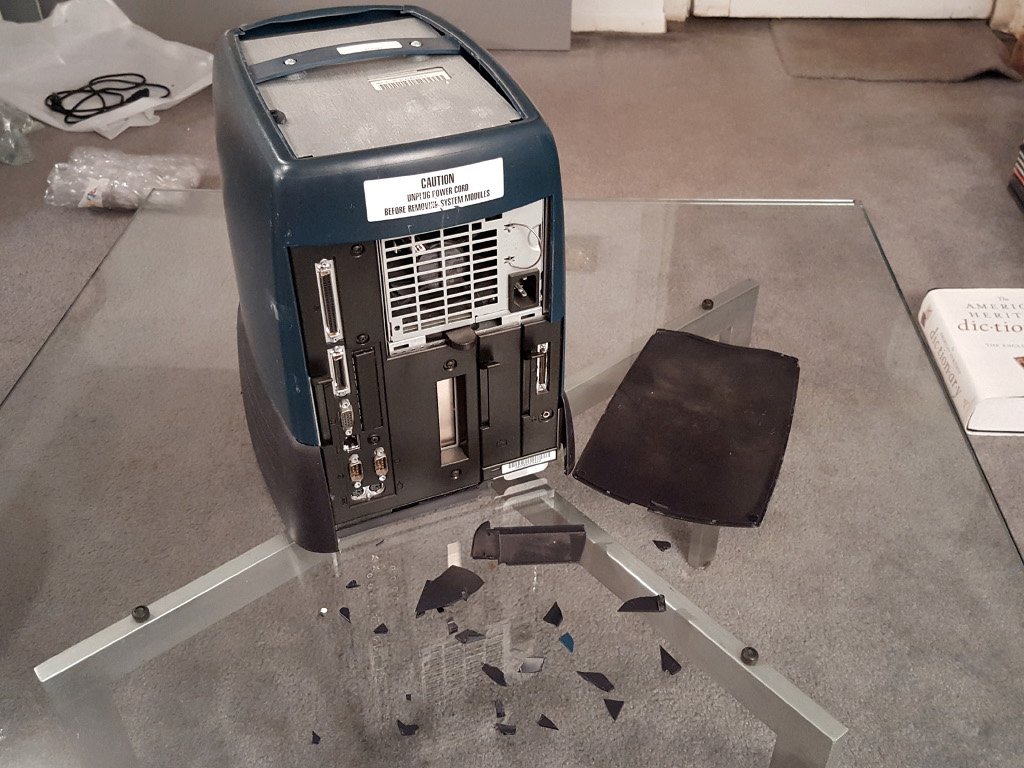

Stellar repair work! What is the tape you have inside? With the criss cross fabric? That would have been quite useful when I put mine back together.

(10-19-2018, 09:02 PM)Intuition Wrote:  Stellar repair work! What is the tape you have inside? With the criss cross fabric? That would have been quite useful when I put mine back together.
Thanks!
That is nylon mesh or netting, it is commonly used as an insect barrier, but it has many other uses. You buy it in sheets or rolls and cut it to the desired shape. If you use an epoxy type adhesive on top of it, it sets really strong and bonds together with the plastic. It also serves as scaffolding to create some sort of surface upon which to rest the pieces, giving shape, etc. Really useful stuff.

Finished repairing the cover earlier today, the putty worked wonders. It is not the exact same finish, but it does the job. The rear part of the computer took the blunt of the damage so the finish is somewhat poor (pictures do not properly show this due to poor lighting conditions). The biggest issue is however the brittleness of the plastic in the rear/bottom plate. It is shockingly fragile to the point where small pieces are still falling simply by handling the computer around.
Lost operation to the CD-ROM eject button but I will manage through IRIX, no other way around it I am afraid. The original CD reader was also damaged so I replaced it with an SD-M1401 DVD reader, so far it has allowed me to install IRIX just fine. Not an exact replacement in my case, adjustments were necessary to the cover, among other places. I also have a PSU cover in the mail to finish the cosmetics.
