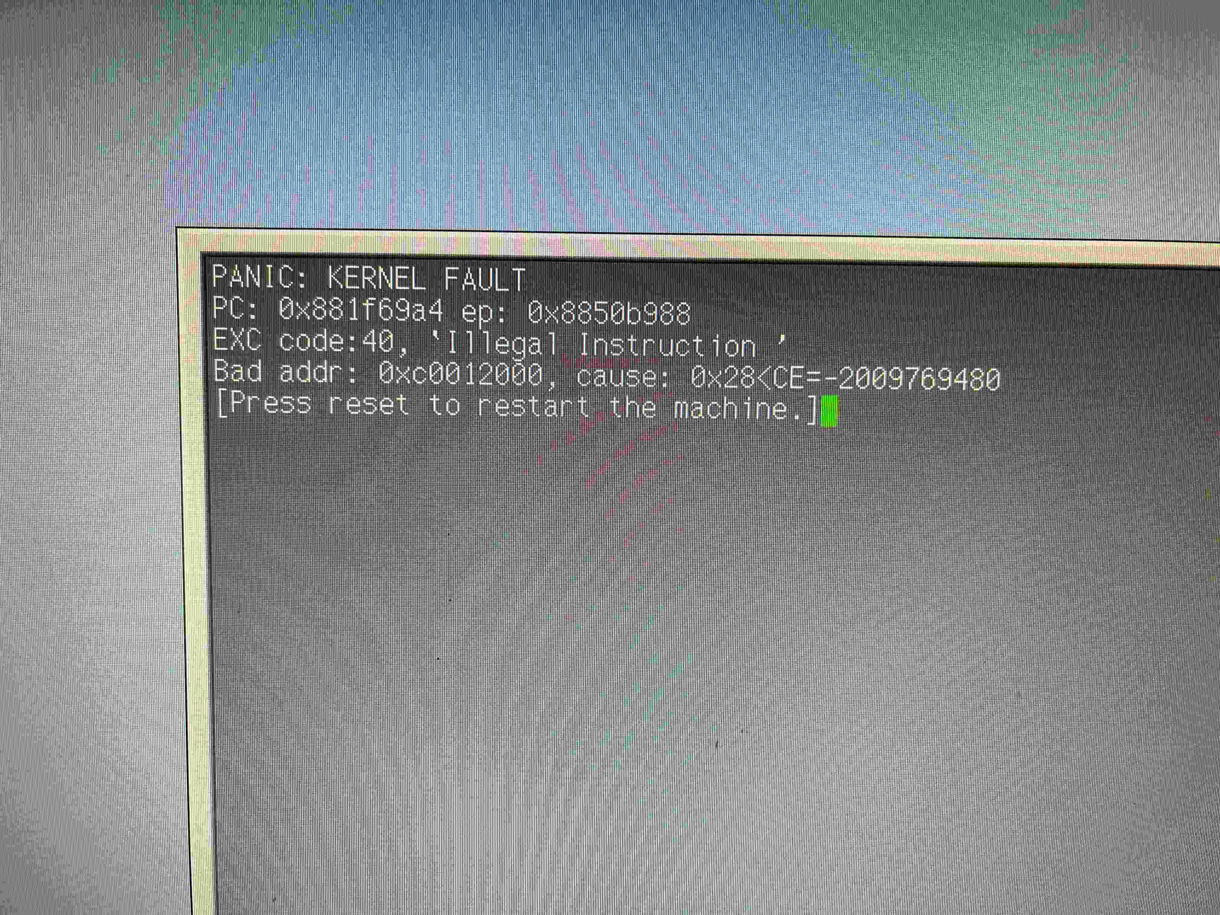

I received an Indy R5K for basically nothing, it works though it came without a hard drive. So I bought a 18.2GB Ultra320 SCSI drive, along with a SCA to 50 pin SCSI adapter, and a Raspberry PI 4. Though the problems came when I tried to install IRIX 6.5.22. I am using Reanimator on my PI 4. FX works just fine and partitions the drive, though I cannot get into the installer, when I try to install from the network it loads the miniroot up to 100%, the IRIX text shows up in the bottom right corner of the screen, not long after it just kernel panics.

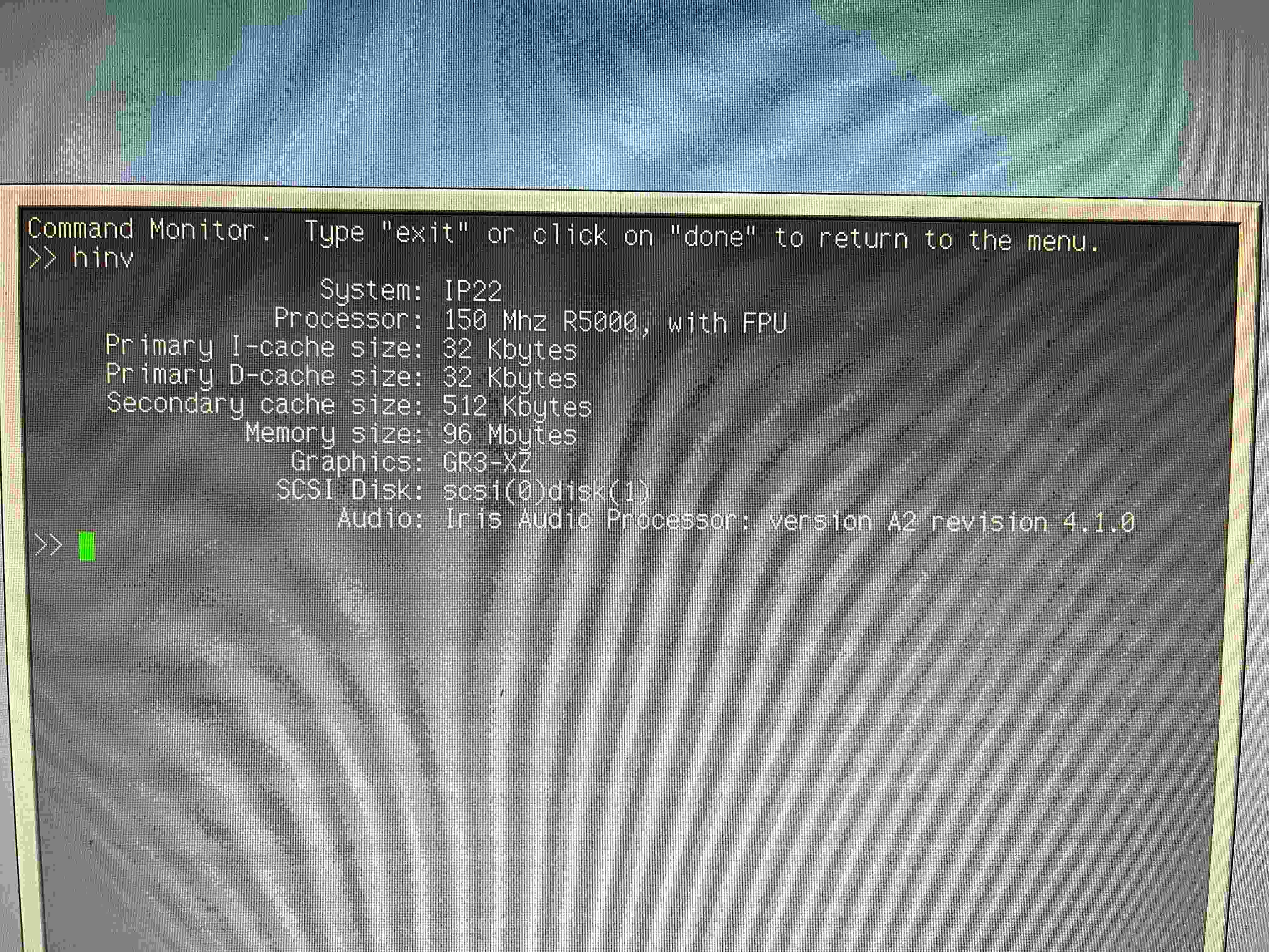

My first thought was "there is probably a memory issue", though after swapping around and reseating all the memory as well as the CPU card, same issue. And after running the IDE all the tests passed just fine. also did resetenv and tried the "_R5000_CVT_WAR" variable, all of which had no effect.
This is my first SGI machine, and now I am pretty much stuck, as I cant really find anyone online with my same issue, I have seen similar, but nobody with the same "Illegal instruction" error.

Sadly I dont have access to any SCSI CD drives or anything, but I did try 6.2 and 5.3. 5.3 seems to just hang, though I feel like its because the version included with reanimator is not the version with R5K support. But 6.2 is interesting, as installing normally just results in a kernel fault, though if I wipe and repartition and relabel the drive and run miniroot directly, it will actually get past where it usually crashes, but with the error "Kernname environment variable not set by sash" and "initial mount of root device 0x2000011 failed with errno 22"

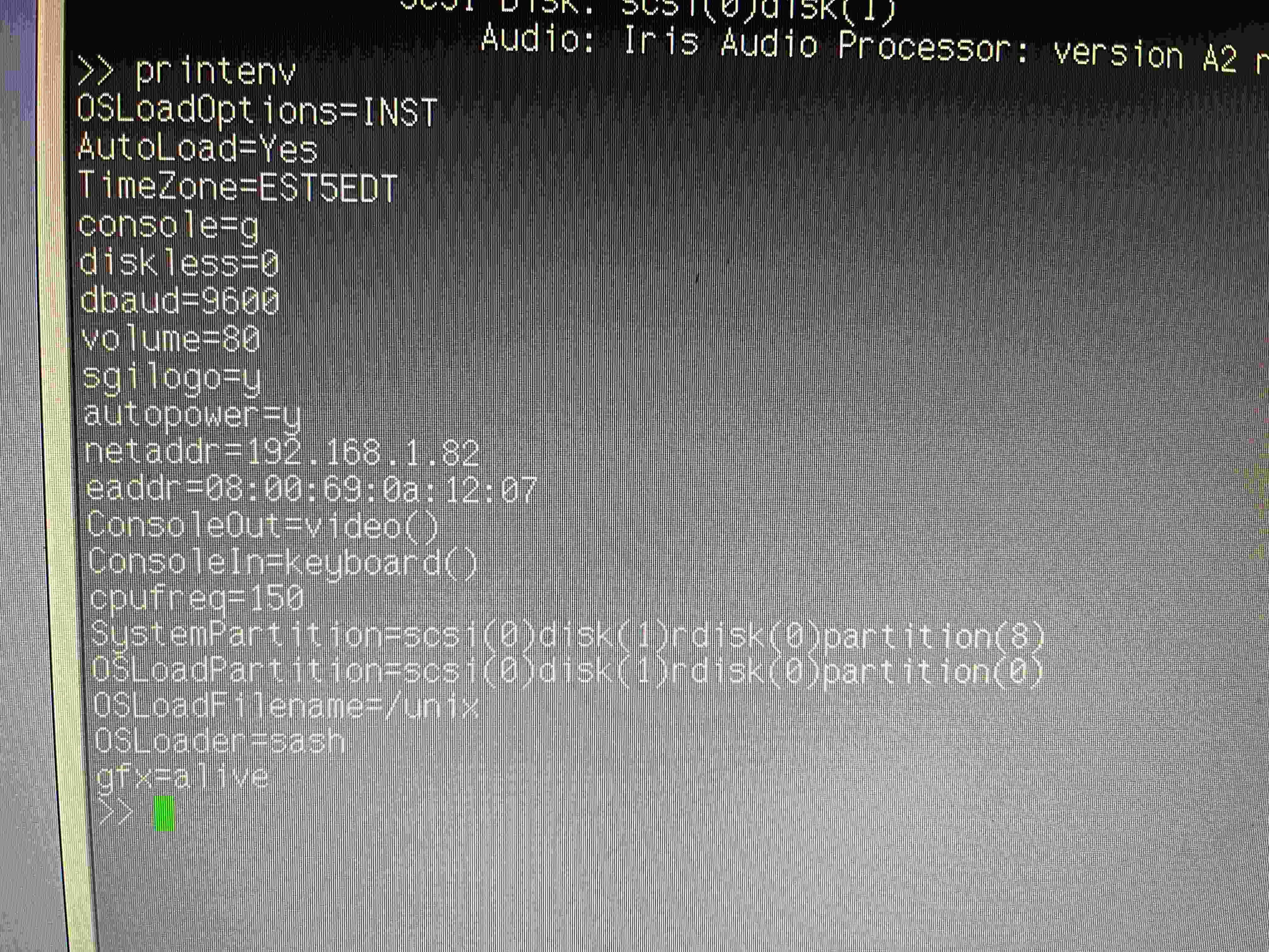

Can you please go into the PROM terminal and type: version
Report what comes out. Maybe you have an old PROM that's incorrect for your processor version (a incorrectly done upgrade?).

Version 5.3 B10 Feb 12 1996

(11-24-2024, 03:12 AM)Avante3000 Wrote:  Version 5.3 B10 Feb 12 1996
That is the correct ROM for your processor:
070-9101-011
SGI Version 5.3 Rev B10 R4X00/R5000 IP24 Feb 12, 1996 (BE) R5000
So that's not the problem.
