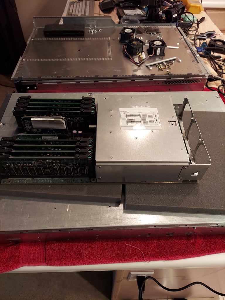

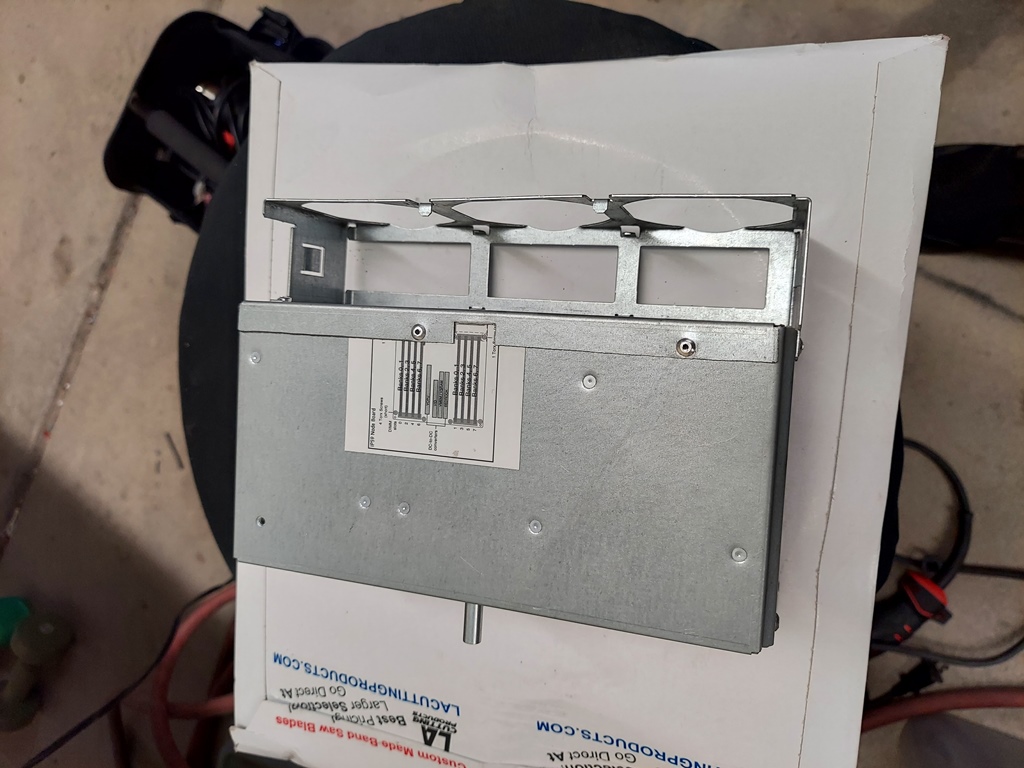

IP before mods.
IP with fan cage removed. You can see the unused space that allows us to move the IP fans back.

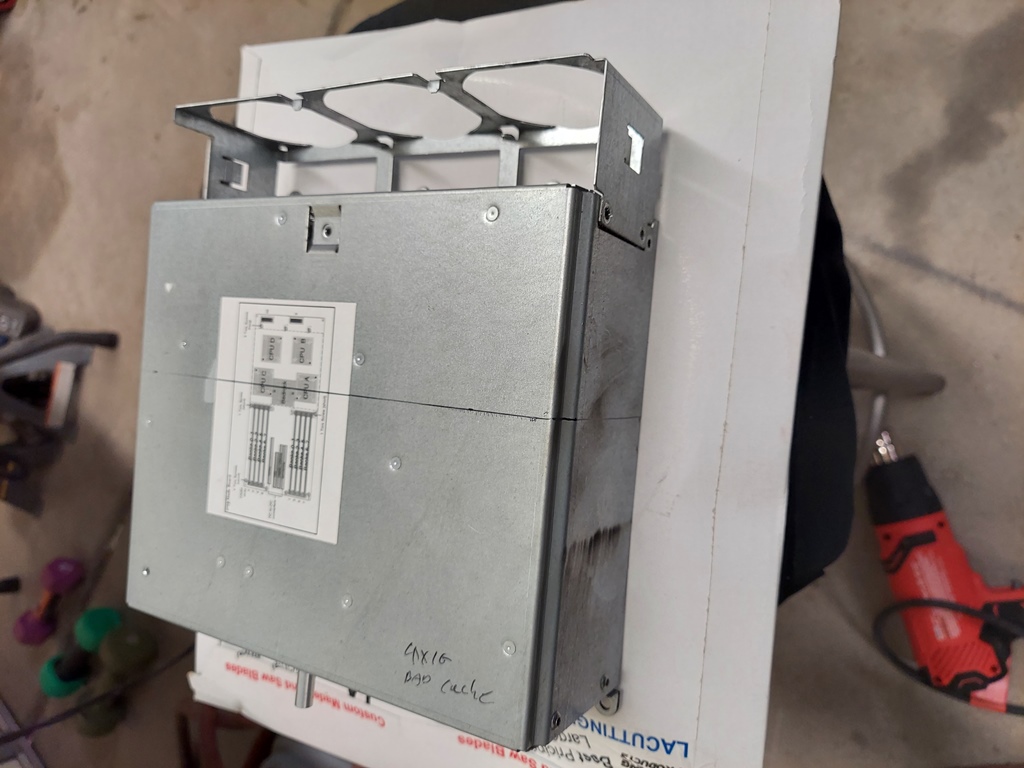

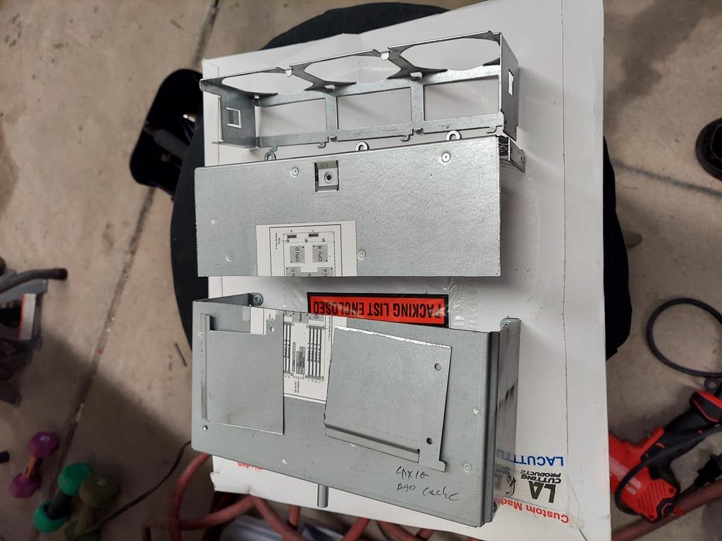

Cage before cutting. I am using an old 4x1ghz cage I had. The first cut is made 4 1/8" from the front.

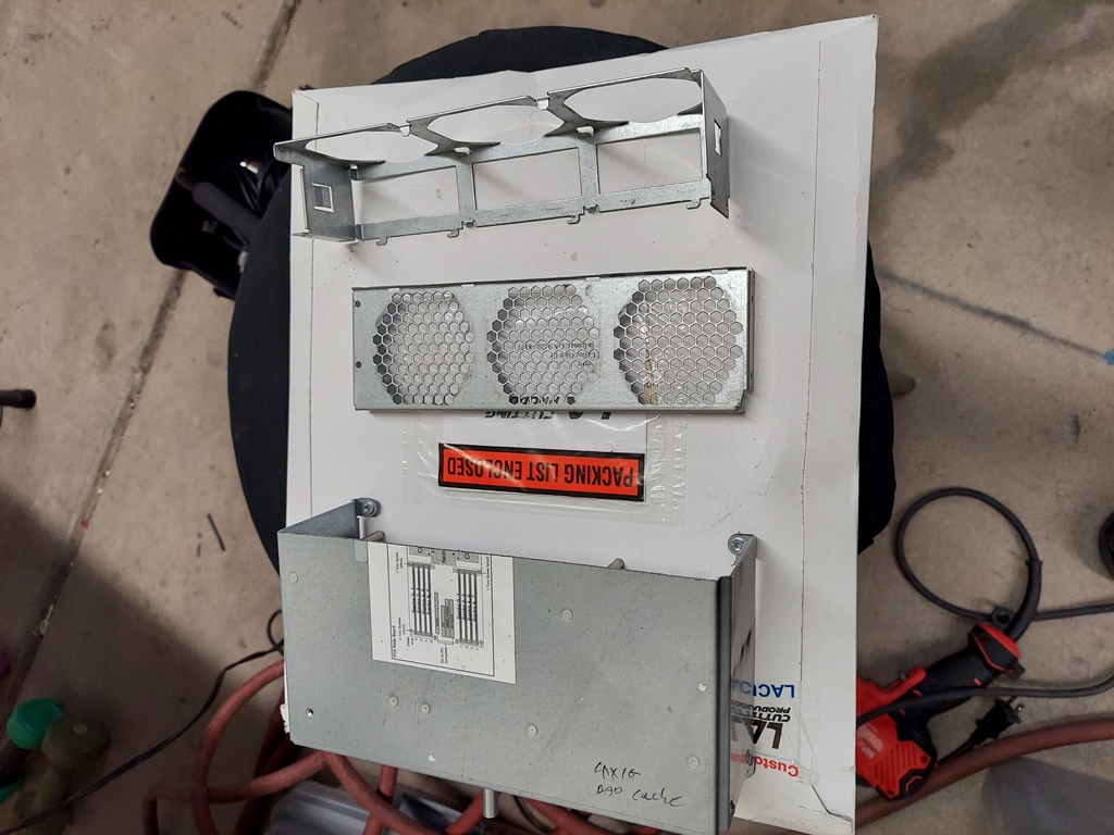

The next step is to drill out the rivets and to cut the sides from the outlet half.

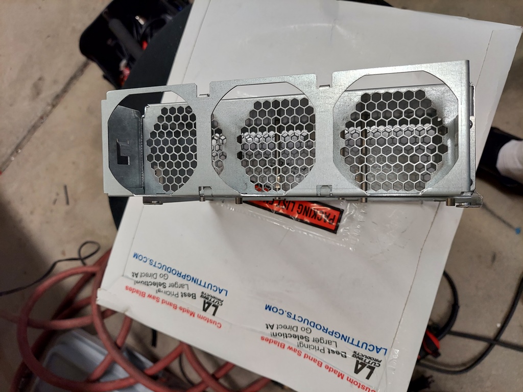

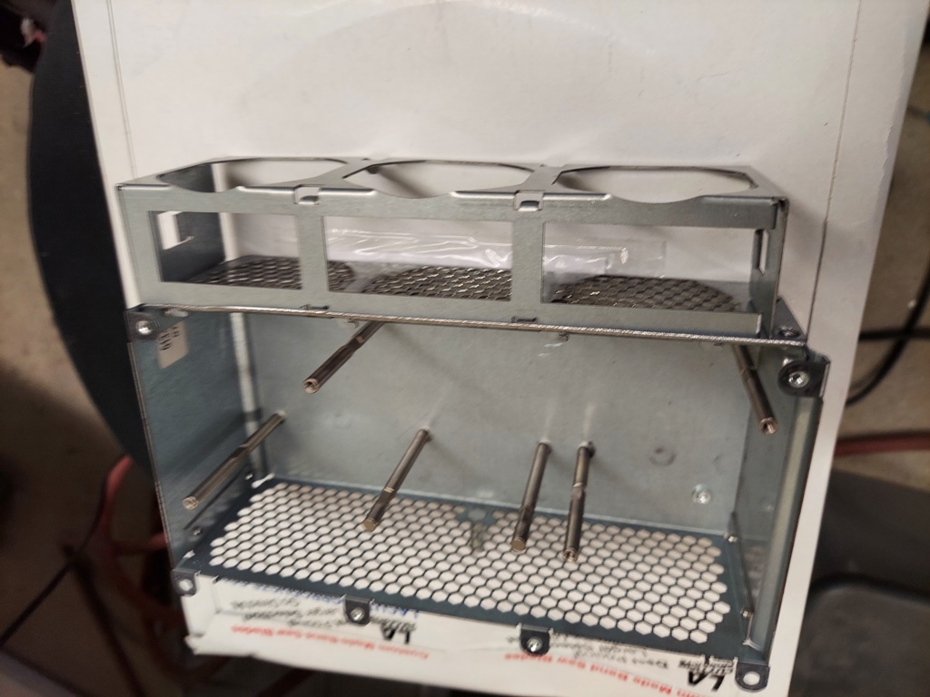

Now you have to trim the top down to 1/2" to use it as a mounting flange to reassemble the cage. You have to trim off the bottom of the fan opening to make clearance from the PCB. Remember to leave the little slots for the fan cage to go back on. On reassembly you will put a thin strip of foam to seal the fan cage to the PCB.

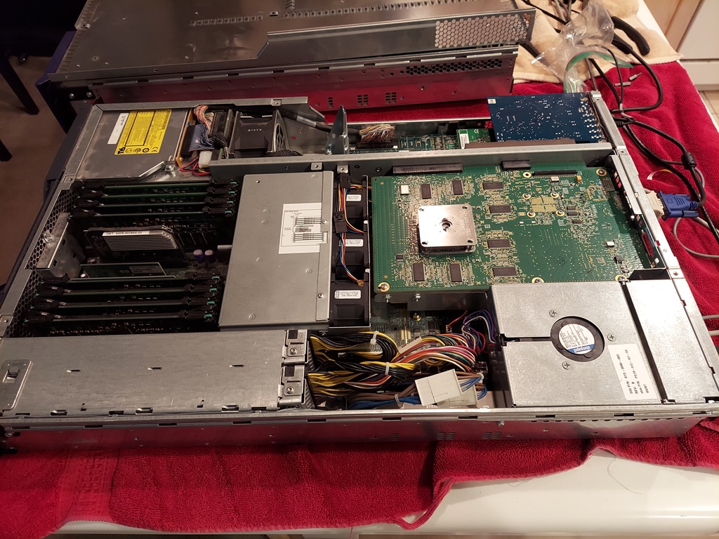

You can now reassemble the cage by slipping the outlet part over top of the main cage. Now you use the existing holes as guides to drill for the rivets. You now pop rivet everything back together.

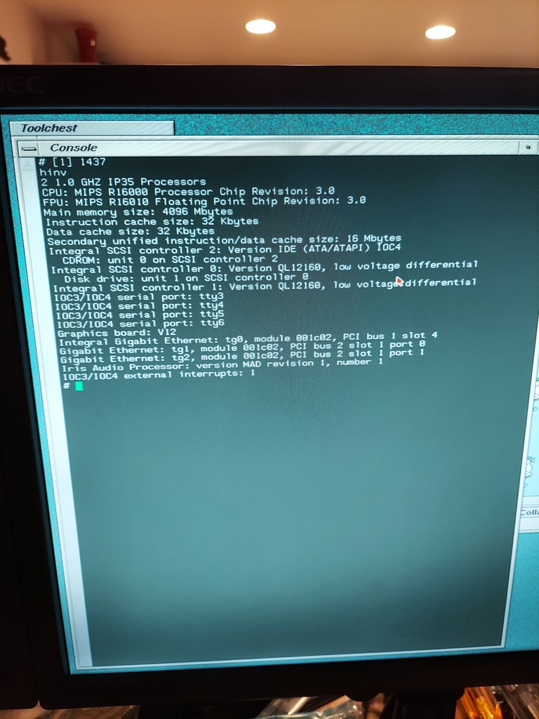

Finished assembly with the V12 installed. The V12 only needs the sheet metal mods as the heatsink fits as is.
