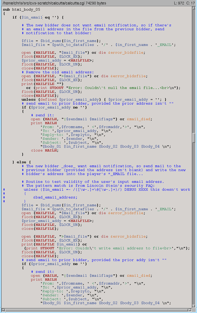

For what it's worth, I wrote an online Calcutta wagering system in Perl a few years back, that used SMTP to notify bettors when their wager had been outbid. It worked seamlessly and isn't very complicated, if you think you could make use of it it's entirely yours, public domain, to use in any way you see fit... 😜
Hmm, that said here's a screenshot of the first bit of the sendmail subroutine, it looks a bit more complicated than I remember. 🤪

Your code does not appear to be using any authentication. That's the fundamental difference between old fashioned CGI and PHP and new stuff; you can't rely on built-in MTAs because even if you have everything right according to the regulations Google will just silently dispatch it and others will mark it as spam or bounce It back because it's not authenticated.
Basically I use the PEAR mail class ( with a username and password ) or phpmailer to send via SMTP properly. It's like as if you're sending a message from Mozilla Thunderbird only it's a PHP script.
If you want an example I'm happy to share it but unfortunately the old way of doing things just doesn't cut it anymore. I worked 7+ years in various rhel system administration jobs and support jobs and it was always problematic to try to do it that way.
I'm not putting you down by any means it's just that the way things are run nowadays is so crazily different that it's difficult to apply that knowledge directly to this. There are those that will say that they can do it just fine, good for them. I have a rule anyways that I don't run mta's on local servers and a significant reason why is to prevent usage of hack scripts that use refer a friend or PHP mailers without authentication.

Since Internet gambling is technically illegal, I only ever used this program on my own server, which was running Sendmail. It worked perfectly well but I have no idea how it would work on anything other than Slackware, because that's the only distro I've ever used. To the best of my knowledge no intermediary servers between my Slackware machine and any of the end user's email servers ever bounced anything but I can certainly understand your reason for wishing to use authentication.

Yeah, I can demonstrate one day collaboratively, as I would love to educate and exchange information and notes with people of different backgrounds on computing topics outside of IRIX of how it works, but basically IME the big issue is that in email MIME headers, send mail/other cli MTA interfaces omit specific header info. This is also true when you call them from a CGI or Perl or PHP or whatever. Because you're not passing ae authentication header, basically. I'm sure everyone here is familiar with how email relay is used to work well most providers would reject your email if it was sent from an open relay and this operates on a similar purpose. Messages sent in this manner are more average likely to be a result of hacks, and Google, Yahoo etc don't care about RFC's because nobody's enforcing them. When you actually authenticate to an SMTP server, which is what say PEAR mail or say Net::SMTP can do, it adds a header indicating to the recipient that this message was provided to the server through authentication.
It's possible even in 2022 to get that working despite that but it's an economy of time issue, and in PHP when using an external class uses less code that is more legible it's hard to sit there and say that isn't worth it.
