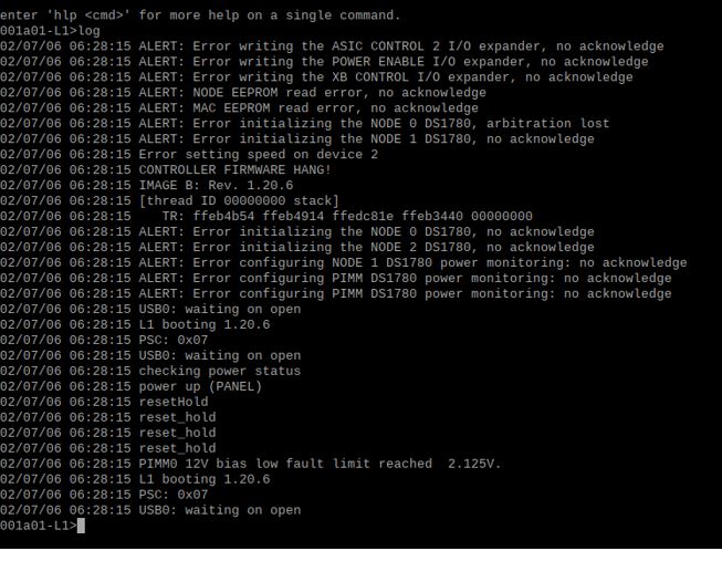

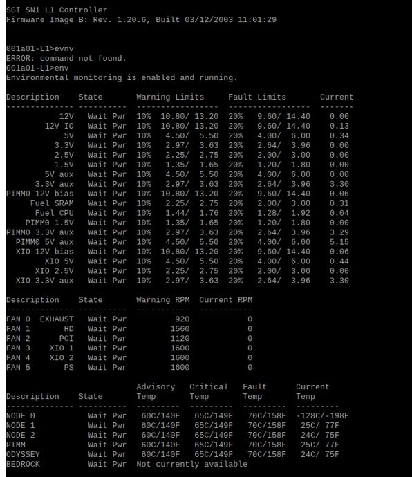

Several weeks ago, I decided to turn on my SGIs, to see if everything is OK with them. I am aware that someday they will not start anymore :-( . In my hardware check-up, I started with the older ones, and everything went OK until last week, when I tried the Fuel. It doesn't start anymore. Initially I thought that is a faulty power supply. Today, though, it was a rainy day in GTA and I had the time connect to L1. Attached are the L1 Print-Screens. Any suggestion?
Thanks.

I think your ENV monitoring chip has failed. That looks like how my Fuel behaved.
The power supply overtime goes out of regulation and takes out the env chips.

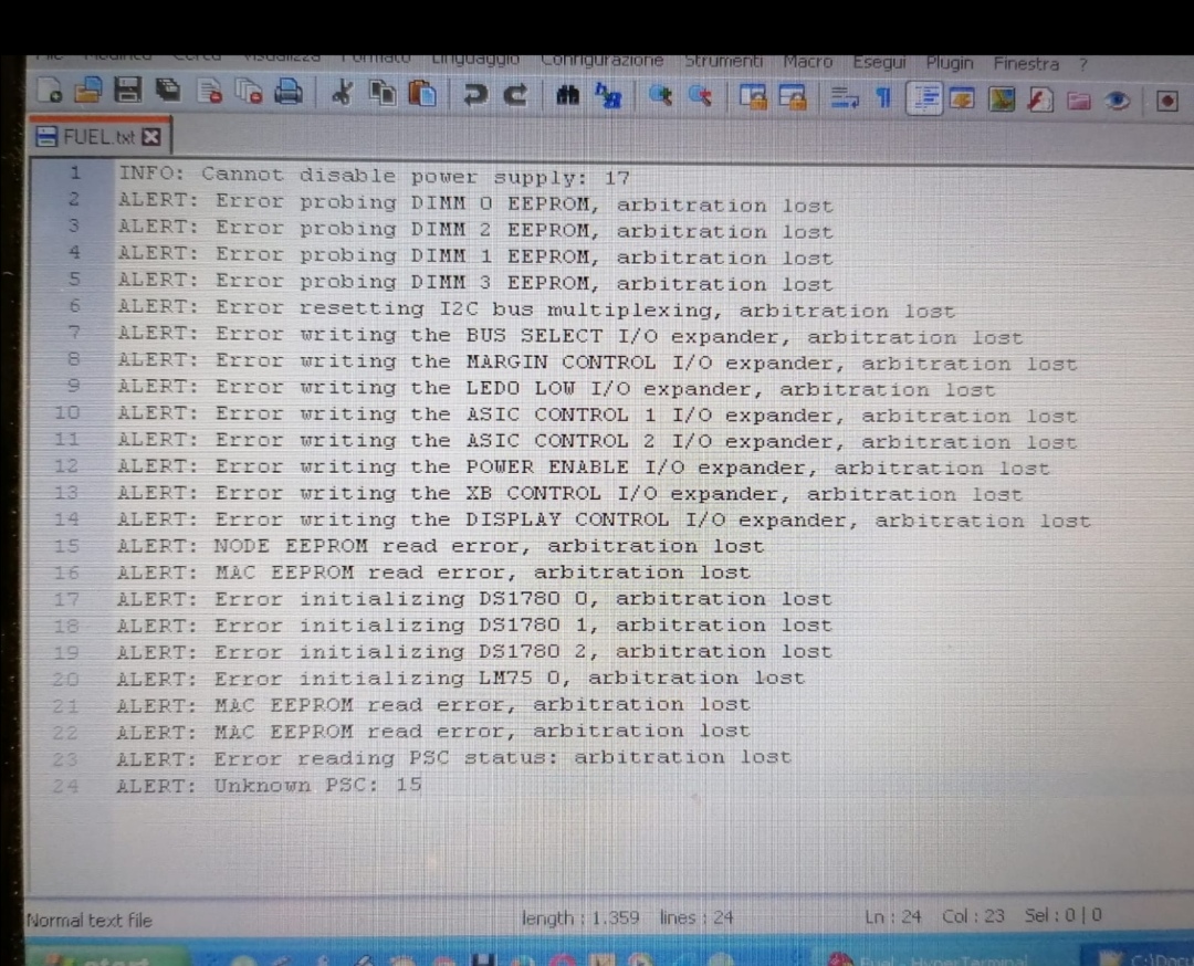

Hi, I think I have the same problem too, but in addition to these messages in the picture it does not give me. Keep sending this endlessly.
