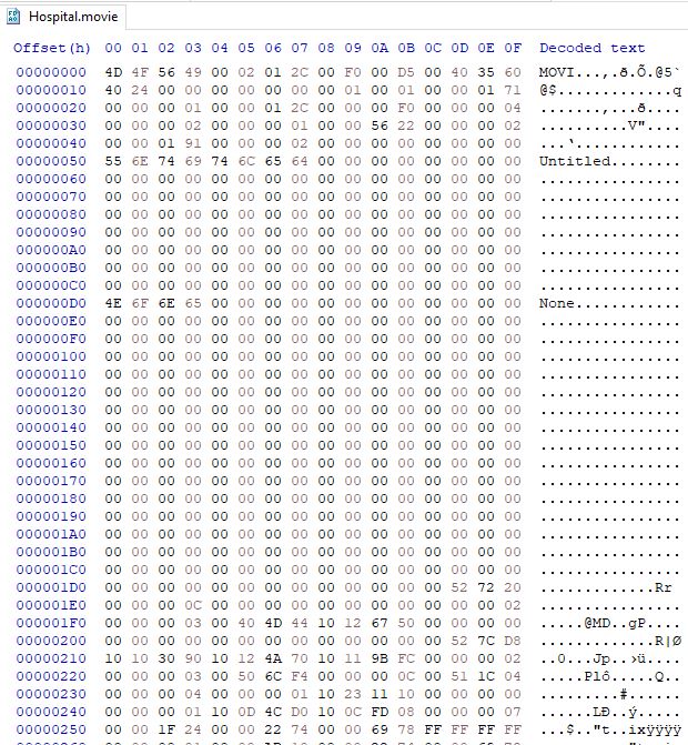

I went back to an old project today, trying to pull the Irix demo videos (as seen in the cool space tour video here: https://www.youtube.com/watch?v=srRquWes0BQ) off of my Indigo. The Indigo (R3K, elan) has a base 4.0.5 install to a SCSI2SD. I had given up a while ago because the EFS file system is a pain I didn't want to network the machine at the moment.
Today I finally realized I could just dd the SD image (for partition 7, if anyone comes looking) from the SD card to a file and use efs2tar to extract the whole filesystem. It worked. (If anyone wants the tarball of the R3K Irix 4.0.5 install, just let me know -- it's only 130MB uncompressed).
What I now have are the videos, filenames of "hospital.MOVIE", "indigo.MOVIE", etc. VLC can't figure out the codec, which for me is about as dead-end as it gets. It does pull the audio, but not at a consistently right speed.
I've attached a screen clipping of the header of one of the files in HxD. Anyone have an idea of any modern tool I can use to open this and possibly convert them to modern file format? Would be a shame for them to otherwise be lost. Especially the Indigo video -- I used to drool over that long before I had an SGI of my own.

That header looks... strange. Dunno what that is right there, but it may be SGI proprietary. Failing all, you could always use the analog hole, as we call it, to externally record the videos?
09-07-2021, 02:28 AM
RE: Help with Irix 4.0.5 Tour Videos
MOVI claims : http://fileformats.archiveteam.org/wiki/SGI_movie
SGI Movie..it's a thing and they also claim FFMPEG understands it. Try to transcode it!

On Linux, mplayer plays them just fine and reports:
Opening video decoder: [ffmpeg] FFmpeg's libavcodec codec family
libavcodec version 58.91.100 (external)
Selected video codec: [ffmvc1] vfm: ffmpeg (FFmpeg SGI Motion Video Compressor 1)
So weblacky is correct about ffmpeg understanding the format!
