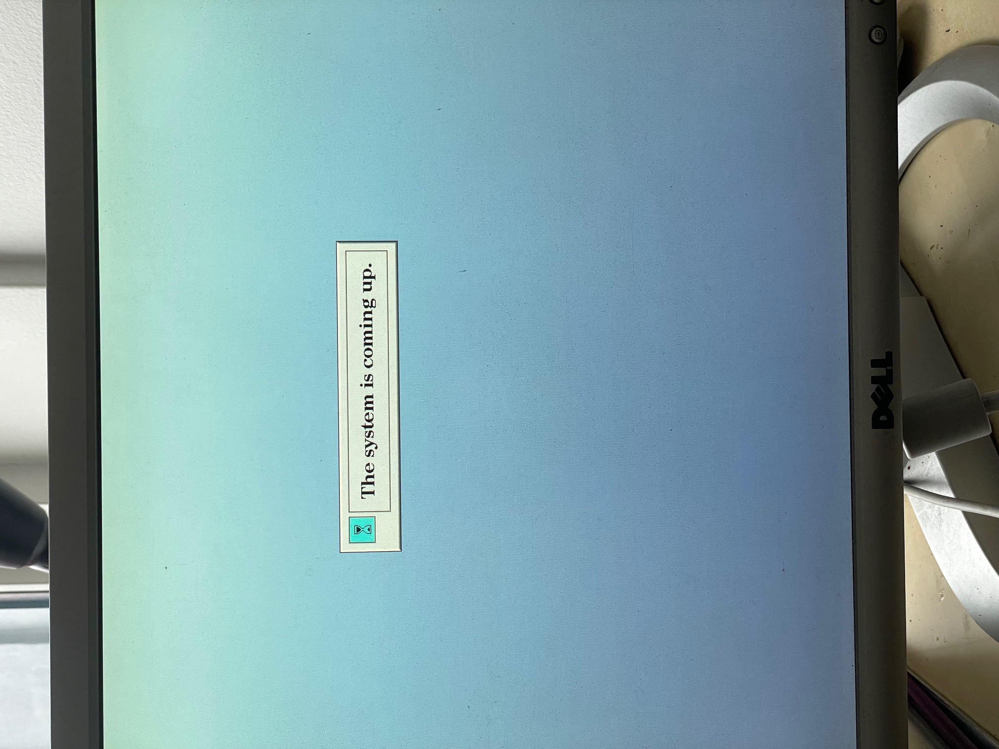

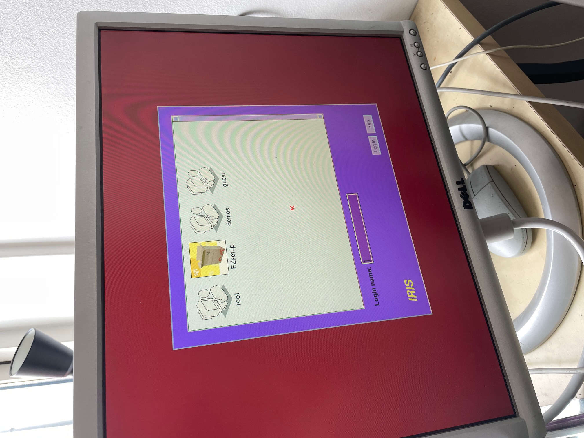

Hello there! I’ve been running an indigo2 with HIGH IMPACT graphics and a 13W3-VGA SGI cable fine for a while until the screen went black. Everything works until the login screen (I assume it’s called managed mode) but then my screen gets confused, tries to detect a signal and finally sleeps.
Some pics:
Boots fine:

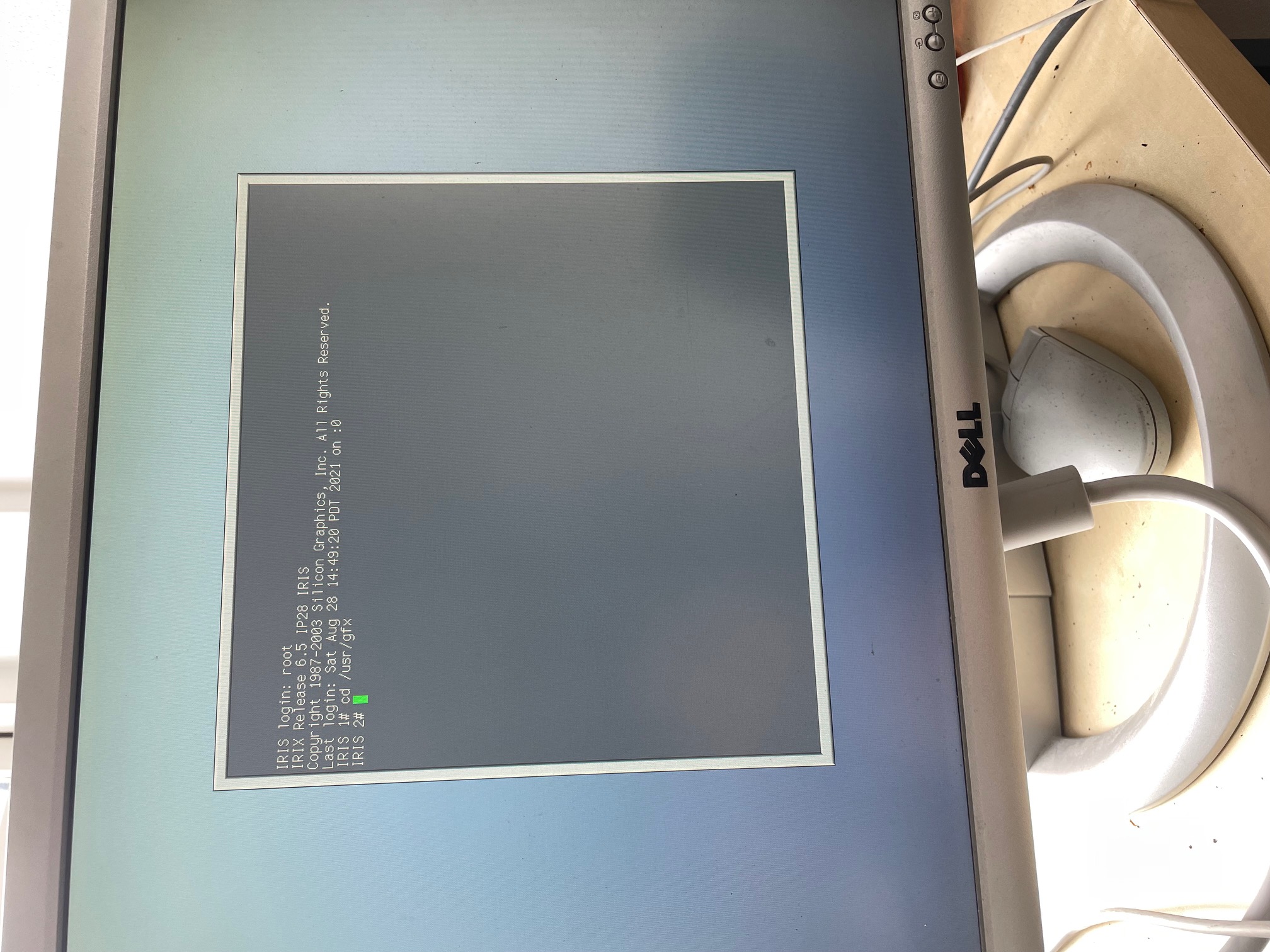

I managed to get this by playing around with setmon:
However after logging in I get the same problem - monitor cannot correctly detect the signal.

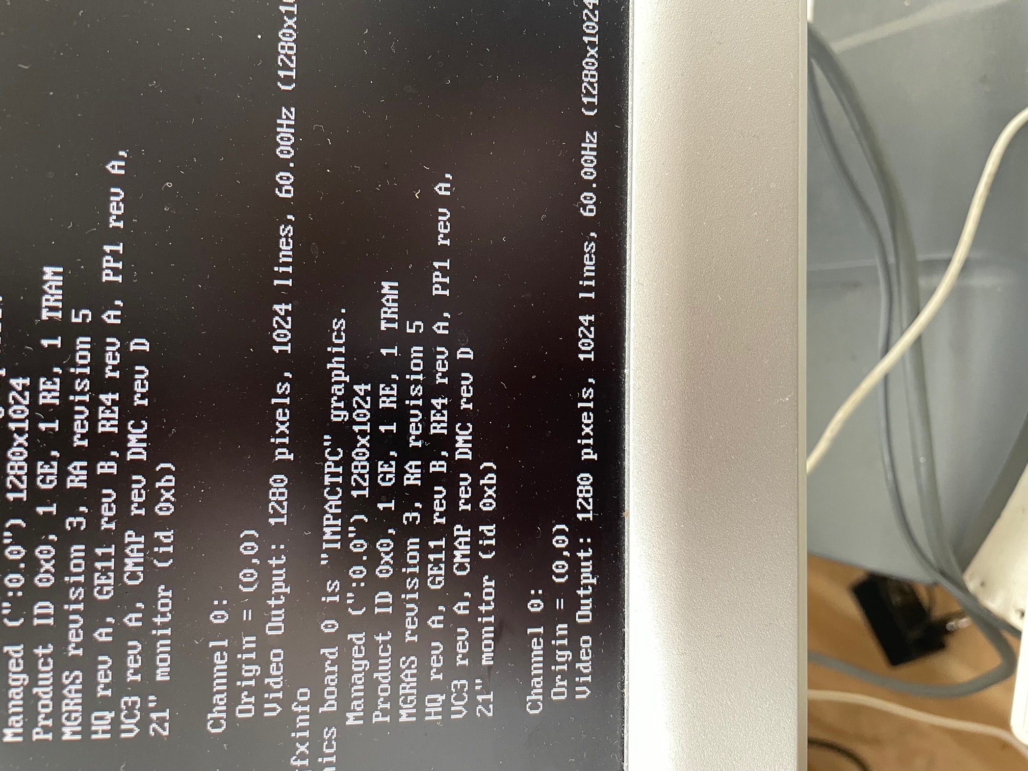

Running stopgfx gives me this:

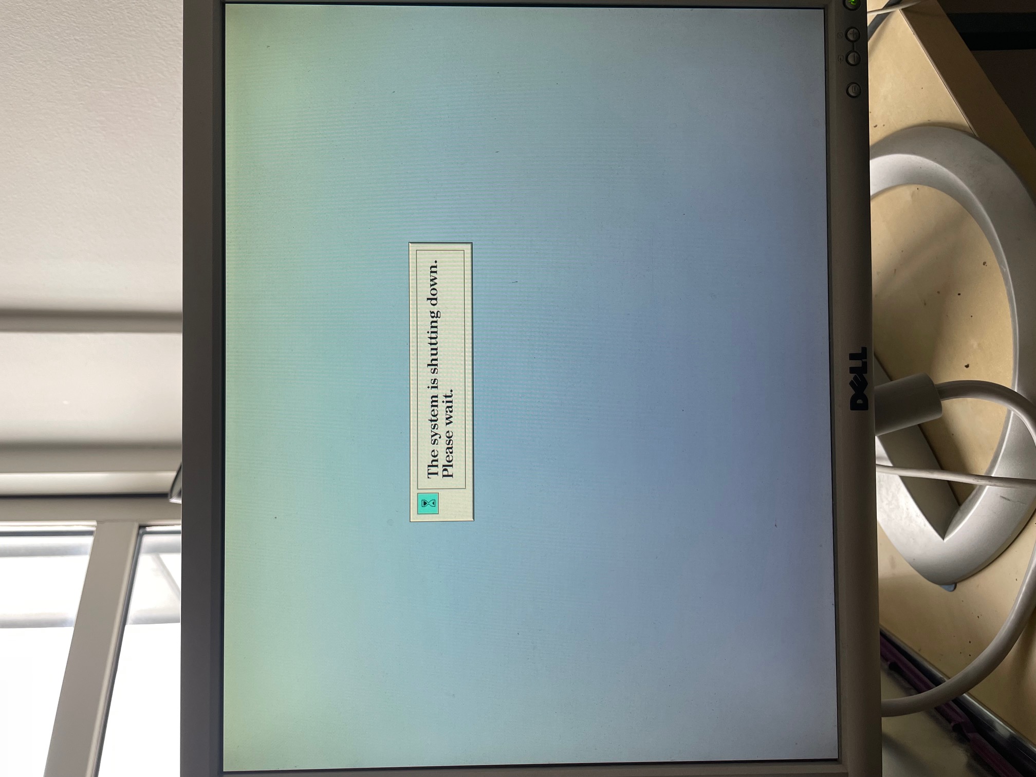

And sometimes when shutting down I get the standard screen:

When you are in the textport (your image #5), type "/usr/gfx/setmon -x 72" and then type "reboot".
