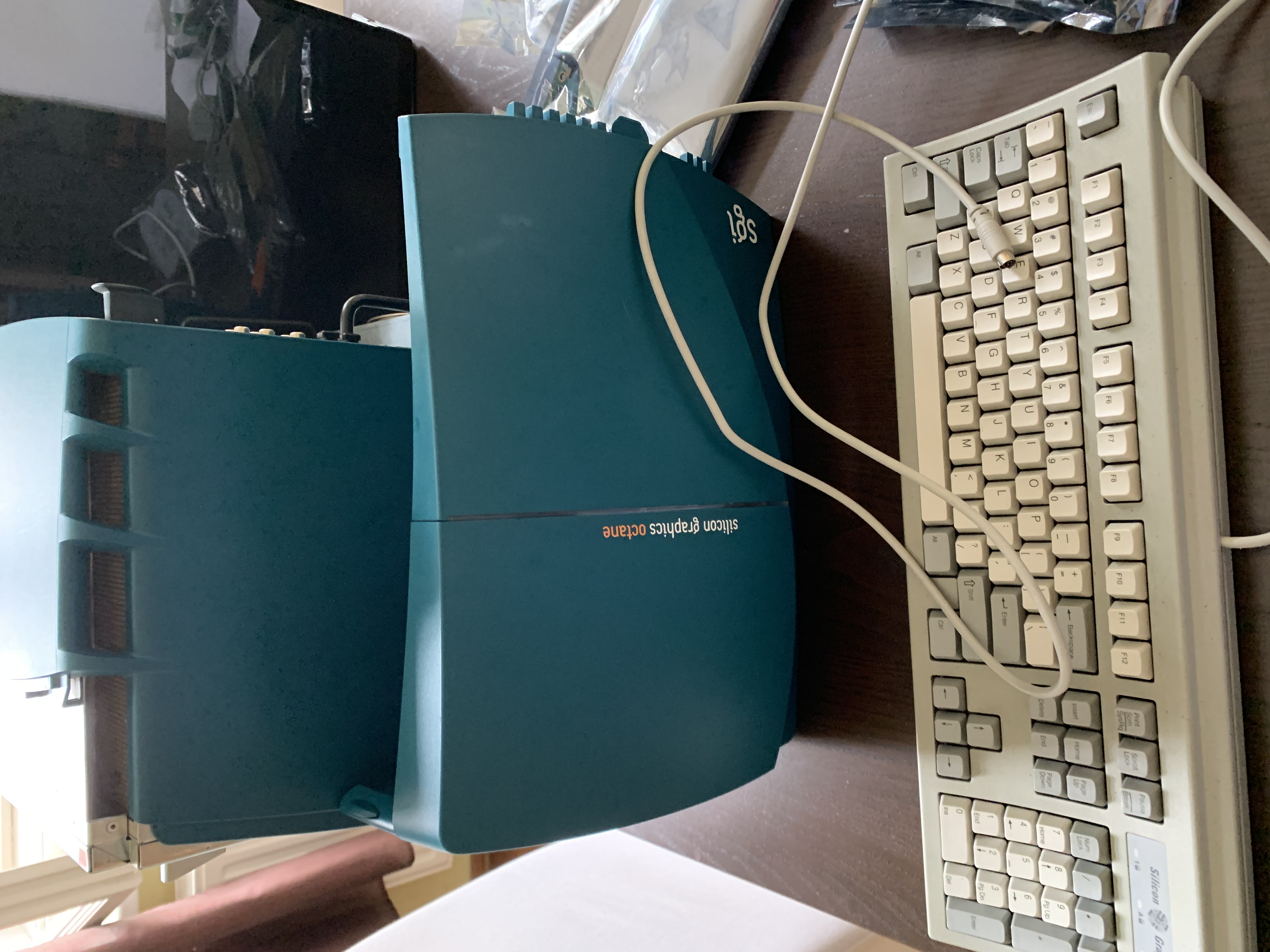

The Octane has arrived. Less than 24 hours from London here was very impressive. Kudos to DHL.
It was very well packed, ready to survive a nuclear war. The machine is in a beautiful condition.
I managed to resist the urge of connecting everything. Photos attached. Besides what's included, there are some extra hard drives. The original 9GB one and a double height barracuda, capacity unknown.

1. What's the best way to attach the front panel without causing damage?

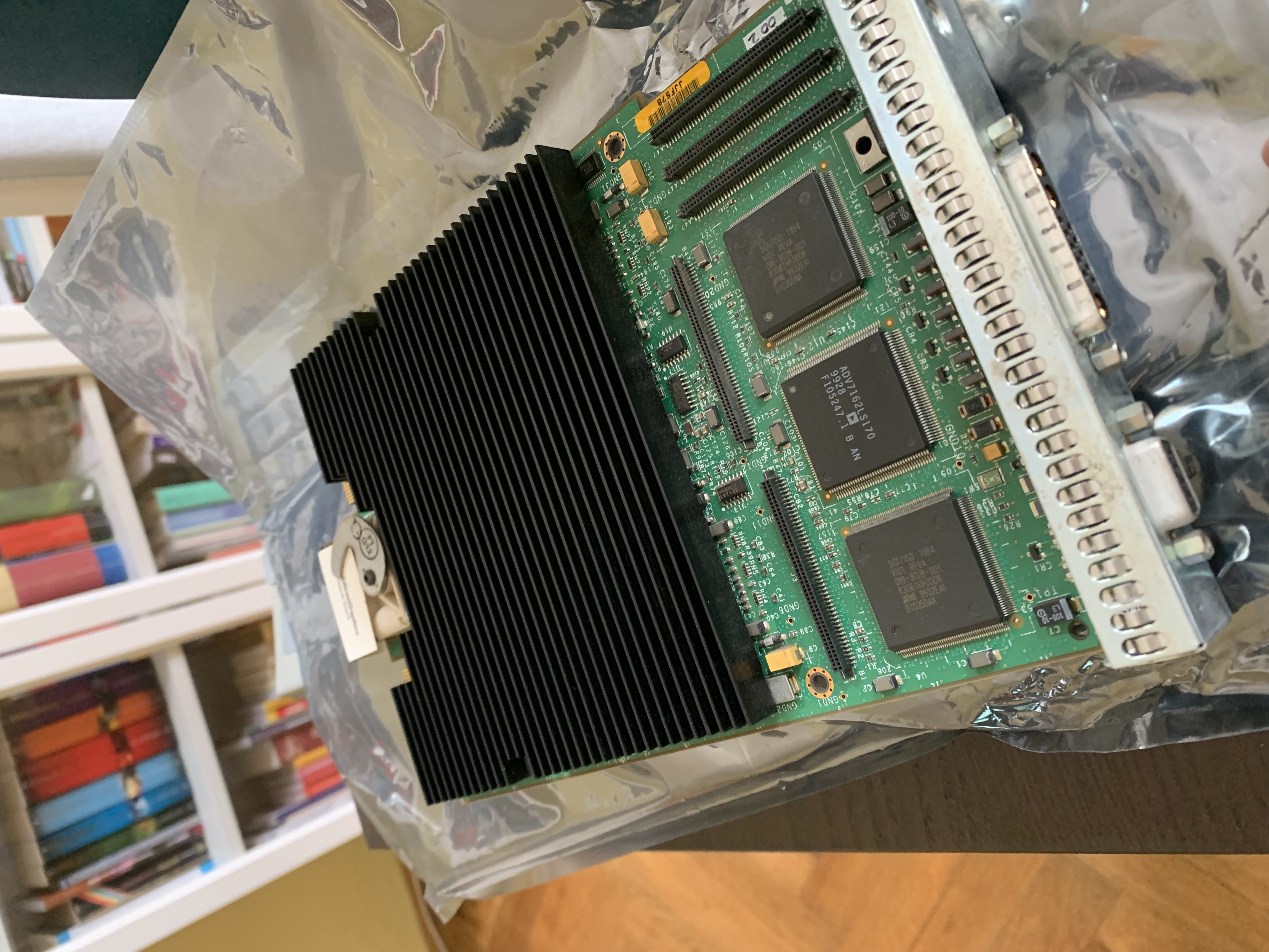

2. What's the extra graphics card?

1 The front panel has little notches that line up with the bottom of the case. Gently align them, then rock the front of it back until the two tabs on the sides lock in. Everything should look even, panel fitment on these is perfect in 99% of cases.

3. Both of those look like SI cards. You can add the second one to the carrier likely and get a second head.

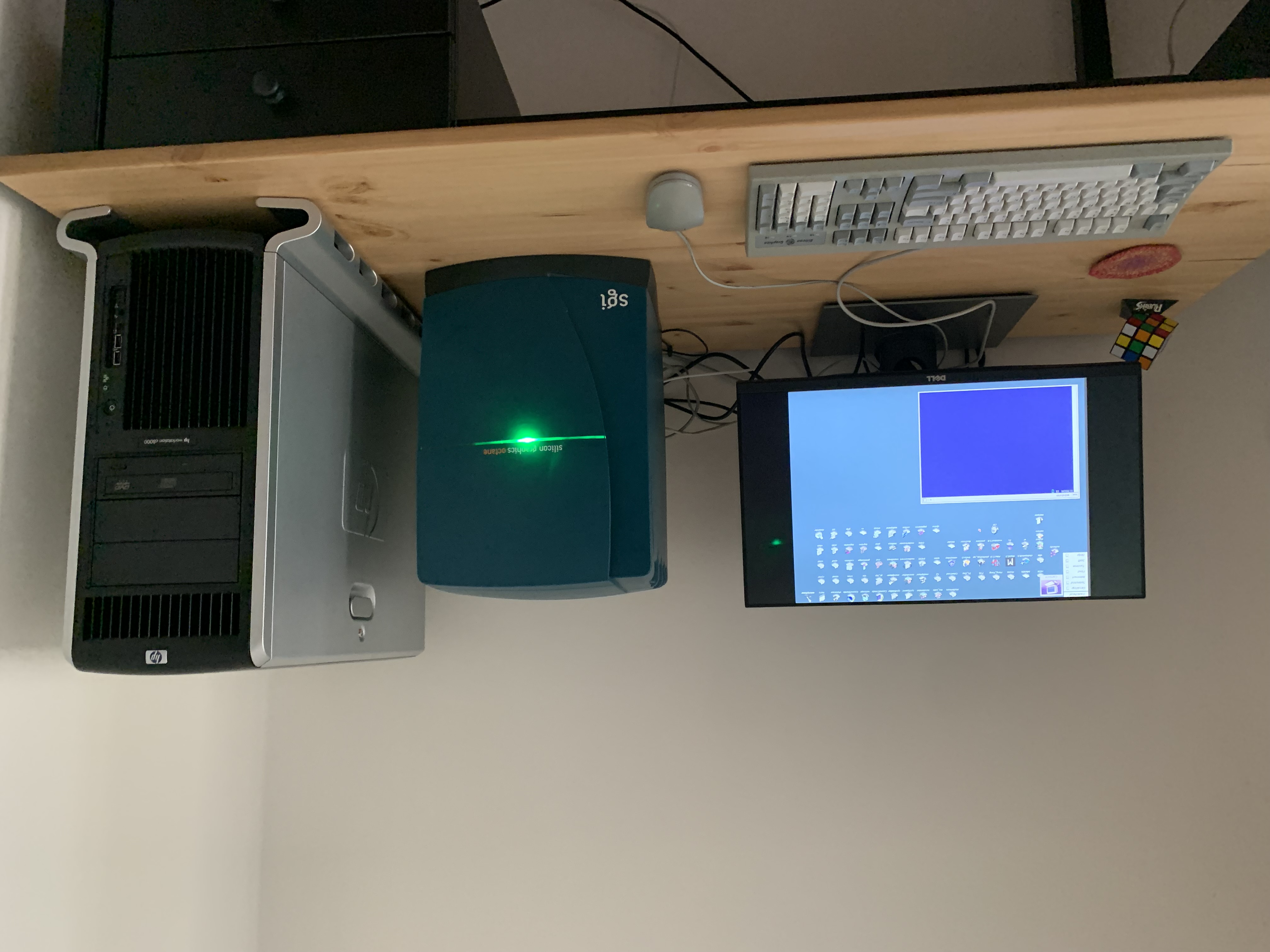

We are up and running!
It looks VERY good next to my C8000.

Quick question:
I am colourblind AF.
Are my colours right?

(06-09-2021, 07:51 PM)Shiunbird Wrote:  Quick question:
Do you mean on the screen? If yes then yes, they look fine Smile

Some notes:
* "Are my colours right?" - that HDMI adapter is convenient but will def make it over-bright / off-contrast; better if you can find a VGA monitor to connect it direct to the sync conversion cable
* the installed ESI graphics card has the Texture RAM upgrade - that second uninstalled board was the original one.

Yes - I'm now connected directly to VGA and it is much better indeed.
The monitor has very fine adjustments for the input and can do 4:3, so I will be able to adjust it.
I'll use HDMI if I ever need to capture the screen.
About the card without TRAM... can I mix both?
