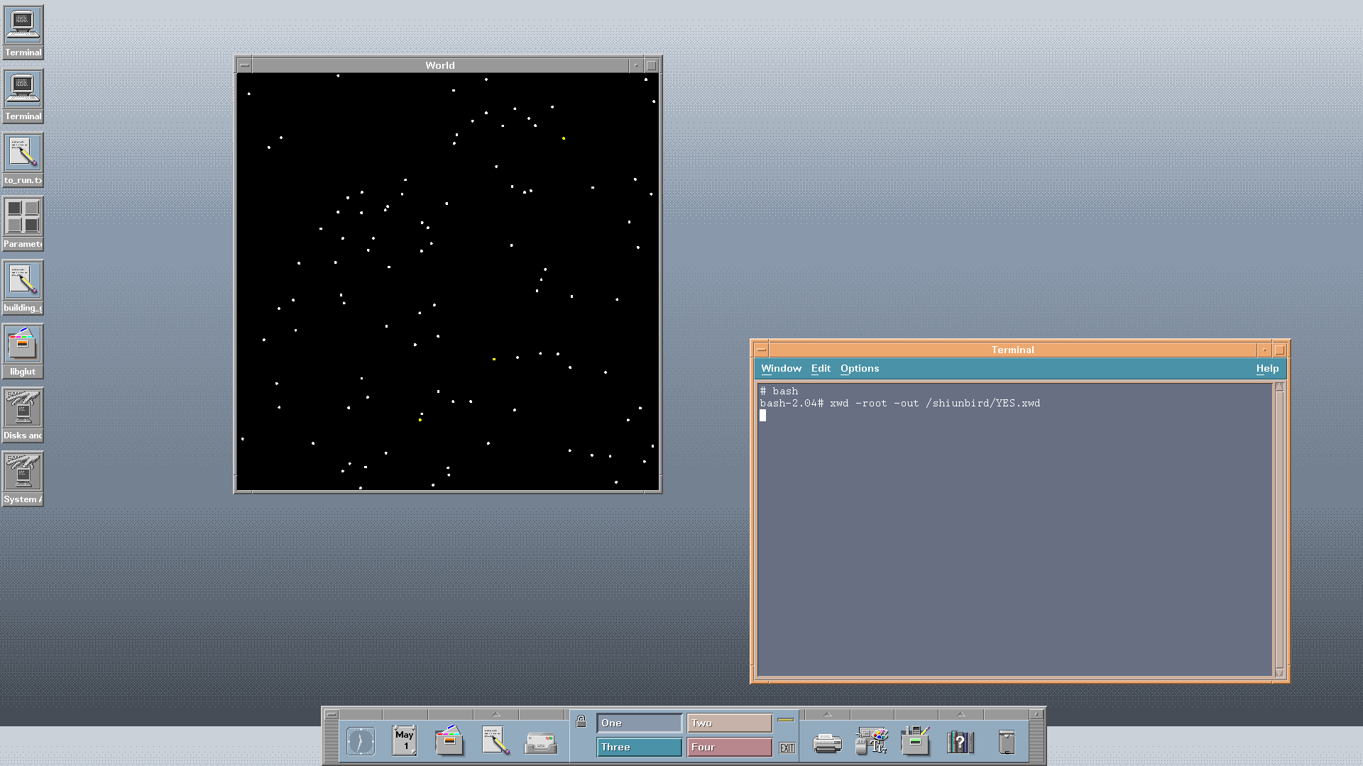

I made it!
Exactly the two packages listed above did the trick. (I also installed C++ while I was at it).
The X11 libraries are part of it.
While I was researching, I ended up finding someone on Stack Exchange who is willing to port Quake II to HP-UX. I hope he replies back to me!
I'm not sure where to document this, so here are the steps:
C8000 specific, to enable hardware acceleration (with thanks to jpstewart):
1. PHSS_34389
2. HWEnable11i_B.11.11.0612.458.depot
After that, the pesky message that comes up every time X loads complaining about the drivers stops appearing, replaced by a lovely HP logo.
Then:
3. B9007AA - HP C/aCC++ Developer's Bundle (including B3899AA - HP C/ANSI C Developer's Bundle and B3911DB - HP aC++ Compiler)
4. B3394BA - HP-UX Developer's Toolkit for 11.11
5. B6268AA - Graphics and Technical Computing Software (TCOE), including all the OpenGL libraries.
From here, HP documentation helped. To use their compiler, I followed their "OpenGL Implementation Guide for HP-UX 11.x" and came with the following build line:
cc -g -Aa +e -D_HPUX_SOURCE -z -I/opt/graphics/OpenGL/include -I/usr/include/X11R6 -I/opt/graphics/OpenGL/contrib/libglut ./bench.c -o ./bench -L/opt/graphics/OpenGL/lib -L/usr/lib/X11R6 -L/opt/graphics/OpenGL/contrib/libglut -ldld -lglut -lGLU -lGL -lXext -lX11 -lm
GLUT is, naturally, optional. If you use GLUT, you don't need to explicitly include GL and GLU. GLUT includes them.
I had to change only one line out of 800 from my original code that I built on Mac Mojave.
