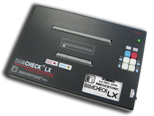

I've just come into possession of ANOTHER ramtester, the RAMCHECK LX.
Three years ago I got a SIMCHECK II (older product from the same company) that can do SUN 200-pin memory, SIMMs for every kind (including PIMMS) and individual chips (like what you see in old 286/386 PC boards and Arcade cabinets - SIP/DIP/ZIP chips)!  I personally worked with the company to help refurbish this older unit in Summer 2019, I visited their website two weeks ago and it gives the false impression they were still in business, so I bought a beat-up/used RAMCHECK LX (latest product they made!) from eBay for a fair price.  Well, when I tried my login on their site after the eBay auction had concluded, it errored, not good, all emails came back "closed" or undeliverable, not good!.
I had to go three pages deep to find the notice that they closed up shop suddenly (without selling off their inventory!) in December 2020...gawd damn!  Well, I was already on the hook for this eBay buy...so I doubled down.  When I got the unit today, it was missing all it's screws (bad sign) and had some issues.  But I had a contact from the company that I found worked at a dealer now, so he filled me on what happened and gave me critical power info I needed to emulate its PSU.
I used my bench PSU and booted it, it came up fine!  And oddly enough it had the last firmware on it!  Seems it was in use until about 3-4 years ago!  I had no daughtercard on it, just the base unit.  But I fixed every other issue I found and got proper screws and re-secured the unit.
So I located a 44, 50, 54-pin TSOP DRAM (DDR1 & DDR2 tech) chip-tester daughtercard for my new tester on eBay (paid just as much for that daughter card as entire base unit), the daughter cards for this model are normally VERY expensive (normal price on this 3-chip daughter board was like $600 though, most are $1,000+).  I just won the auction for this daughtercard today and paid for it.

Ok, well, bad news.
I got it all today, ended up unsoldering two O2 SDRAM ICs only to get...nothing.
I first preheated the DIMM to around 200C and then took a 313C hot air gun and removed the first IC.  I placed it into the 50-pin TSOP socket tester, it claimed a wiring error with stuck D0 line, using my huntron I found a TINY solder whisker was in fact connecting pin 1 & 2 on the IC , cleared it, reinstered it, "no memory"...darn.  Ok, desoldered a second chip, reheated the IC legs to prevent bridges, let it cool, and placed it into the tester..."No memory"...gosh darn.
So it seems the documentation on this is poor and I missed a crucial "implied" support.  The adapter document is like 5 lines, it claims to support "popular TSOP SDRAM memory chips in sizes of 32Mx16, 16Mx16, 4Mx16, 32Mx8, 8Mx8, 64Mx4, 16Mx4 and more".  Well these chips' Data sheet says SDRAM 512 x 16 x 2.  OK well that's a lower numner of banks...but maybe that's covered under the "more" clause of their statement.  Nope.
Turns out O2 RAM chip is SDRAM titled: 524,288-word × 16-bit × 2-bank Synchronous Dynamic RAM running at 66Mhz, 83Mhz, 100Mhz platforms.  So that would top out of like PC66 & PC100 SDRAM...the darn tester only make glancing references to SDRAM X4, X8, X16 chips...but never mentions DDR...but that's what it is..DDR SDRAM support ONLY, not SINGLE RATE SDRAM.
So this tester won't work with the SGI memory, the tester board is ONE standard NEWER then the SGI RAM.  Sad, kind of a waste of money, kind of a waste of time, Oh well...expensive lesson.  Hopefully I'll find other boards for it in the future.
Experiment done. Result, FAILURE.
