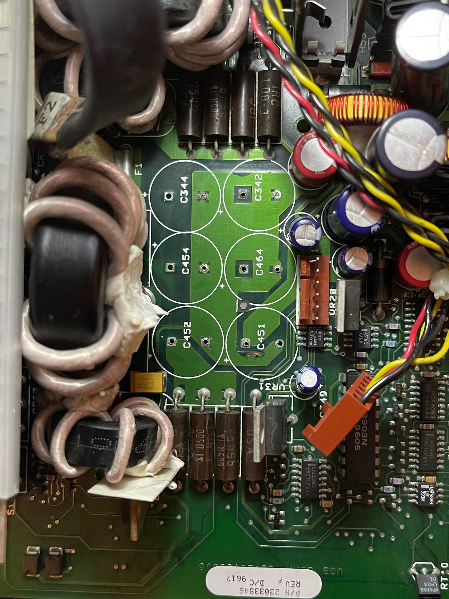

I started removing caps from the power supply, and noticed some trouble on the low voltage board. There is a group of six 6800uF caps on that board, all of which had green corrosion around the leads and a couple with traces of liquid under them. One was so bad (C451) that it ate away some of the mask on the PCB, exposing copper (see pic). Fortunately, I don't think this will cause a problem as it's very minimal.
I cleaned up the mess, and will order replacements.
Also, I didn't see any obvious trouble on the high voltage board. No corrosion or bulging caps. I did order new caps for this board, so I'll replace them anyway even if they're not causing the trouble.
