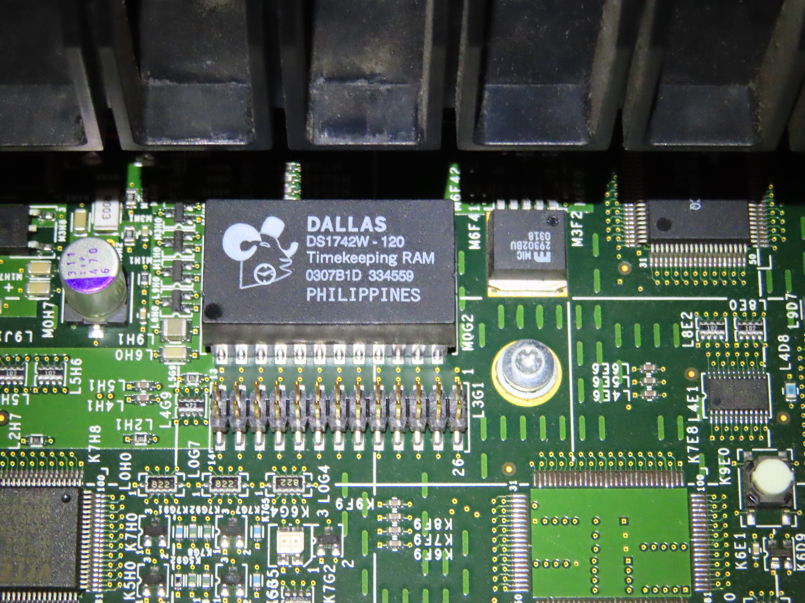

I've noticed that my Dallas DS1742W Timekeeper chip is now seventeen, eighteen years old.

Weblacky, please allow me to ask this almost criminally stupid question:  Is my DS-1742W soldered onto the Tezro mainboard?  Or, could I just pull it off, push on one of your $18 ones from eBay, type something magical at my L1 prompt like "serial set A1234567" and then my Tezro would be OK again for at least five more years?

I really doubt that the flat Dallas chip is the source of your power problem! (Mine runs perfectly with a flat Dallas chip!)
I therefore wouldn’t recommend touching it!
The nice thing about the Tezro is the fact that replacing the SnapHat on the IO9 sorts out time keeping issues.

(03-18-2021, 06:40 AM)vvestraa Wrote:  Weblacky, please allow me to ask this almost criminally stupid question:  Is my DS-1742W soldered onto the Tezro mainboard?  Or, could I just pull it off, push on one of your $18 ones from eBay, type something magical at my L1 prompt like "serial set A1234567" and then my Tezro would be OK again for at least five more years?
I see a lot of talk about the MiniPRO TL866 eeprom writer, talk that scares me.
https://www.youtube.com/watch?v=FLG03f_ua5g
Recent forum research has proven that the answer is yes, to the latter.  I do believe that all the RTCs have been socketed in the workstations.  Some of larger mini fridge sized SGIs do have soldered RTCs and the Iris Indigo has a solder lithium battery.  All the stations have replaceable RTCs.
The scary part is if you don’t start with a blank (new or wiped via programmer) RTC in a Trezro. Unlike every other SGI, Tezro has issues with not wiping and totally defaulting to setting up an RTC when it has old contents on it.  Other SGIs don’t have this problem, but Tezro does and it won’t let you set serial correctly of it has old data (not from another Tezro).  If your used chip does come from another Tezro you can use the set serial command to change it. But if it’s from another device, you’ll have trouble.
It will auto setup if totally blank and sometimes you’ll need to use set serial, sometimes not.
jwhat & khral confirmed this for us not too long ago.  If you can drill the RTC then loss of power by removing battery leads and reconnecting a new battery will also blank the RTC.  So setup for life :-).
Now that we know people’s previous issue with used RTCs and the solution, it’s less scary.
Yeah, it sucks the RTCs when out of production when some of them are still made! But it’s workable. If I were you I’d just watch out for a new RTC on eBay and leave what’s in your Tezro.  If it’s battery goes dead you can still operate, you’ll just need to reset L1 time at boot and if you keep default nvram setup (I do) you’d not notice it.
A dead RTC on a SGI doesn’t prevent boot, it just resets on power loss, but if you keep things stock, you can just plug power in when you want and re-setup the time in the worse-case scenario.
Once most SGIs start they provide power to RTC and when it’s externally powered it operates just fine, so you can still start the system.
Just think of like an old PC where the moment you unplug it the BIOS forgets all time and settings.  That’s all that would happen on Tezro.  It would still boot.
Unless you have some reason, it’s not a critical thing to worry about.
We’ve never had a report here of an RTC actually going bad and failing, just the internal battery inside the RTC.  Most of the time you drill it or buy a drilled one from someone else.  But you’ll still boot.  Don’t worry yourself too much, you won’t be stuck or dead with your current RTC.
