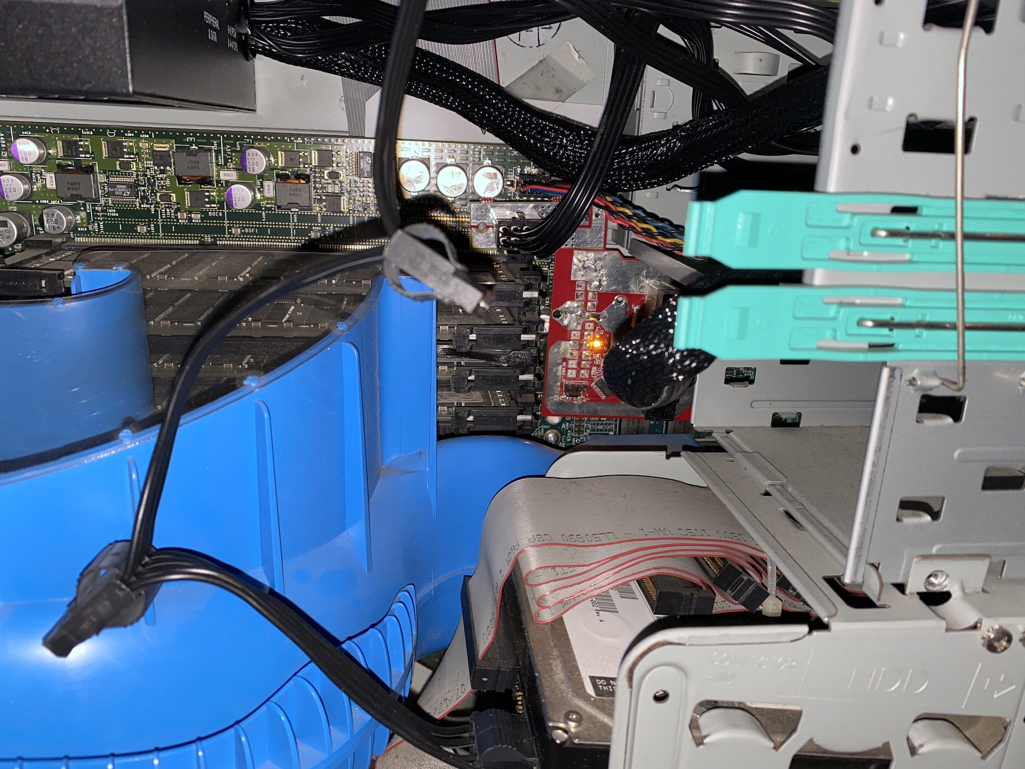

I have a Fuel which I've left plugged-in, but haven't actually powered-on in an age.
I came back to it the other day, and found that pressing, holding, doing anything with the front-panel power-switch does... absolutely nothing :(
However, I previously invested in a converter board (the name of which currently escapes me) which allows me to use a standard ATX PSU with this hardware.  And it has an orange LED which is clearly lit!  It also has an override push-button which can be used to power-on the system - and if I hold this down then the fans all spin up and if I hold it down longer it sounds as if the firmware is beginning to bring the system up.  But as soon as I let go the power dies again.
I'm pretty rusty these days, but I'm digging around to find serial cables/converters to plug into the internal L1 connector and the rear serial port... but, in the meantime, is this a known problem?  Is there something I've missed?  Any suggestions for anything I can try?
(My understanding is that the common environment-monitoring issues Fuel systems have - which, so far, I'd not been affected by - lead to premature shutdown rather than a complete failure to start at all?)

Yeah, env monitoring usually doesn't cause a complete failure to start. I'd first check to make sure your power switch circuitry has continuity. If it does, go down the line. What if you jump it at the pin header?
Beyond that, sounds to me like capacitor failure somewhere if it's this bad. That's Kuba's board you're using, and it seems to be reliable for most people.

I've eventually had time to try this - holding down the power button on the Kuba board causes an additional on-board LED to light green, the disks to spin-up, and other hardware add-in boards to initialise.  The lightbar lights white, but there's no video output and the lightbar never changes to red (which IIRC is usual during the system bring-up process).

On the positive side of things, though, the Fuel does now seem happy to start from its front-panel button - and a power-cycle seems to boot to IRIX again, rather than stopping at `sash`!
