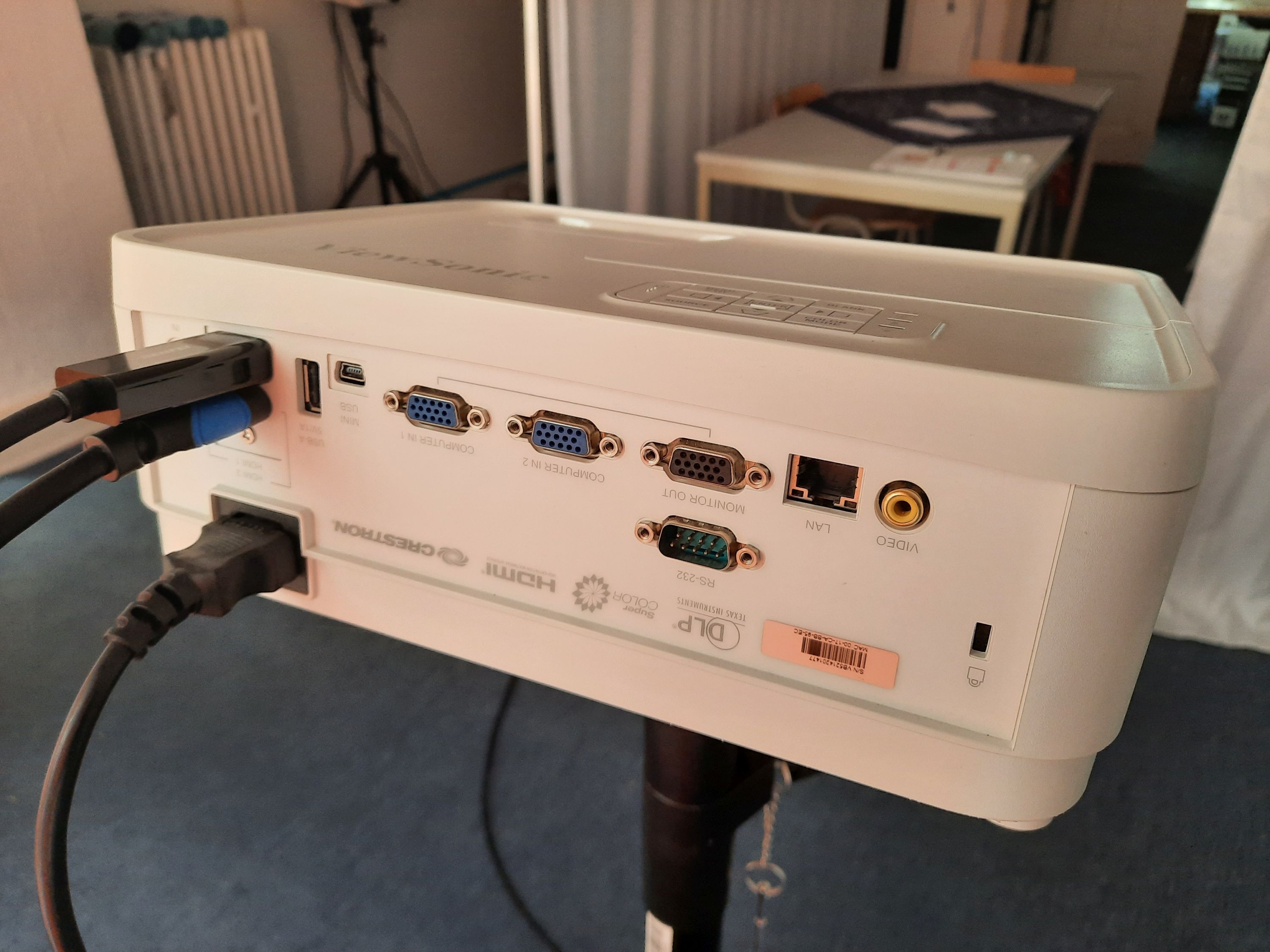

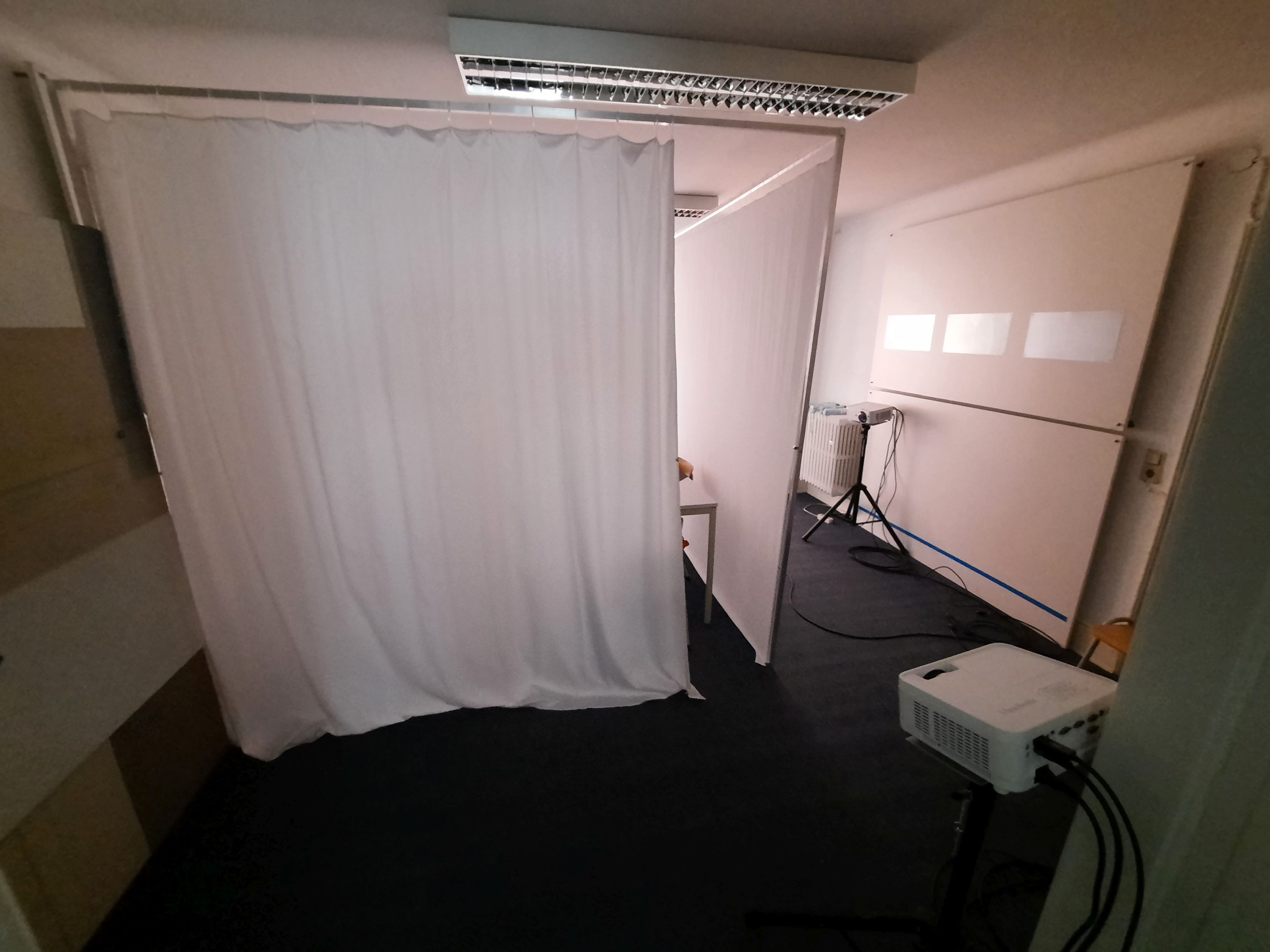

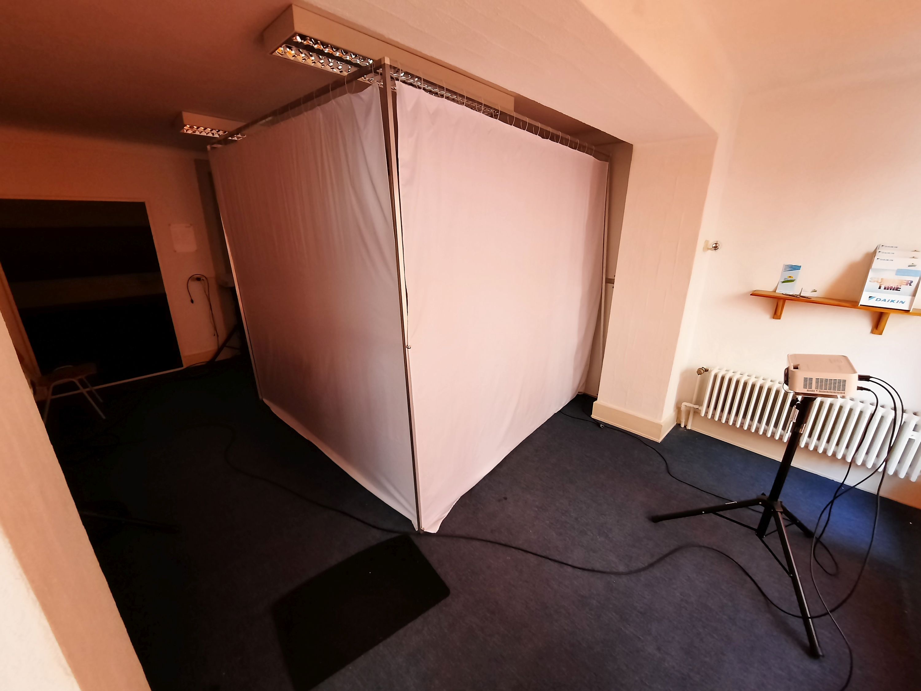

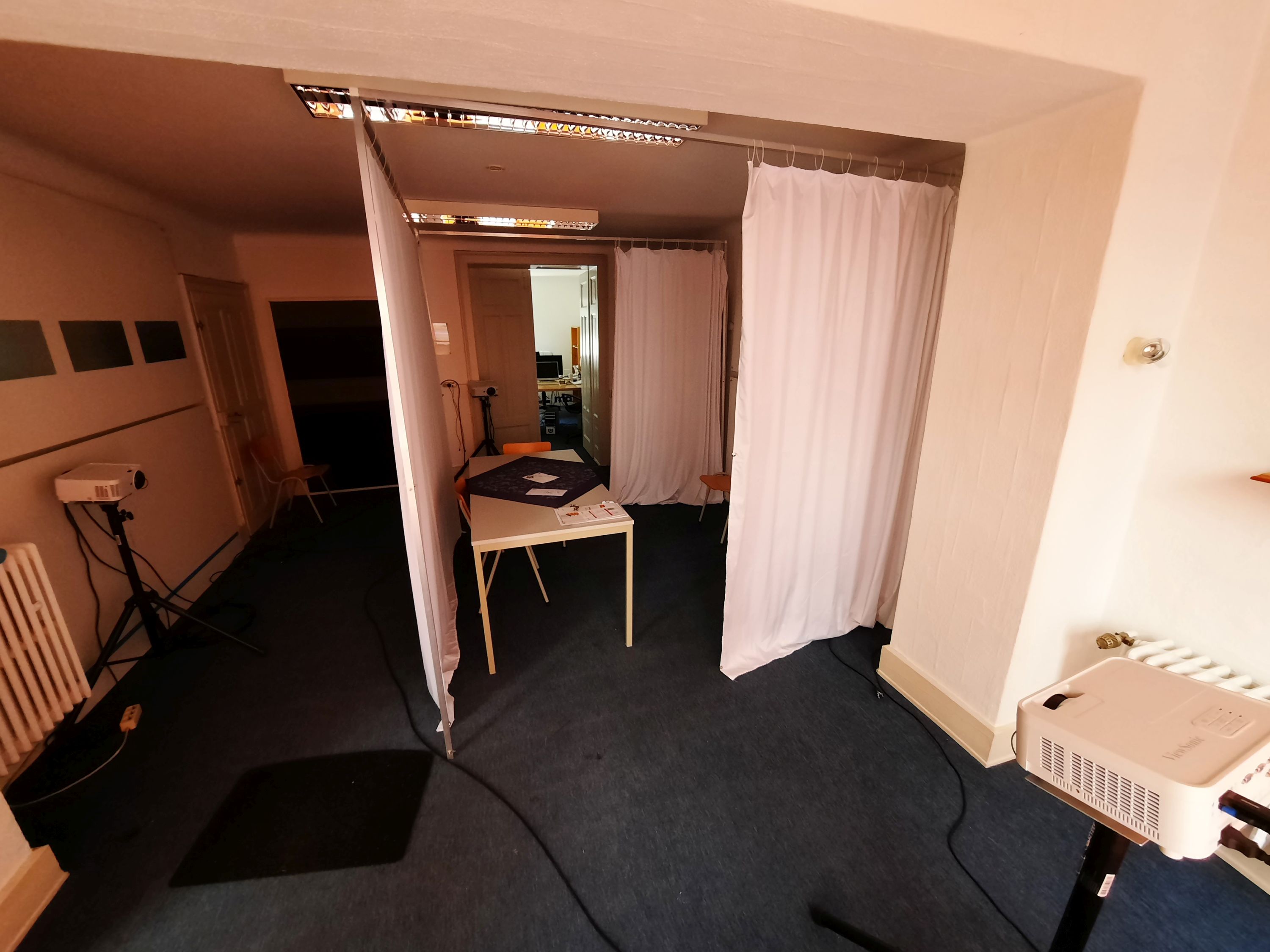

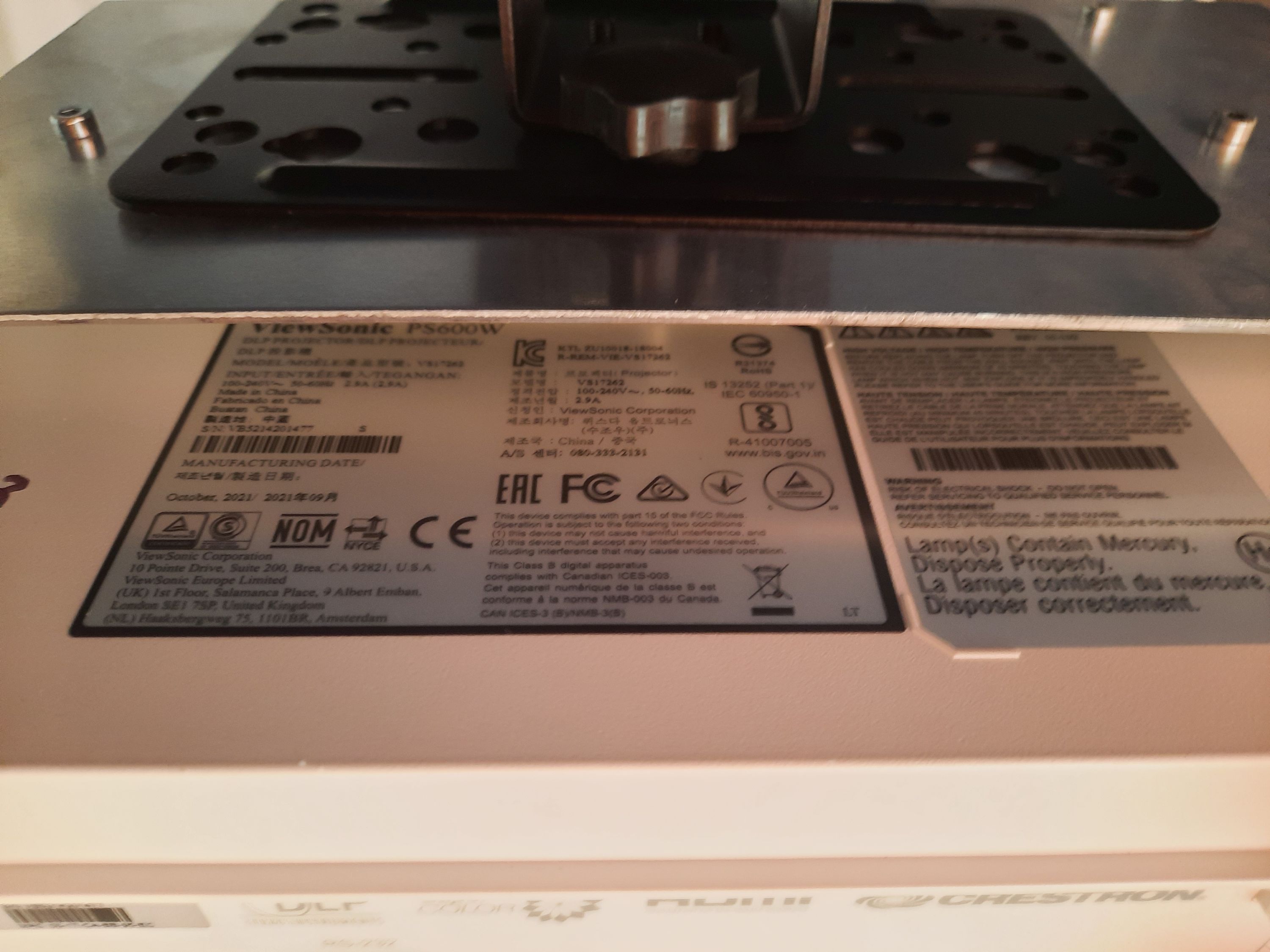

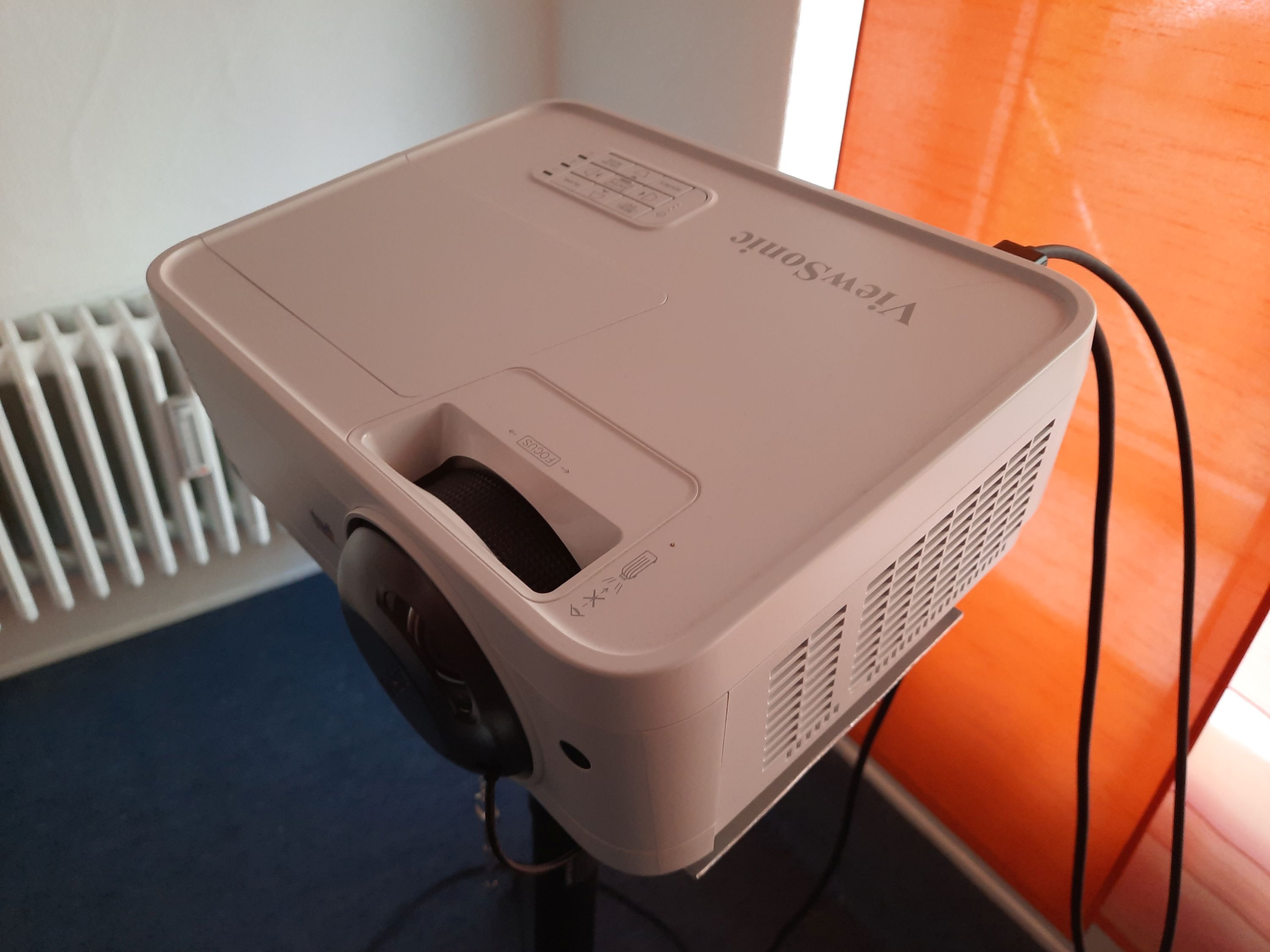

I did test it with a 144 Hz LCD, no problem here.
I am building a cave with modern DLP projectors but not finished the software part yet.
Another thing is the availbity of libs:
Cavelib was available on Irix those days but i never found a copy of it, would be the best choice.
There are opensoure projects as vrjuggler and freevr but i did not test yet if one can get those compiled under irix.

Can you please describe the 144Hz LCD (projector I assume) you're using in the setup?  Are you doing polarized left/right eye with two projectors or did you get the 3D output format recognized by a single projector?
