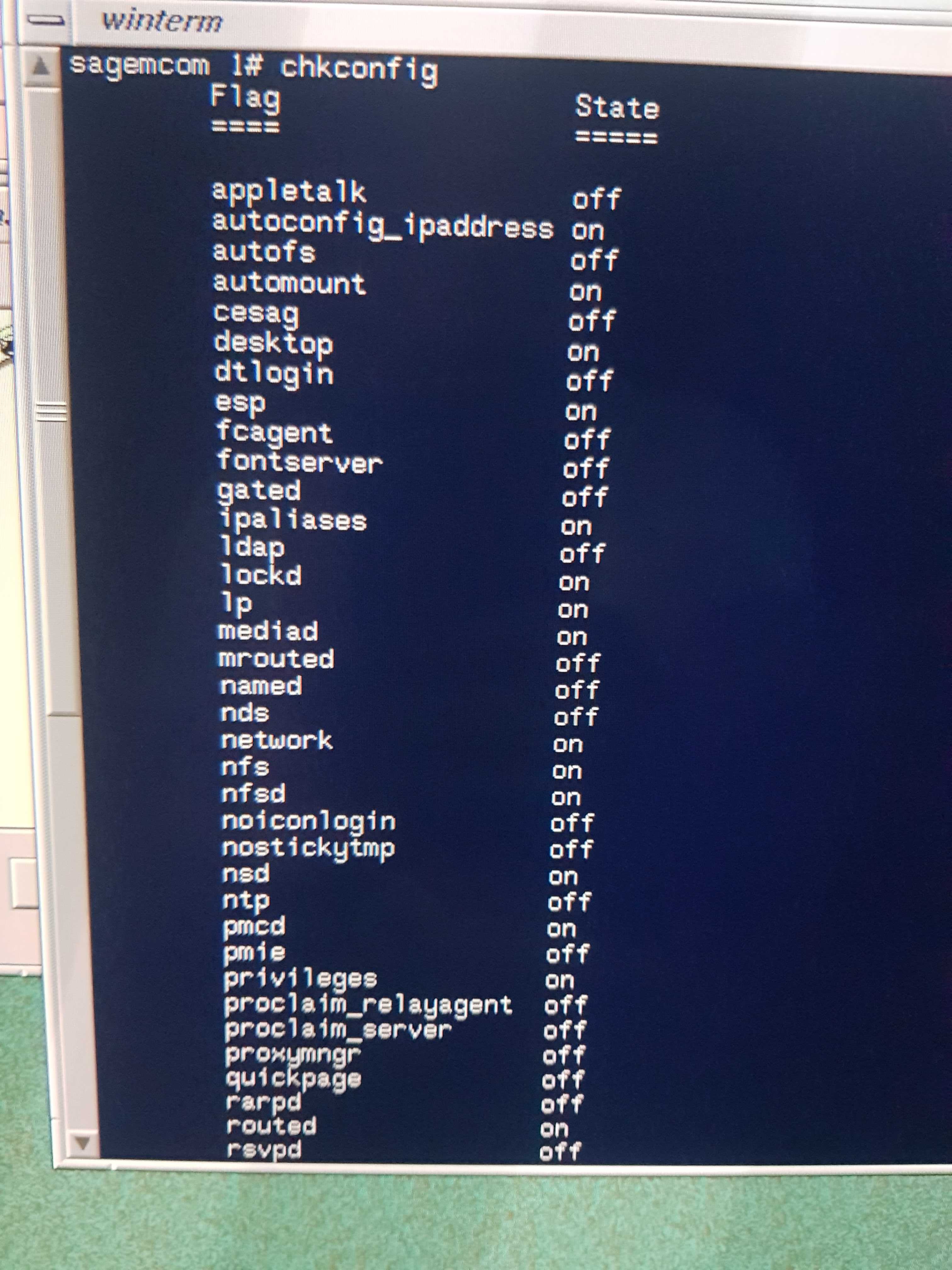

1. chkconfig on your IRIX machine to make sure NFS enabled

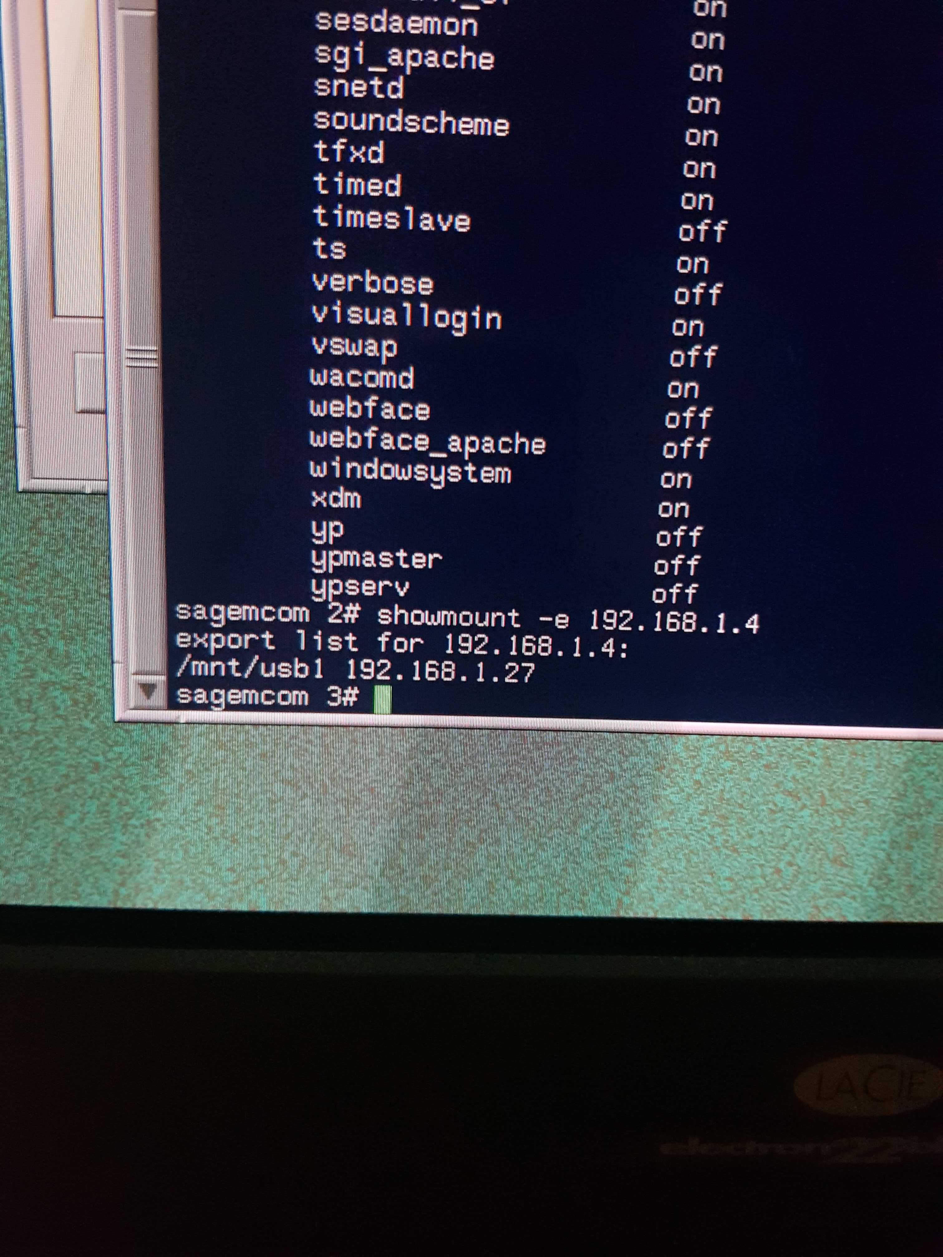

2. showmount -e 192.168.1.4 (your PI server) from your IRIX machine to verify if the exports are visible.
If they are then you will have to dig into permissions etc.

Result of chkconfig
NFS is set to ON
Result of showmount -e 192.168.1.4
It seems to be able to see the exports.

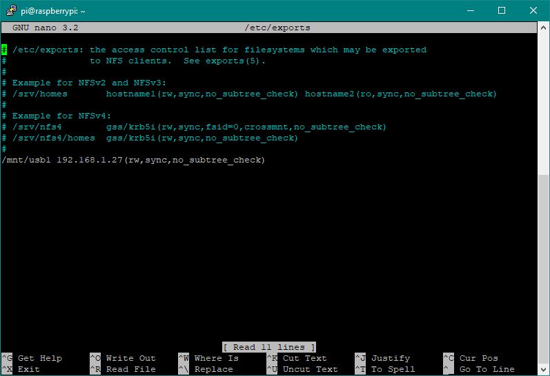

Exports file:
I set the parameters to the example given in the comment section of the file for NFS v3.

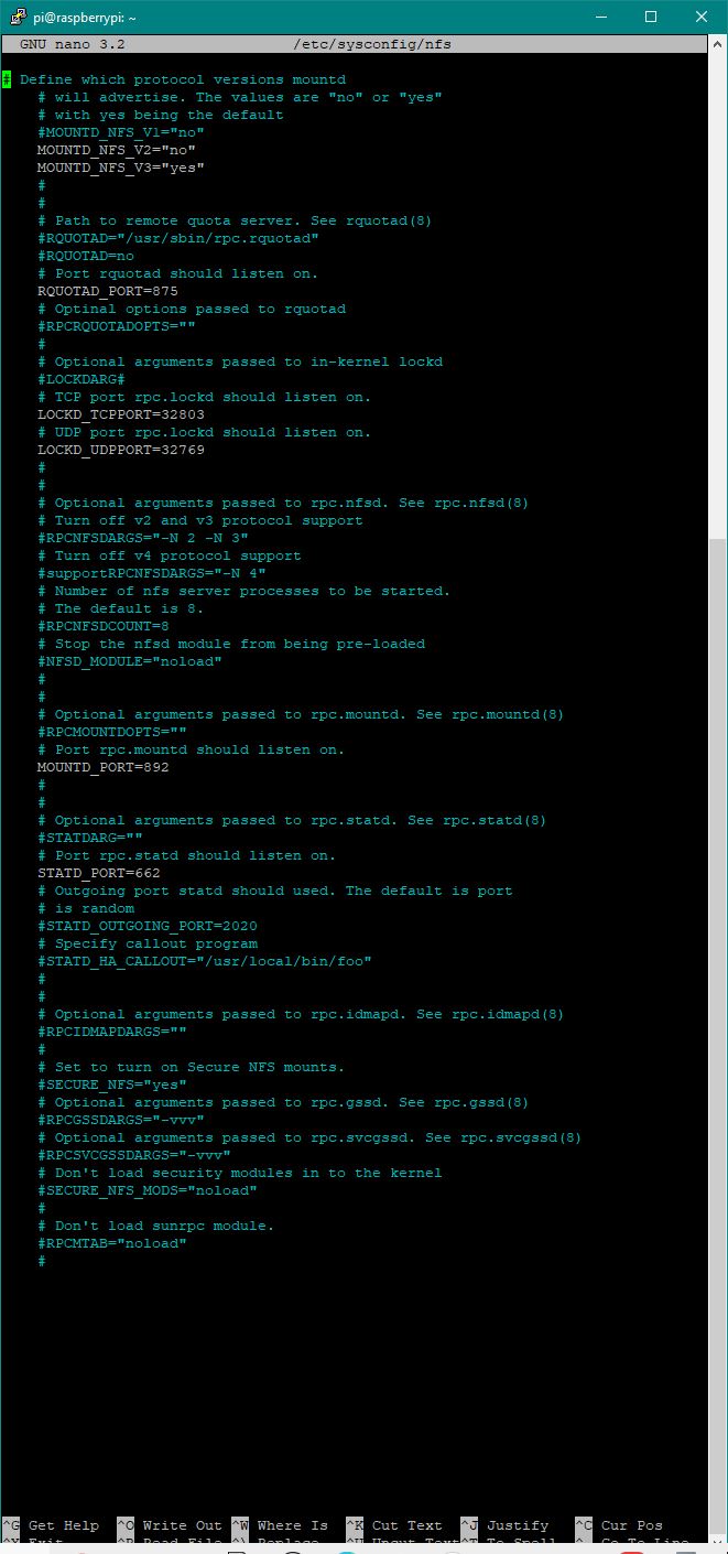

I added the nfs file after googling Raion's suggestion.
/etc/sysconfig/nfs
This is a copy of a sample file I found on the internet with NFS v3 set to yes.

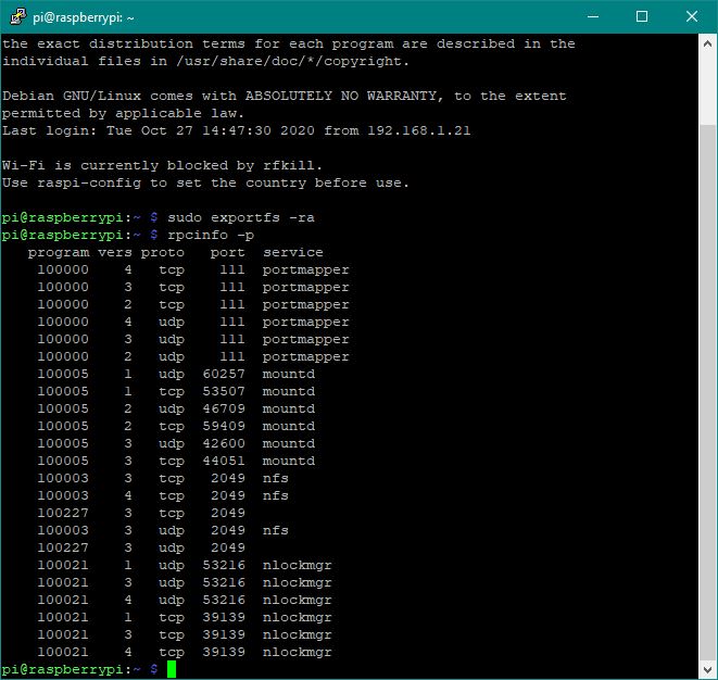

rpcinfo output

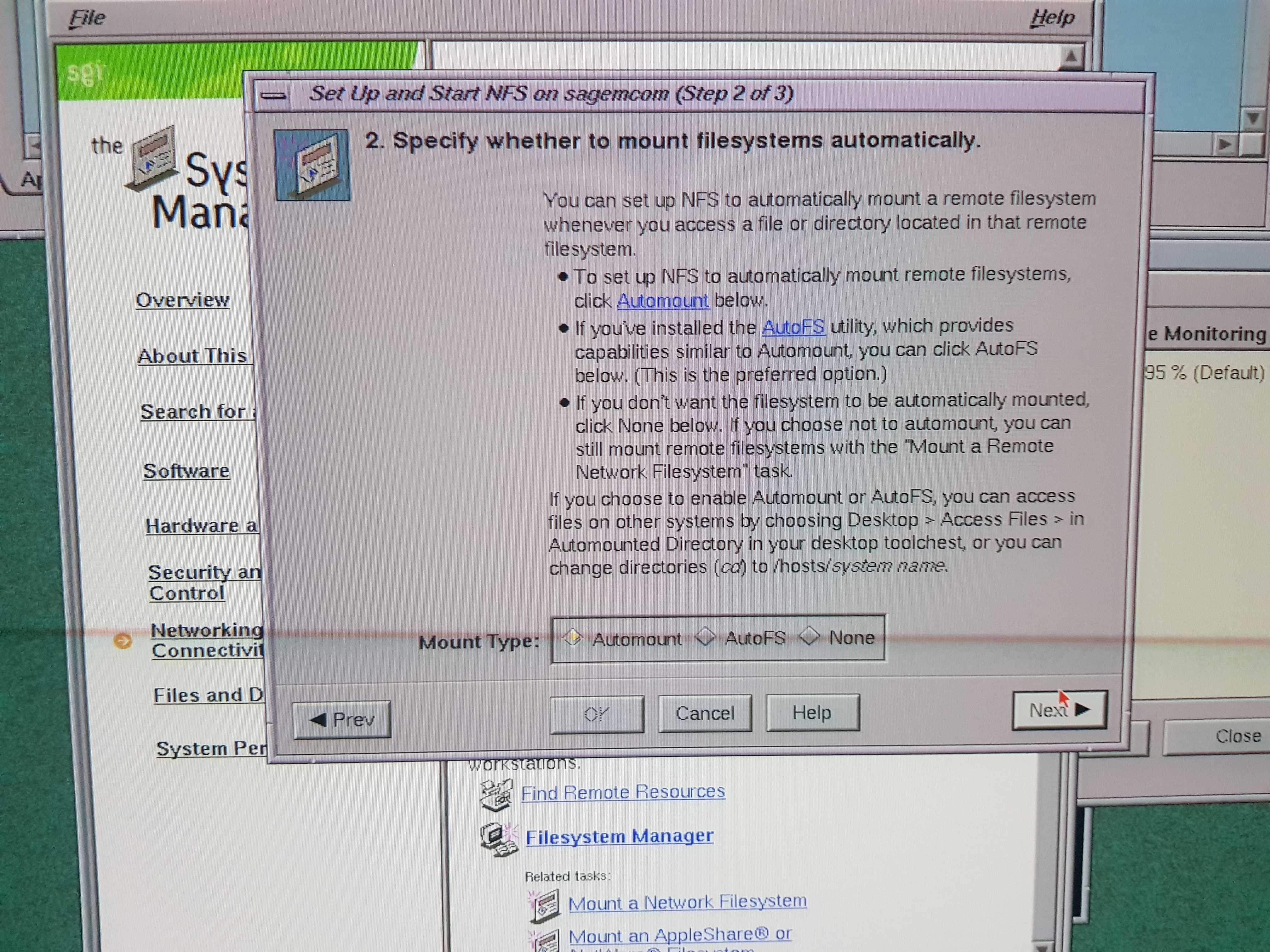

The NFS on IRIX is set to AutoFS (I changed it to AutoFS after taking the below picture):
I don't have much experience with Linux or stuff like this so any help is welcome.
