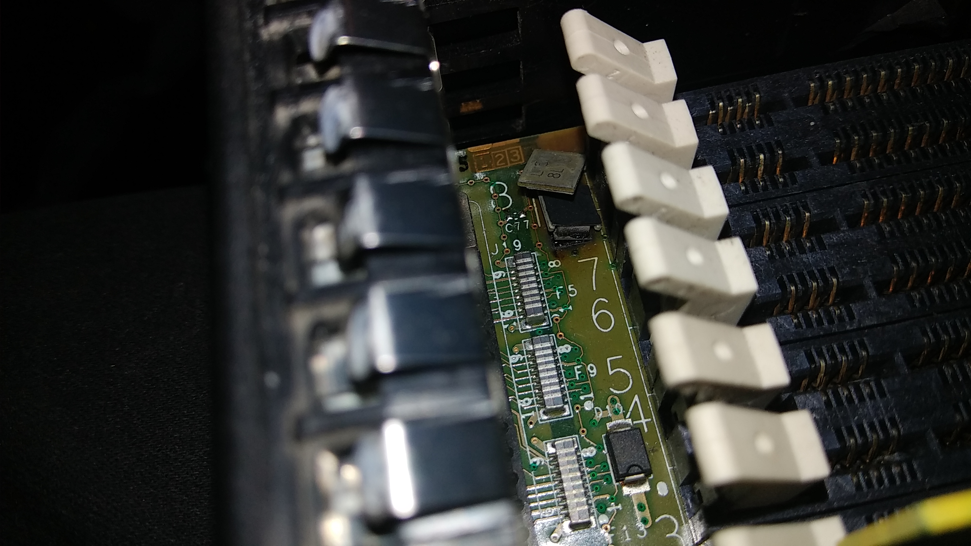

Maybe there was a very big short in the system, leading to an extreme current draw!!! Everything has its limit.
Maybe the motherboard was pulled while the power supply was still energised!!!!! (Plugged in!!!)

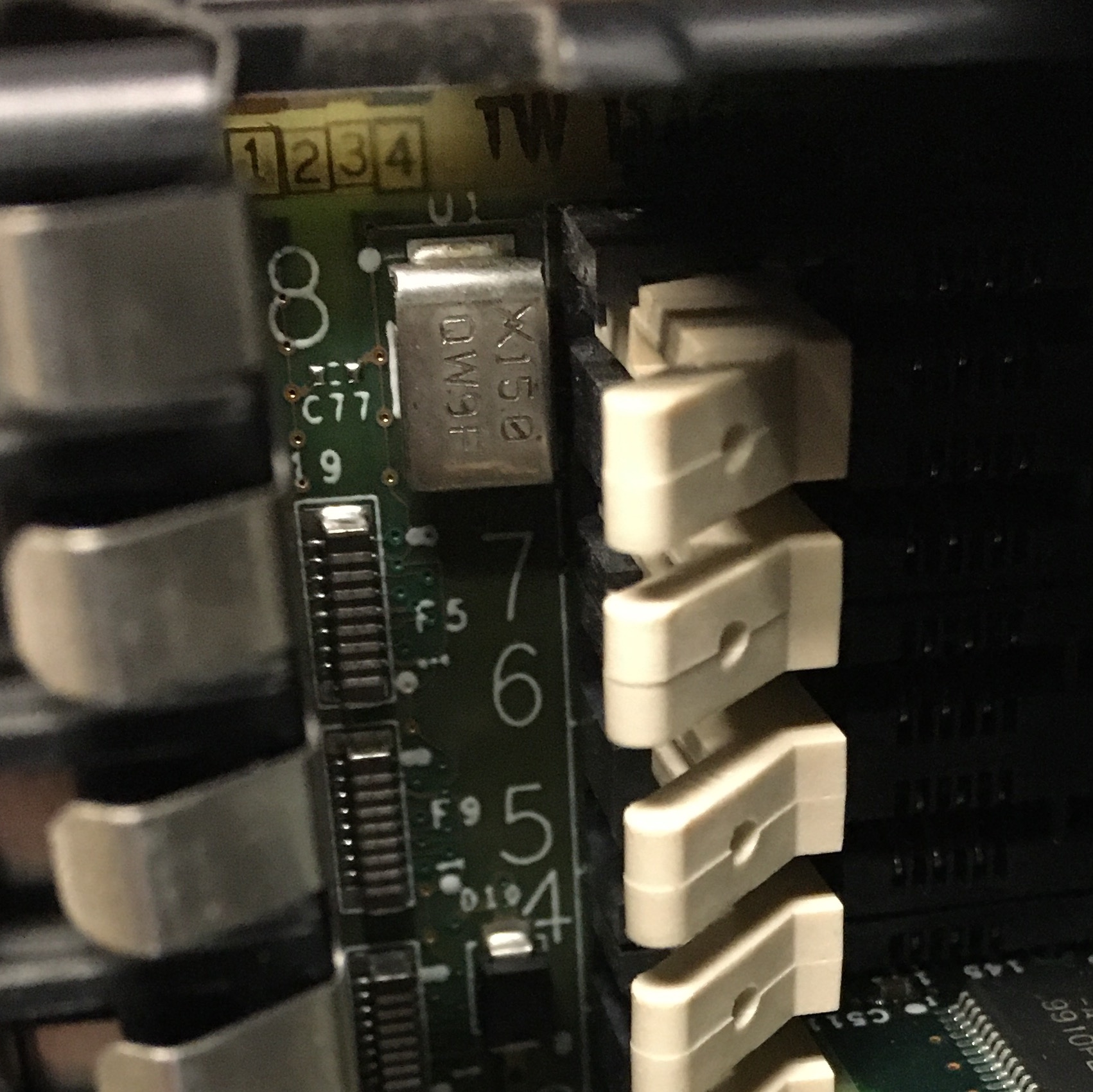

I also see where I misread the label. Looking very close, there are pads for a missing C77...right above the C77, so the actual PPTC label was U1. So that's my first mistake, didn't observe the missing component and assigned the wrong label to the it's neighbor. OK, still haven't yet tracked down a match for this little guy.
OK, I think I found them:
Raychem SMD150-2 POLYSWITCH
Raychem was purchased by TE, the part has been obsoleted (but many are on ebay). This "packaging" of the PPTC is now used for higher voltage parts. This part (in its new form) appears to have been shrunk. Which explains why I've been fighting to find a "modern" version with the same markings. Time has moved on and these specs can be handled by smaller packages. Only large currents need this form factor now.
Buy old stock from eBay to fit the foot print. Parts are from the very early 2000's and very cheap.
Serena,
Could you tell use what peripherals you plugged in when you powered it up?  Like exactly what you plugged in, model info if possible.  It seems these fuses are often sold to protect IO ports and telecom interfaces.  I assume you plugged in a normal Sync-On-Green VGA monitor.  What else, did you happen to use any kind of adapters?  The O2 is a PS/2 system.  Did you have some kind of USB -> PS/2 converter.  Did you plug in Ethernet?  What about external SCSI?
I'm trying to see if there was anything unusual about what was plugged in that might explain this.  If you're handy with a soldering iron, I'd buy some of these Raychem SMD150-2 parts on eBay and after removing the bad one, do a quick Diode check for a short on the pads to GRND and around a bit.  But perhaps something that was plugged in overdrew the fuse? At about room temp this datasheet claims it hold between 1A~1.75A before tripping. This was a lot more, but since it's unknown if it came to you this way, maybe you did nothing and received damaged goods.
If there is no way to return it and you'd like to move forward, trying doing the replacement and see what happens.  Let us know if you decide to remove, test, and install the replacement part.
