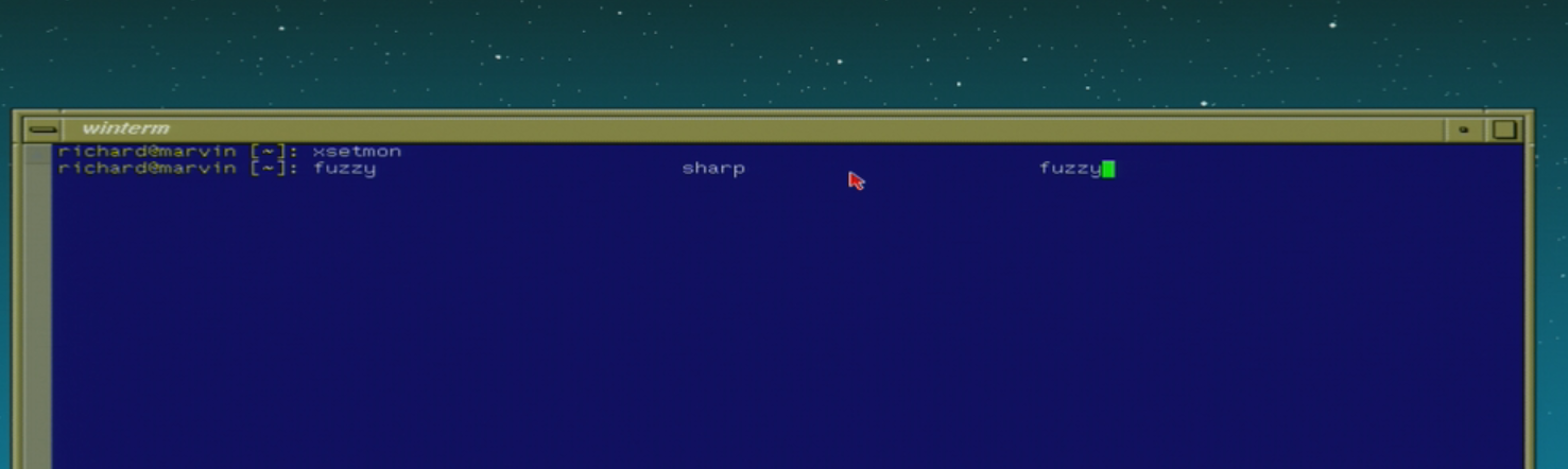

Dear Experts,
I have an O2 here and am running it with the following cabling: O2 <-> VGA <-> HDMI SCALER <-> HDMI (ASUS MX34V)
I have tried a direct VGA into a 24" Viewsonic LCD with the same results. For the screenshot I took here I connected the SCALER into an Elgato CamLink USB adaptor. In all cases the outcome is the same, the O2 desktop shows with bands of greyed out colors and fuzzy resolution followed by a clear and crisp band in the middle of the screen. I've tried 640x480, 800x600, 1024x768 and 1280x1024 plus a couple of other resolutions made using custom vfo files I made and also some I downloaded.
I did ask my local Oracle (@mapesdhs) and he has suggested that the analogue VGA is most likely the issue and I'm not disputing this I am just wondering if the community has seen similar issues and created any sort of workout or mitigation for something that gives me eye strain! I hope you can see the difference on the terminal. When I load of applications it's not obvious, it just looks washed out.
What do you reckon?

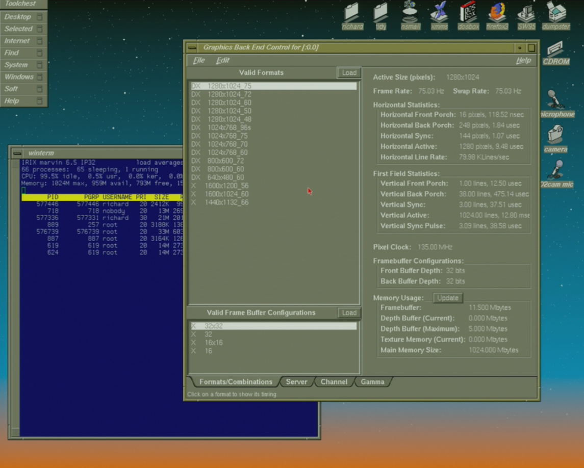

In case anyone is interested I'll push up my findings but honestly I didn't get a total closure. I figure it's as good as I can get it after much messing around,  an expert may get a better result. The main thing I tried differently was setting 'AUTO TUNE' under the FINETUNE menu option. This seems to scan the input signal and do some funky stuff. When I start it the first time it looks like waves of pulsing grey/white until it settles down. The H and V sync options just centered the image on the screen and did nothing to the actual clarity.
I did also set manual options earlier in testing which worked the same (as the auto) but I figured AUTO TUNE means whatever I might put in should work the same. For anyone who is interested the actual options are arbitrary and don't seem to correlate with any hard numbers I've found related to the CRM output from the O2. I also tried a couple of custom resolutions (https://github.com/ccg/irix-video-modes) but by far the tightest and cleanest seems to be 1280x1024_75Hz. None to the other frequency options gave a good result, they were all washed out or hazy, even the 60Hz which was interesting.

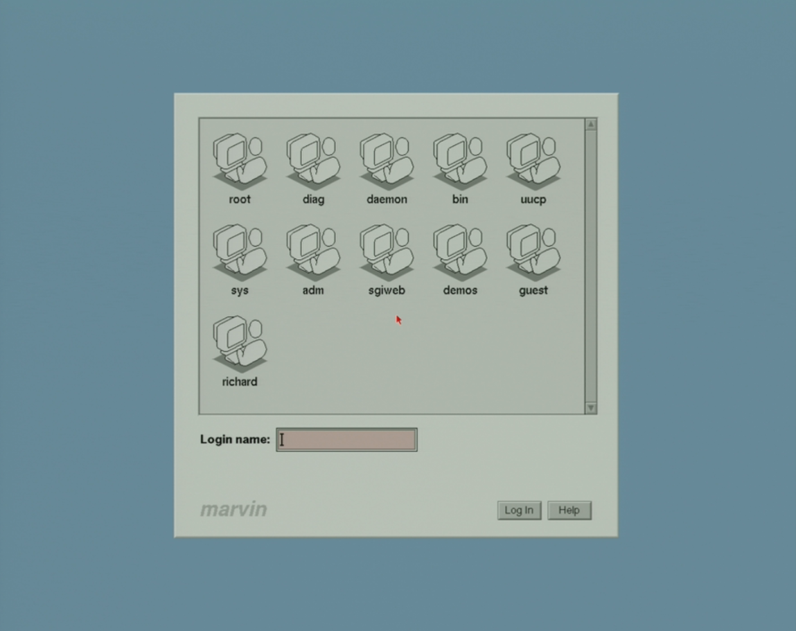

LOGIN SCREEN
winterm and xsetmon
KRAMER SCALER MAIN MENU (note 1080P60)
KRAMER SCALER FINETUNE OPTION
Maybe it'll help anyone out there.
