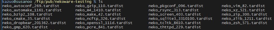

Spy snapshot of completed tardists. More to come.
