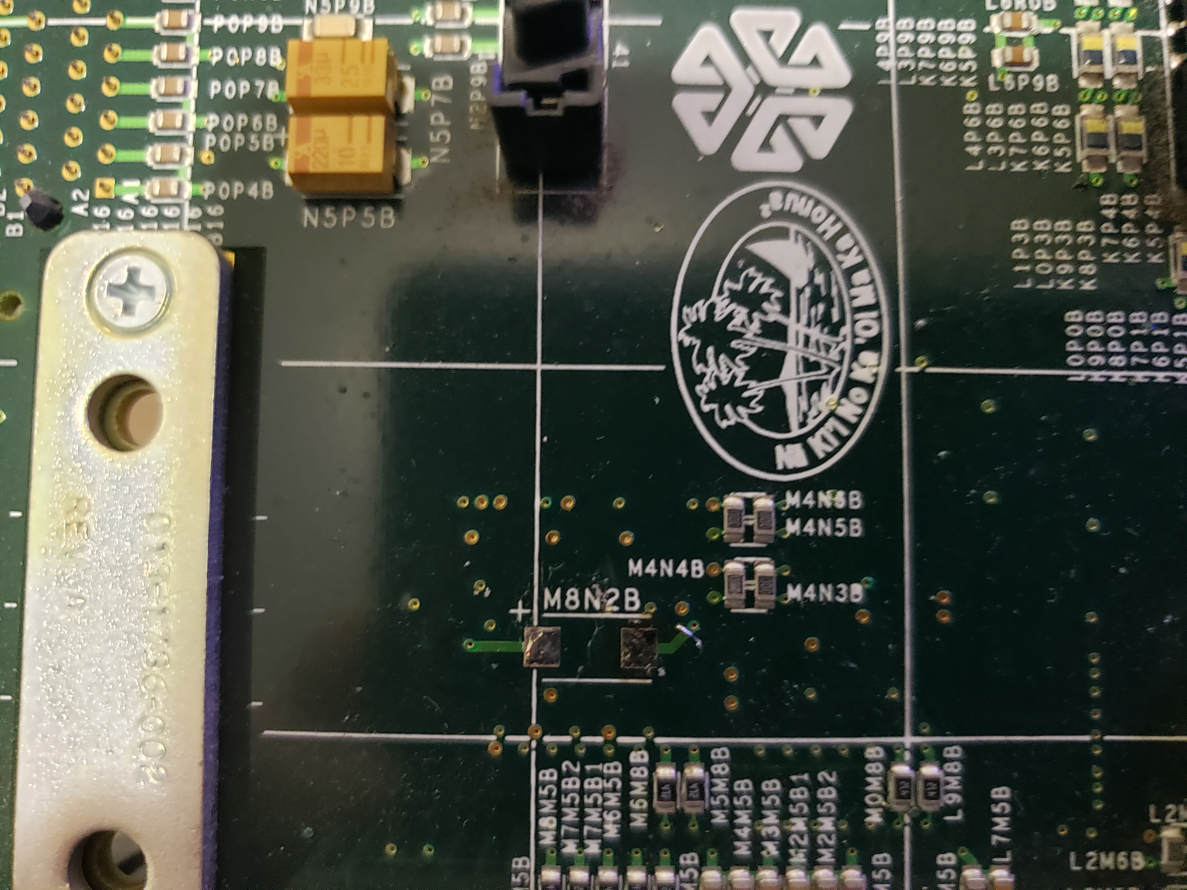

RE: Onyx2 Deskside Midplane Capacitor/Resistor Identification
(09-04-2019, 08:27 PM)kaigan Wrote:  I don't mean to be a pest about it, but are we certain that M8N2B (in my first reply after Jan-Jaap and Weblacky posted) isn't supposed to be populated? Unlike the other unpopulated spots, I'm getting continuity on my multimeter between the pads. The positive side appears to be connected to ground as of now, unlike the others as well. Could it be a missing coupling cap like Weblacky mentioned as a possibility?
Excuses, I overlooked that one. Anyway, this one was *not* empty:
09-04-2019, 08:58 PM
#13
(09-04-2019, 08:58 PM)jan-jaap Wrote:  Excuses, I overlooked that one. Anyway, this one was *not* empty:
No worries at all! Again, I really appreciate your assistance. As I mentioned, these pads seemed a little different (physically and electrically), and it must have just been a clean break from the board. I didn't see anything down in the fan assembly, but maybe it's still hiding in the chassis somewhere.
I'll get it replaced and then run some diagnostics to see if we're still running into errors.
Thanks again!
Good spotting! If one side (pad) is definitely ground (very very low, or zero, ohms reading to ground), then it's a missing decoupling tantalum capacitor (or similar mechanism designed to take out voltage ramp-up and ringing out of a signal). It could could be as simple as that, some advice, buy a couple...shipping is often more than the part...so make it worth your time.
While I have no idea what part of the circuit that is, I have heard that ringing or "dirty" signals from lack of decoupling capacitors can definitely prevent ICs from starting or getting good signal and causing issues. So very much worth trying.
So well spotted, I'm sure you'll keep us up to date.
