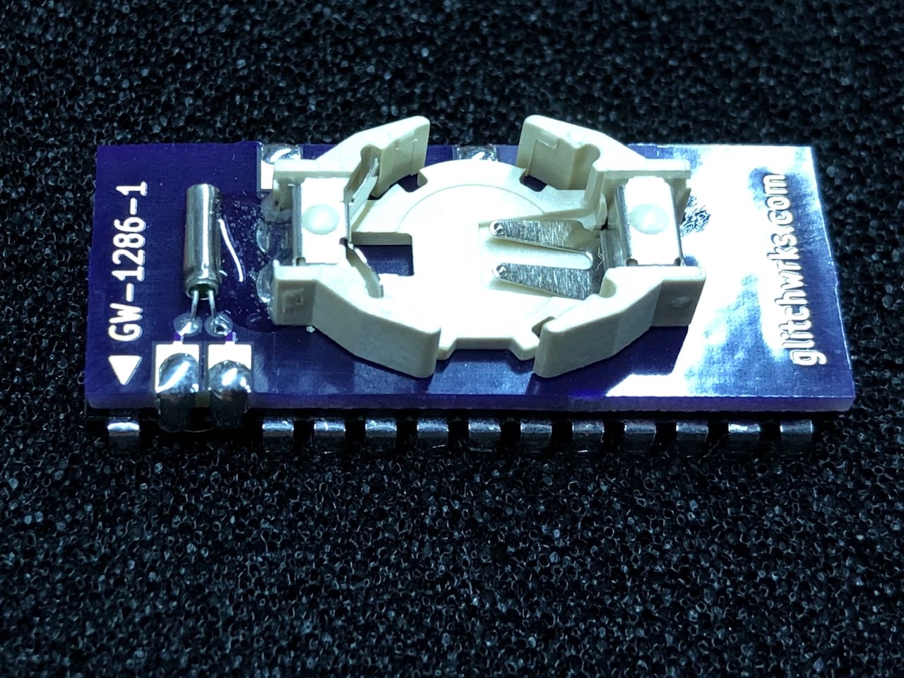

I've been in touch with Glitch who can produce Dallas DS1687-5 RTC replacements for the SGI Octane & O2 as they both use the same RTC. They are a custom pcb with a replacement coin cell lithium battery that fits in to the Dallas socket on the main board. Here is an example from the website: http://www.glitchwrks.com/2018/03/17/gw-1244-1
I am gathering data on how many people would like to order, I am not sure on the price yet but will update the thread when I have this information.

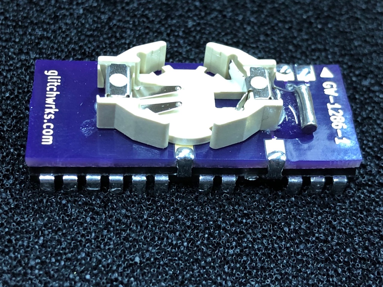

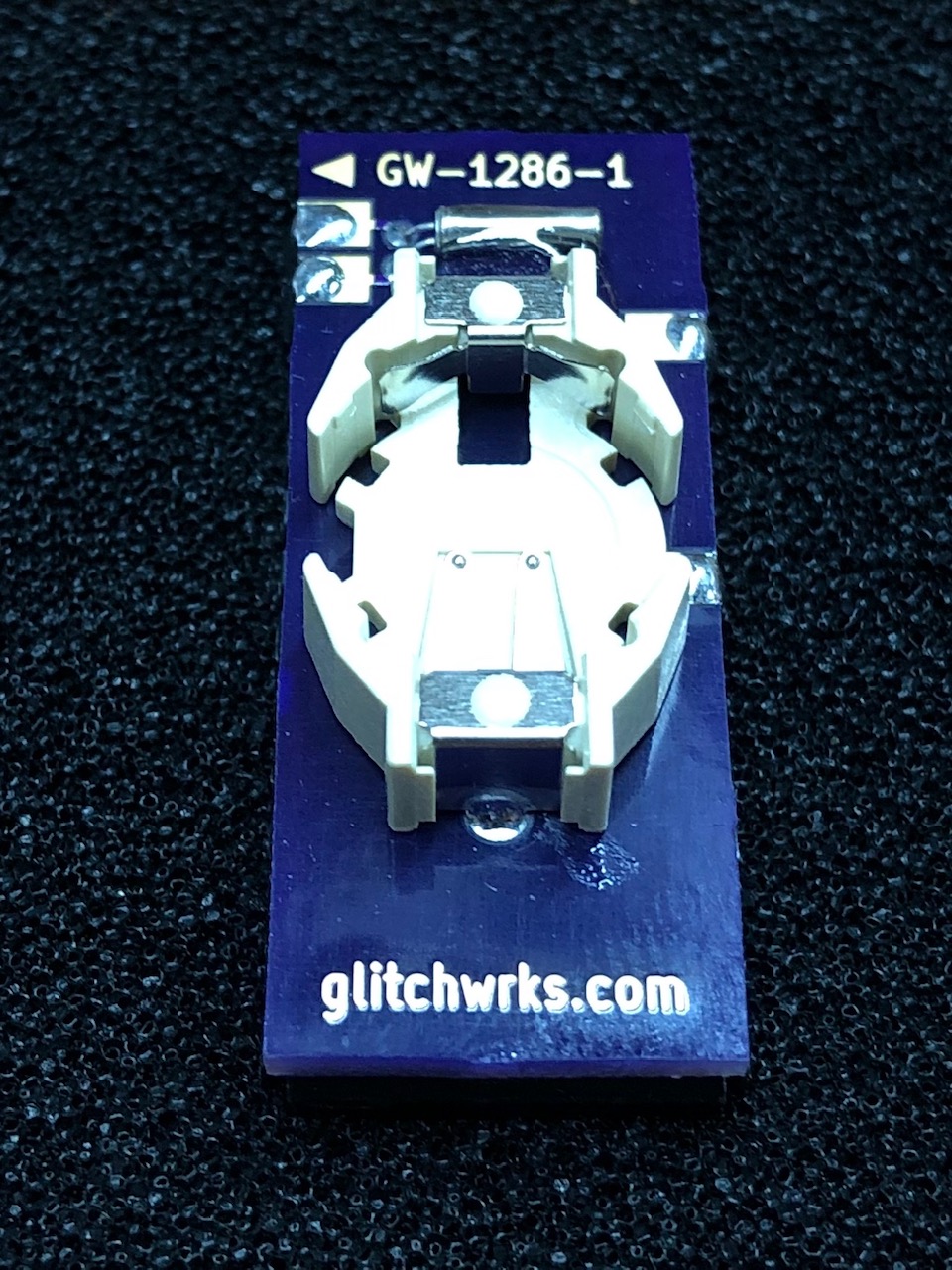

Josh, check out this module he put together for my Indigo2. His work is super clean. I agree, you can just drill out the existing module and tweak it with a coin cell, but check these photos out -- when this is installed in my I2, it's going to look super. Additionally, with the lower profile, should the module need to be removed, you don't need to pull out the entire riser assembly. (In an Indigo2)
Stormy, might be in need of a module for an O2 -- waiting for her to land !
