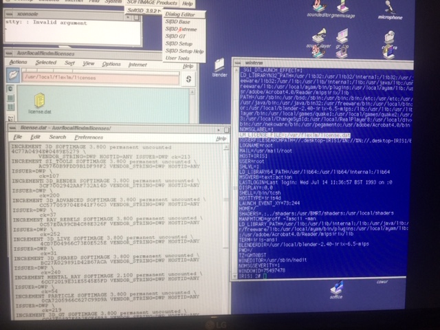

place the softimage.lic on /usr/local/flexlm/licenses but I had to create the folders flexlm/licenses because did not exist in the local folder. But it did not work when I clicked Softimage3D Extreme the console left a message that said "ssty:: invalid argument".

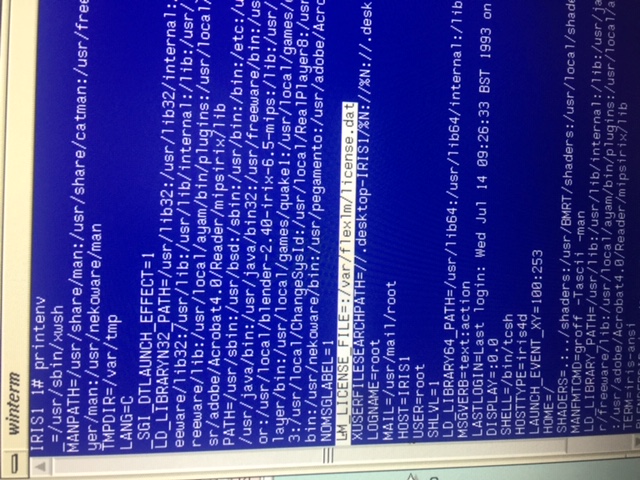

Then I wrote printenv in the unix shell and it showed me an environment variable LM_LICENSE_FILE =: / var / flexlm / license.dat I think the person that  set up my Hard drive wrote that environment variable  and I do not know if this is affecting that Softimage3D does not work.
How can I solve this problem?

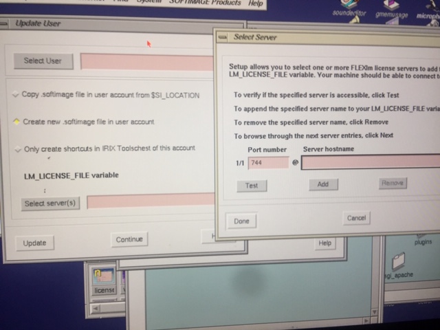

It still does not work for me, I do not know if the environment variable LM_LICENSE_FILE is harming the start of SI3D, this image shows what is configured.

A bit of a necropost but I just went through this exact issue and wanted to add how I was able to resolve it (at this point).
SI doesn’t seem to want to load in root mode. I’m still looking at the .cshrc and .login files associated with SI to see what needs to be changed to allow for root access.
In the meantime, run SI under a user account (be sure to add the account using “User Tools”). I’ve found no issues so far.
