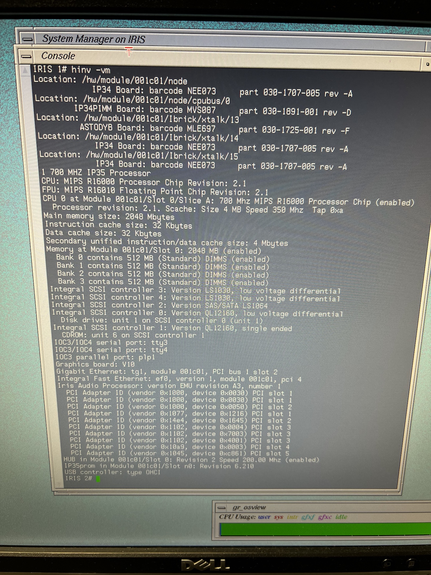

I know I said I was done...but nagging issues kept me at bay here.  Right now I only need to go and get a right-angled SATA cable for the secondary HDD to test the new 1064 LSI controller in it...everything else has NOW BEEN Resolved.  There was one anomaly that happened once, I'll show that...otherwise...smooth sailing.
So big news. The original V10 seems to work!!!  I wrestled the replacement V10 out and placed the V10 that came with it that I replaced the DS1780 IC in and shorted that XIO Bias 12V short out on it (still never found the shorted I shorted out).

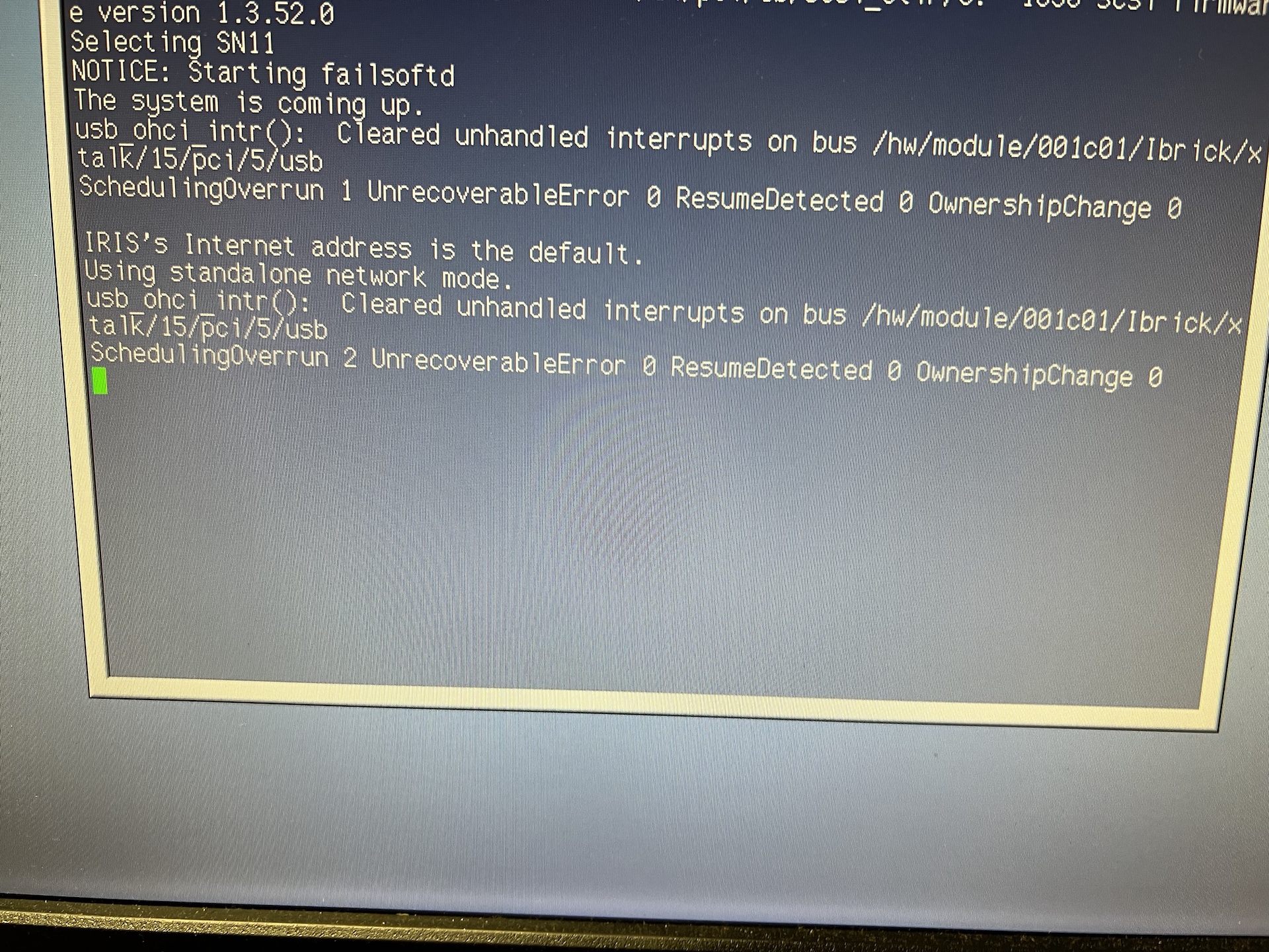

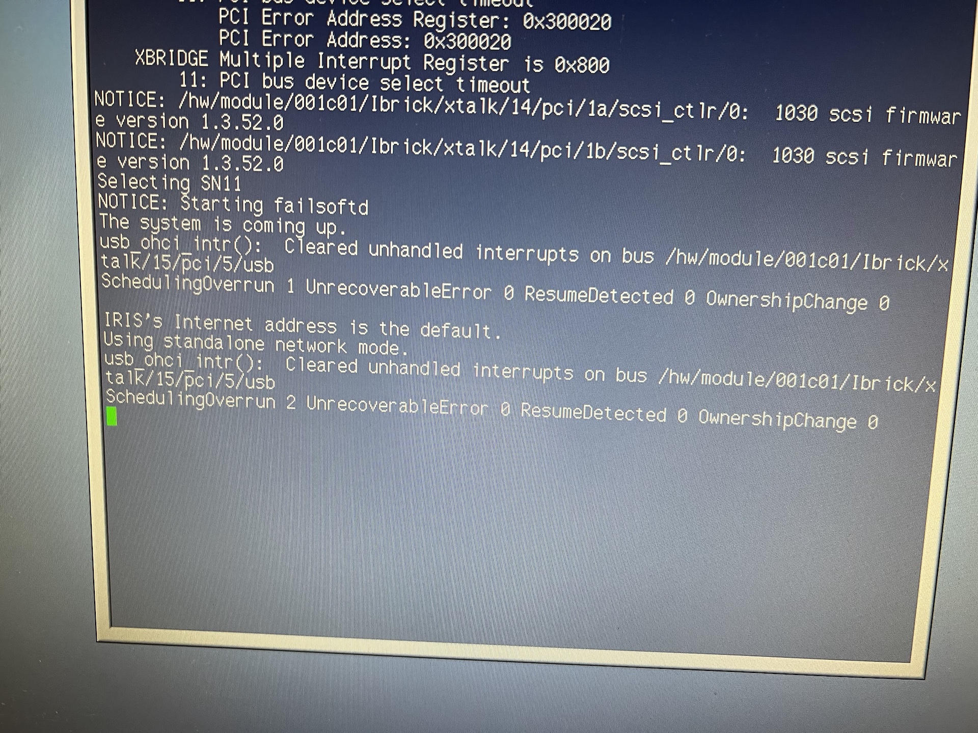

Now the anomaly, the first time I booted I was greeted with a USB_OHCI_INTR unhandled interrupt errors several times (booting and shutdown console):
But I then swapped in the NEW V10, no USB error, swapped back the repaired V10...no errors...shutdown and cold started twice with repaired V10 (after inserting new SATA controller.)...no USB errors...so I have no idea what happened there...but it's only happened once.
I had NOTHING in the USB ports so...don't know.  RAM is still holding fine at 2GB.

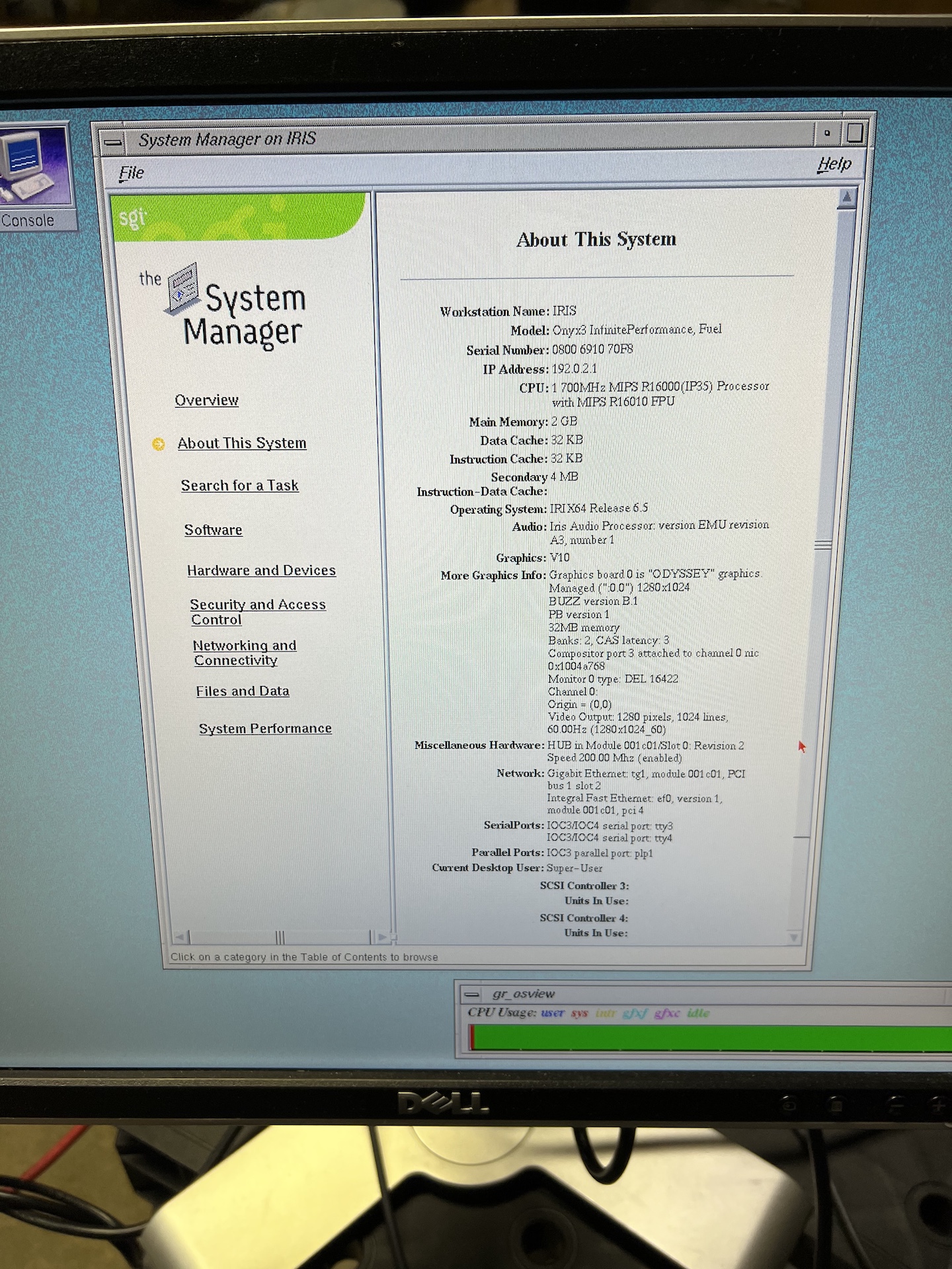

So that's a HUGE item, picture appears everytime I boot, recognizes the correct graphics specs...so for the time being..I'm declaring it working unless I see otherwise.  I'll keep the V10 I bought for troubleshooting since I have Tezros and it can be used in those for any reason.

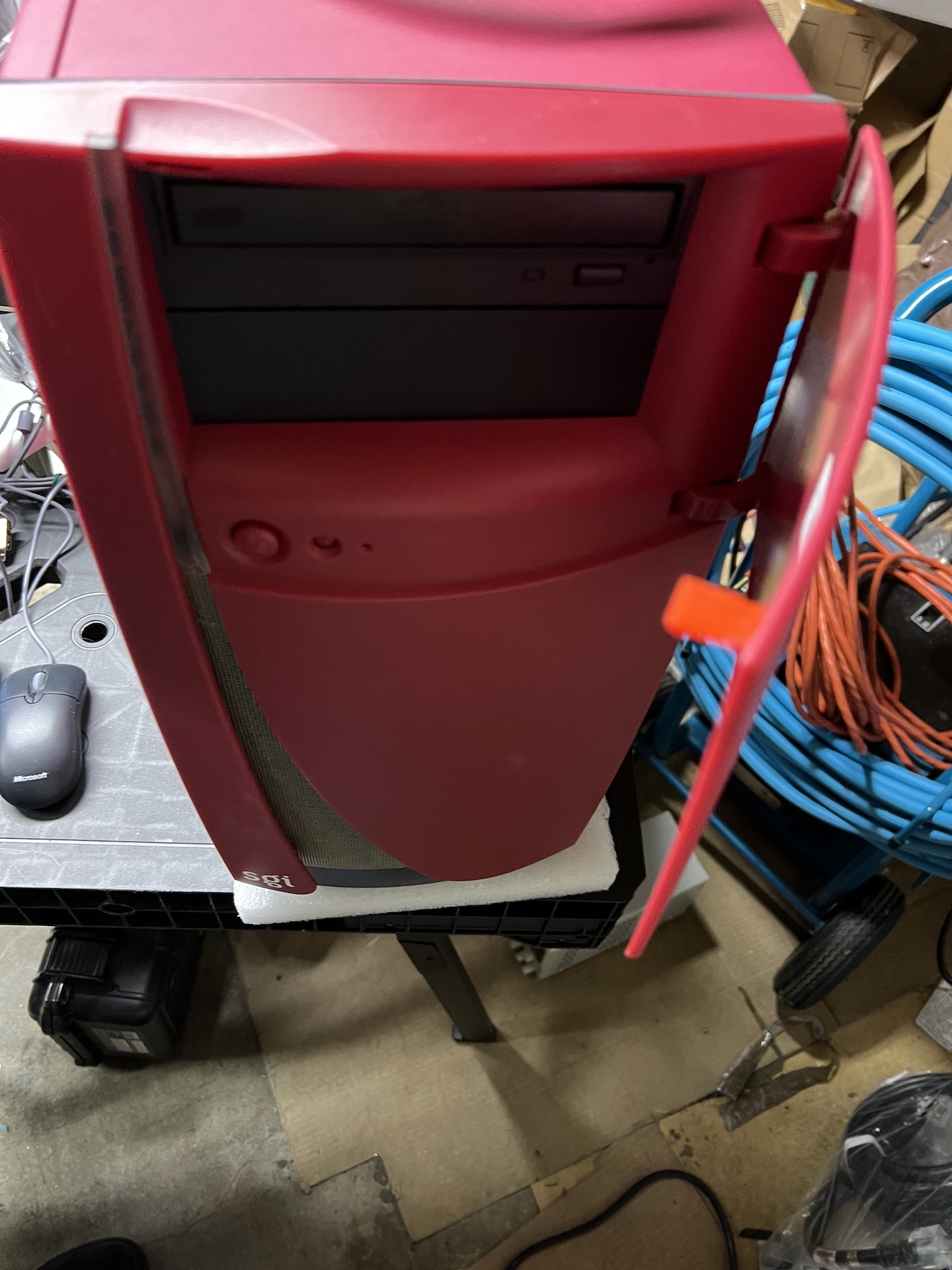

I also placed the plastic face on and with the new latch, things work fine.

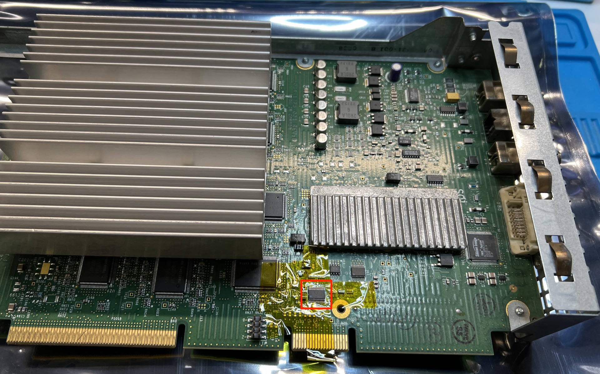

While I won't say all V10/12 cards can be repaired so easily, if any of you have Fuel/Tezro style XIO Graphics card that prevents booting.  You can easily get the DS1780 Datasheet and check for a short (using a multimeter in DIODE mode) between the sensor inputs (12v, 5v, 3.3v, etc...) and the GNDA and GNDD pins.  Also check between VCC and GNDA & GNDD.  I found basic shorts here.  The symptoms I saw was the L1 was missing nearly all acknowledgements for nodes and/or you're missing ALL the XIO ENV values.  If you get the first L1 symptom (missing acknowledgements for nearly ALL nodes) then just shutdown (remove power) and remove your Graphics card, then hook a serial terminal to your L1 port, get terminal working, then apply power to system (it will NOT be able to auto-power due to missing graphics) but check if the flood of "no acknowledgement from node" errors is now a trickle (nowhere near the amount you used to have).  Then do an ENV, if you have PSU 3.3v and 5V AND PIMM voltage...then your problem WAS/IS your DS1780 on your graphics card (at a minimum).  As you may know all the DS1780 ICs share a communication bus, a shorted IC will drag the entire bus down and none of them are able to talk, remove the shorted IC and they can talk again.
However that doesn't mean what they say is valid...you still may have DS1780 ICs that are misreporting (that still need change out) but at least they aren't disrupting the entire ENV bus.  So that's an easy way of isolating your ENV and graphics issue without buying parts/tools.
If you find this to be the case, I offer a DS1780 replacement service, and I can do a basic short check.  If you want an actual test on a system...that will cost extra (risk and all).  But the DS1780 is an easy way to do a non-invasive short test on these cards and give you more info.  I've not seen more samples so I don't know if this is unique or a trend.  Either way...it's free advice.  Check your DS1780 on your "dead" Fuel/Tezro graphics and look at the your ENV values with the card installed (offline L1, not auto-powered) and then removed.
For the V10, the DS1780 IC is here (highlighted in red).
