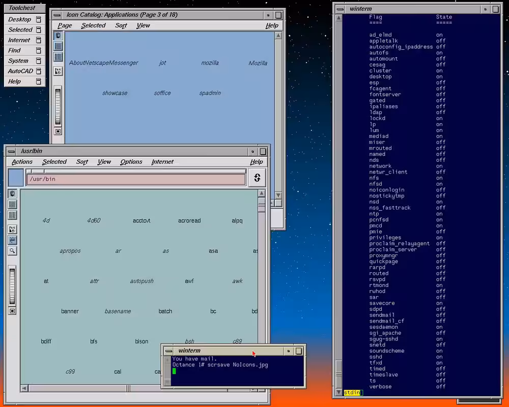

Hi,
today I received an HD Sled which I bought on ebay. The Sled contained a 4GB Disk which I would not use … but I was curious and it contained data. According to the filenames it must be some CAD-Files. The easiest way for me was to just give it a try with AutoCAD R13 … I used the Software Installer and the install process went through flawlessly. acad did not start becaused "libcommand.su" was missing … I turned my Octane off … few hours later I fired it up again and  Scream
The Desktop has no Dumpster and no other Icons. I opened a file window: The Filename where present, but no icons …
Does anyone know what went wrong and how I can fix it?

During installation I was indeed logged in as root. But the icons are not only removed from desktop, they are gone from the whole UI. A file window only show the file name and it's not possible to open any file, neither with mouse nor with keyboard shortcut.

I recently experienced this, and for me the fix involved re-setting these chkconfig options:
chkconfig desktop should be on
chkconfig mediad should be on
chkconfig autofs should be on
chkconfig soundscheme should be on
After rebooting, the desktop was back.

@vishnu the reason autocad did not start was a missing lib … I managed to view the files in a different way.
@m626
all of those are set to 'on'
I attached a screenshot so you can see how the UI looks now.
The weird thing is, when I open a shell window and i.e. change to the Desktop folder, the links to dumpser and home folder are present. It's just like the Icon-Files it self are missing.
