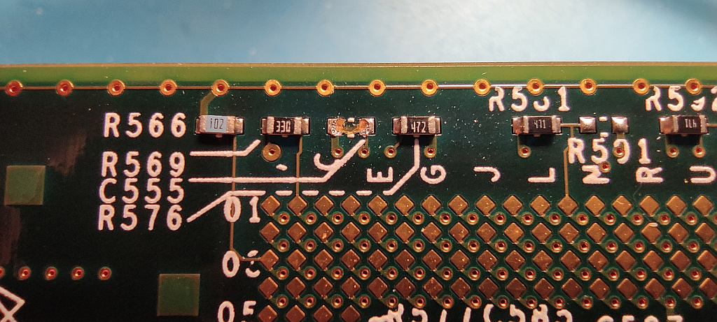

I am working on the repair of my O2+, I found out that a few components "fell" from the cpu board ... strange stuff, the machine seems otherwise quite clean. See picture :
[Image: Lost-capacitor.png]
I already replaced C636 which was also missing, copied the value (1.2 uF) from neighbor C689, which I hope is right.
I need to replace that C555, how can I get its value ? Is there any schematics of that CPU board ? Or could somebody that owns the same CPU board have a quick look and tell me what is C555 ?
Am I the only one with that strange issue ? Already capacitors went MIA in my board ...
Thanks a lot !

RE: O2+ R12k 400Mhz board schematics/BOM or component value? - Jacques - 03-07-2022
(03-07-2022, 10:38 AM)schlika Wrote:  OK, thanks, at least I am not the only one. OK, I guess I can try putting another 1.2uF capacitor in C555 ? Glad I ordered a few.
It seems only capacitor fall from the board, no resistor ? And I guess no schematics available ?
I don’t think it’s a 102?
hopefully the link below works…
https://flic.kr/p/28TJ4aN
RE: O2+ R12k 400Mhz board schematics/BOM or component value? - schlika - 03-09-2022
Thanks for the pic ! C555 seriously looks like a capacitor, not a resistor  Wink If anybody has a clue of its value ? Or would anybody have a "for parts" r10k/r12k cpu board ready to exchange with Swiss chocolate ?
