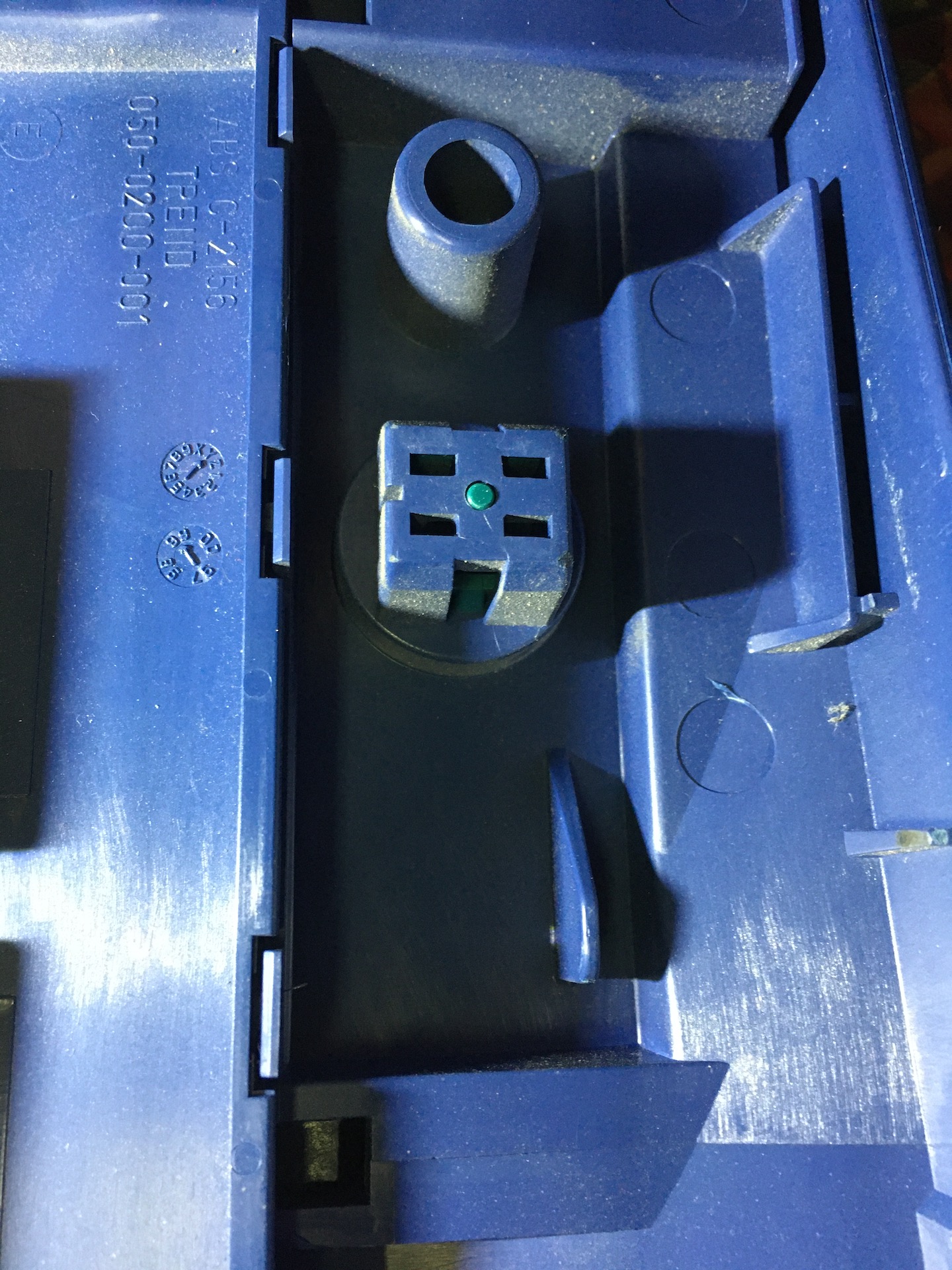

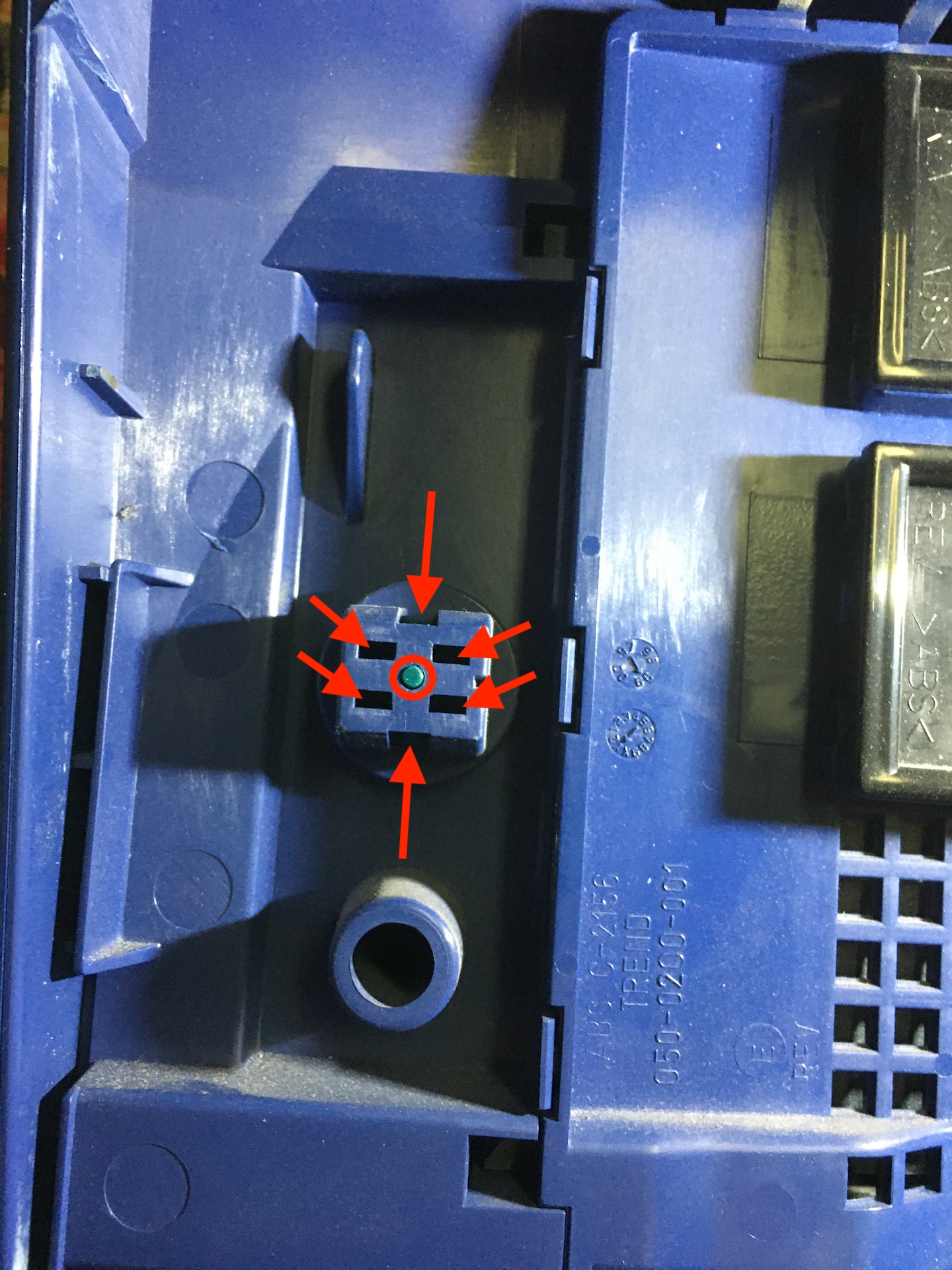

Take the front Octane panel off and look at the rear of the power button.  There are several legs and holes.  Use quick squirts, small amounts, in all the holes, I used more in the two large openings (larger arrows).

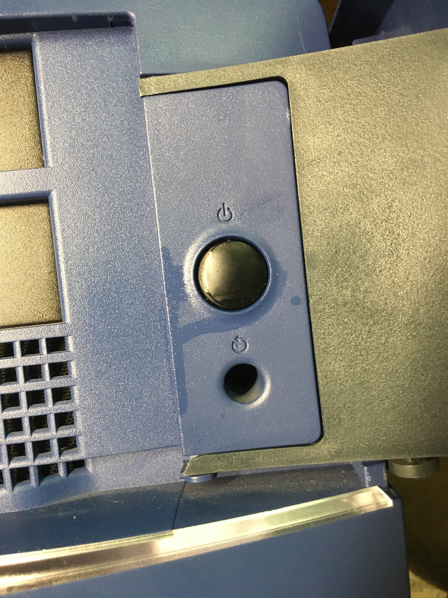

Watch the front for leakage and clean up with IPA (pic before clean-up).
