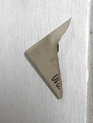

This time I heard a loud 'pop' and the module started to smell. More attempts to start module failed. So I removed the psu from the module and noticed that the smell came from the psu. One small piece of ceramic also fell out of a hole when I shook the psu.
Probably a piece of the component that popped.

Unfortunately the piece that came out of my psu is white and square, but maybe a varistor can be any shape.
[Image: 20181007_132642.jpg]

That looks like part of the casing of a ceramic power resistor.
