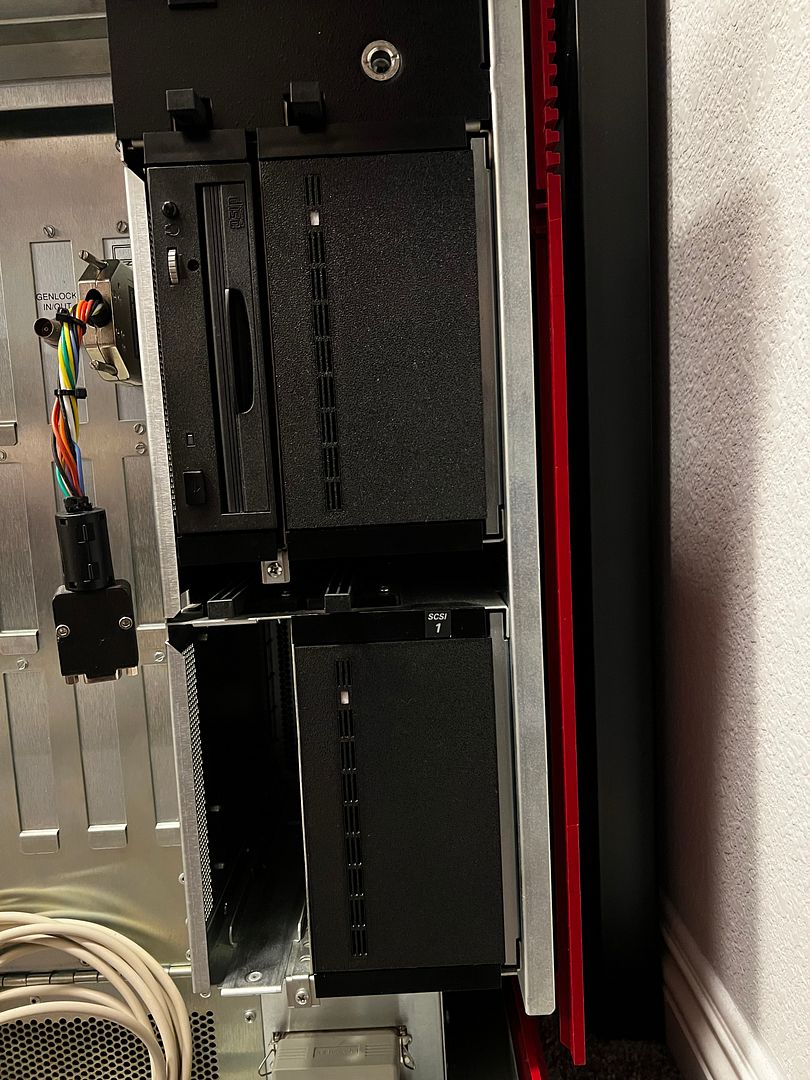

IRIX 4.0.5 installed smoothly and with the speed expected of a standard SCSI drive (though it may have been a bit faster). The ZuluSCSI team has done a great job of iterating and improving on their design. They’ve released a good number of firmware updates and have managed to meet the specs for SCSI-2 transfer speeds. That being said, random reads will always be a bit slower than a traditional SCSI drive due to how SCSI-SD is implemented, but for this era of machine you’re not really going to notice that if at all. My anecdotal observation without running diskperf is that ZuluSCSI runs a bit faster than original hardware.

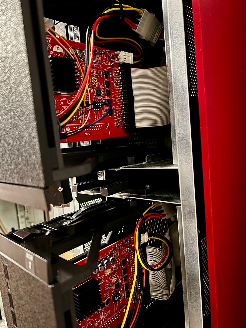

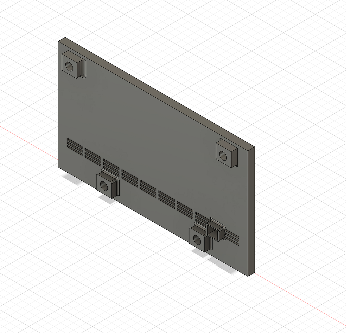

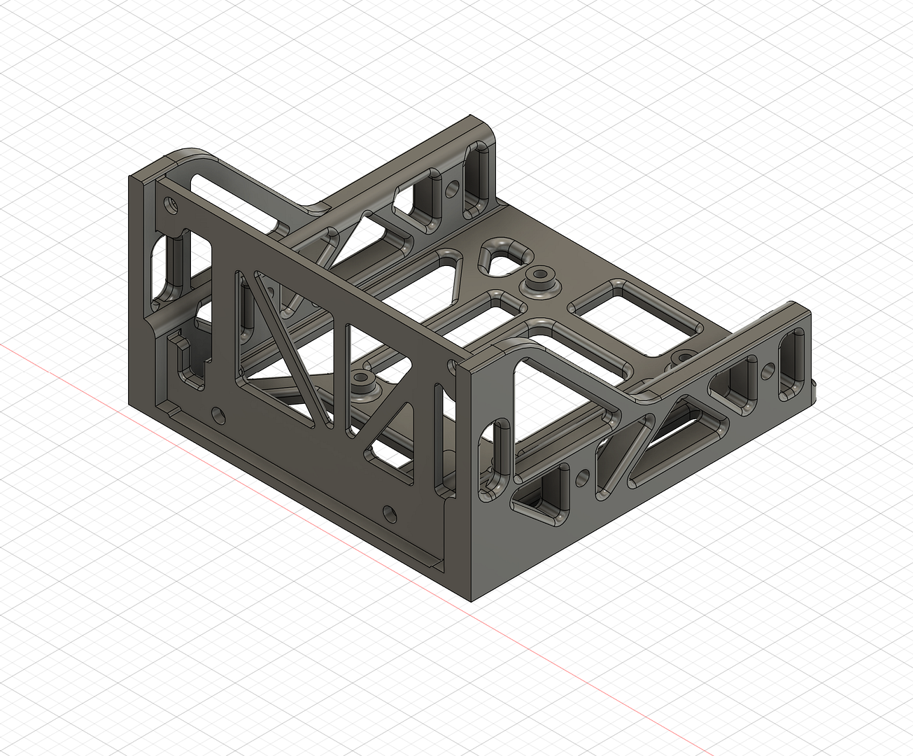

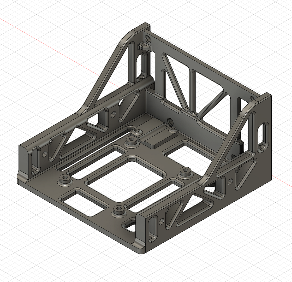

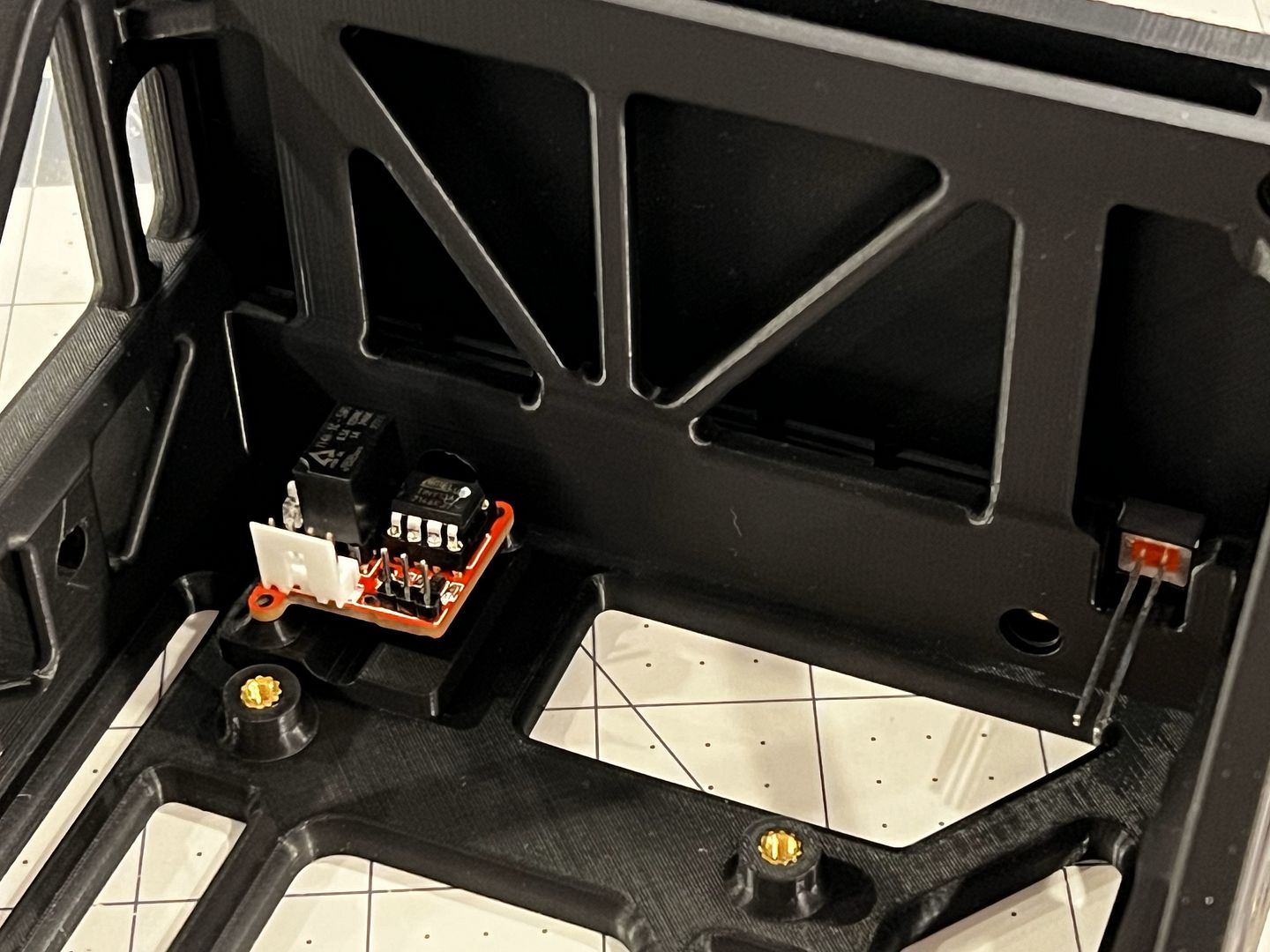

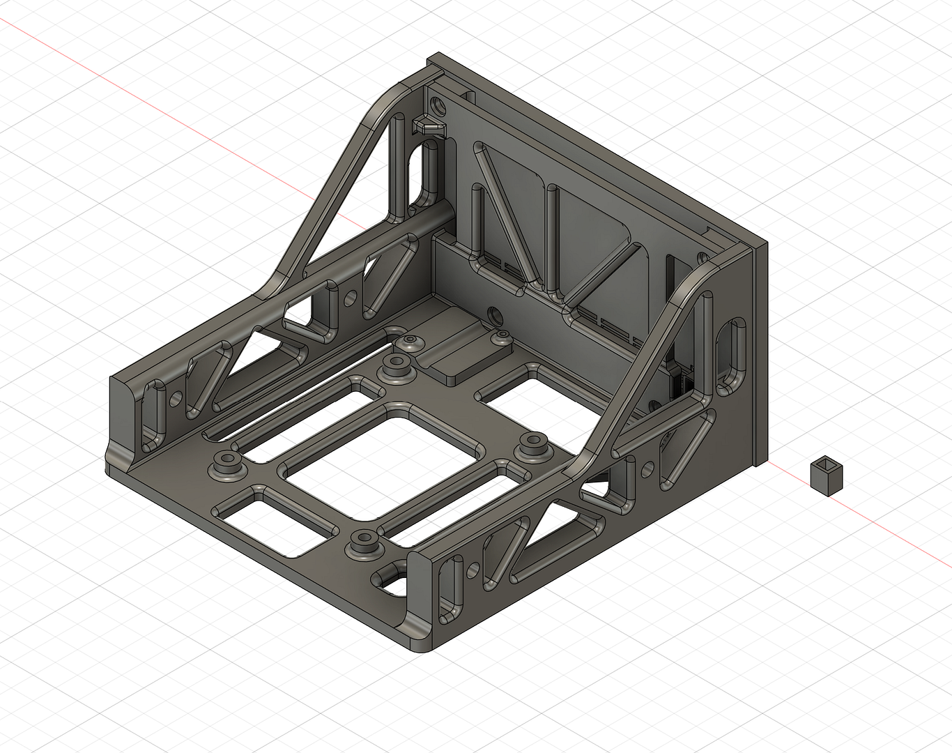

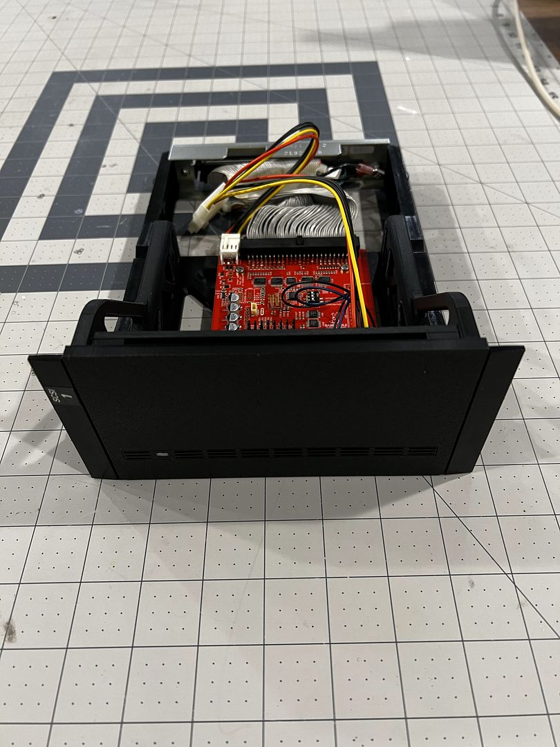

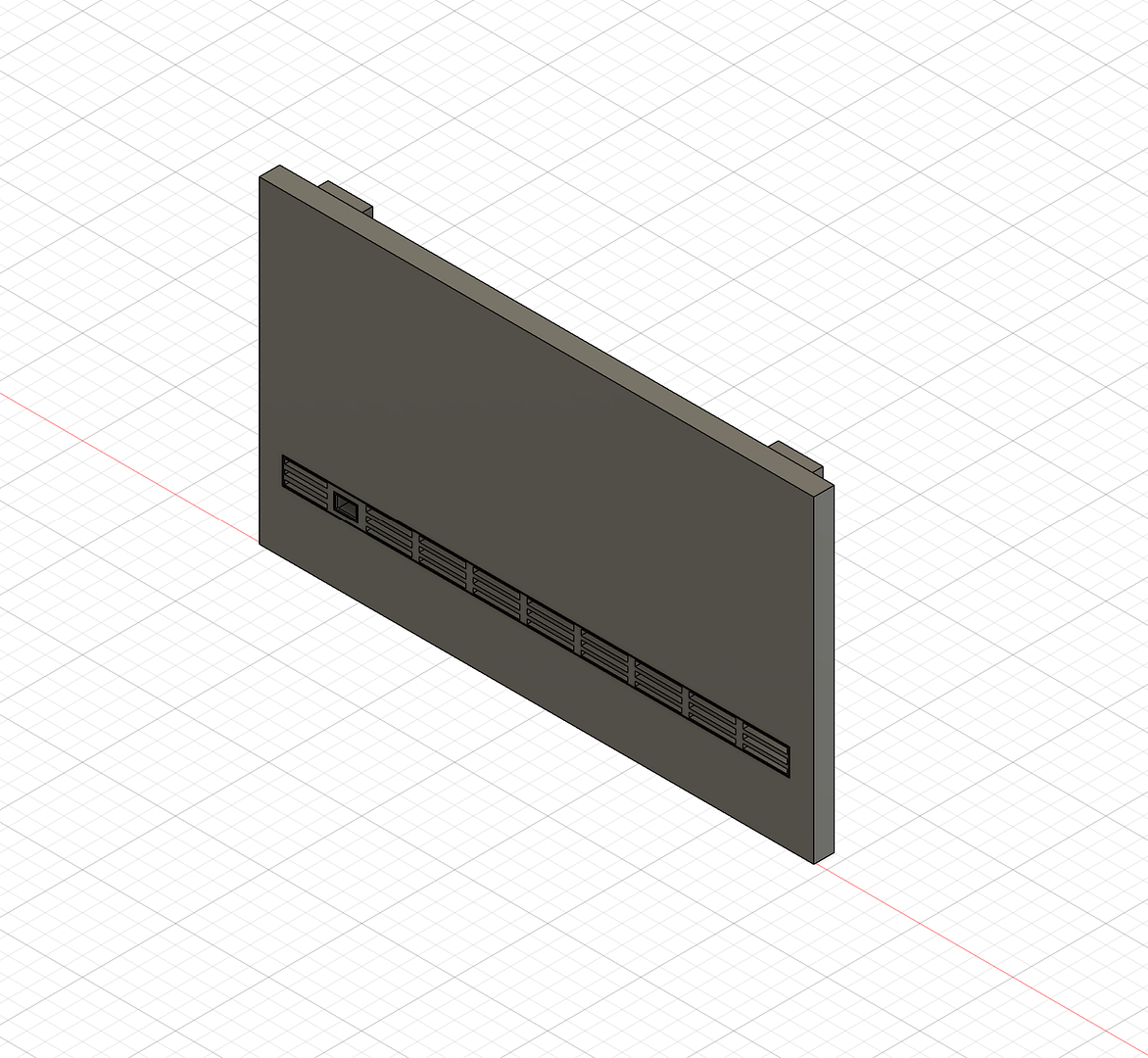

With the testing successful and IRIX running snappily, I moved onto designing a sled that would hold the ZuluSCSI and look the part of a FH hard disk. I also spent some time digging into any options that may exist for adding an appropriate clicking sound that would emulate the sound of the heads seeking. While ZuluSCSI has a spot on the board for adding a piezo speaker, the sound this makes is much more akin to newer drives, something like the later Quantum Fireball series. Since I wanted a more industrial clicking sound of a FH drive I turned to a device the Mac community had come up with: Beleth’s Drum. This small device is the creation of Infinity Products from Japan. It utilizes a small relay that makes a very audible clicking noise whenever the disk is accessed. There’s a bit more to it, including a microcontroller running some custom code that smooths out the response of the relay, making it much more appropriate sounding than just a binary on and off whenever the activity LED comes on. Armed with the two boards and a general idea of how I wanted the design to look, it was off to Fusion360.

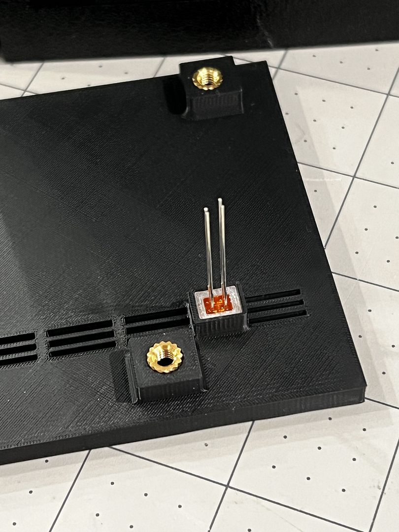

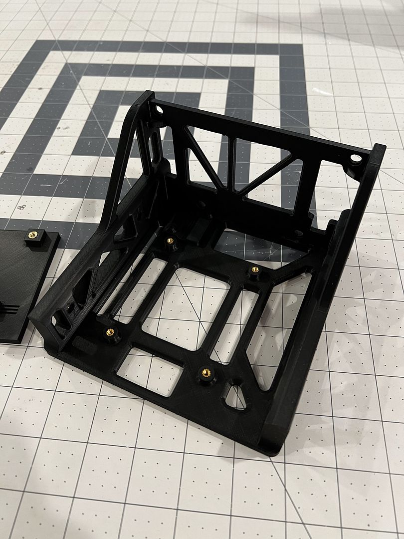

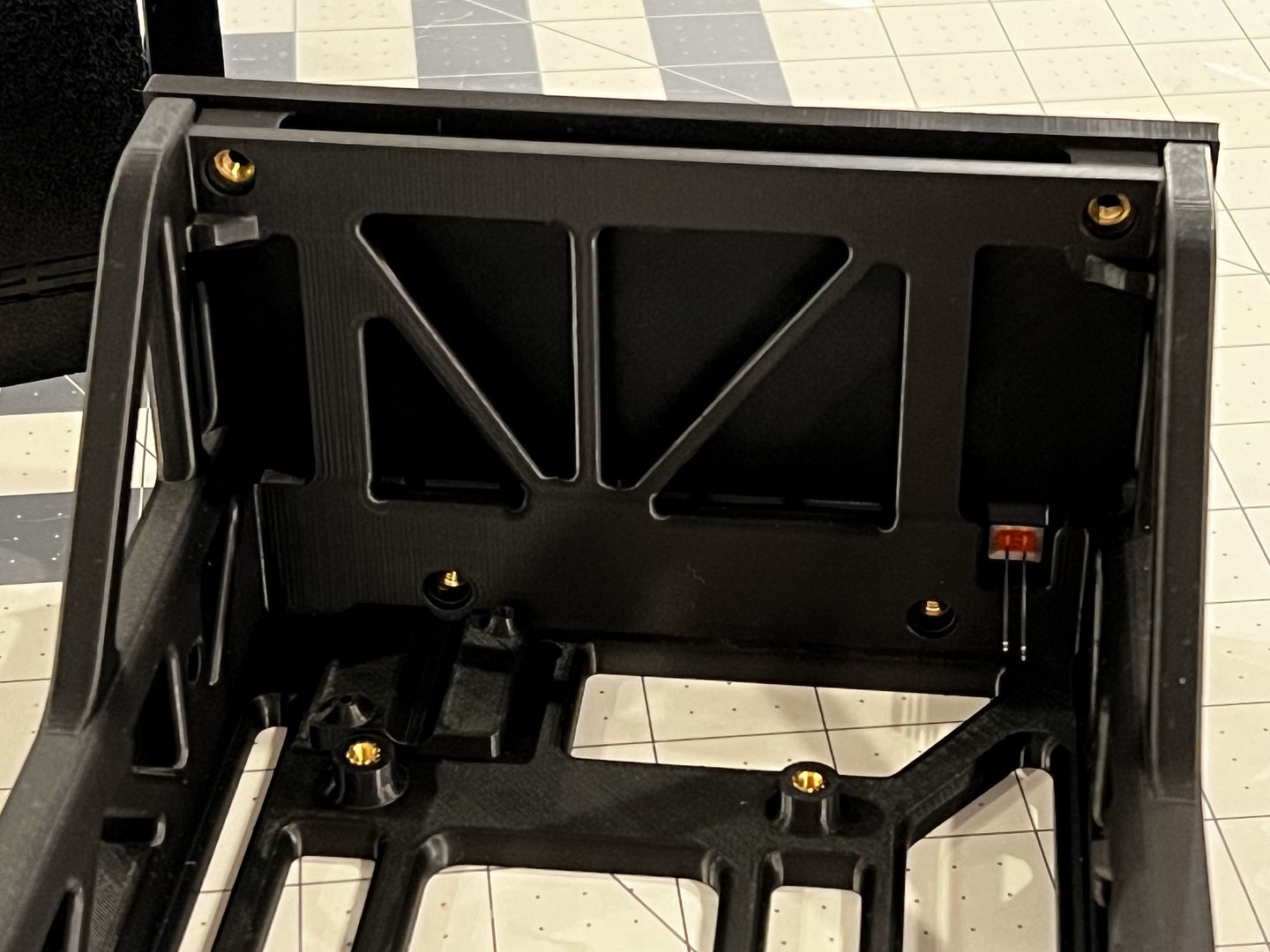

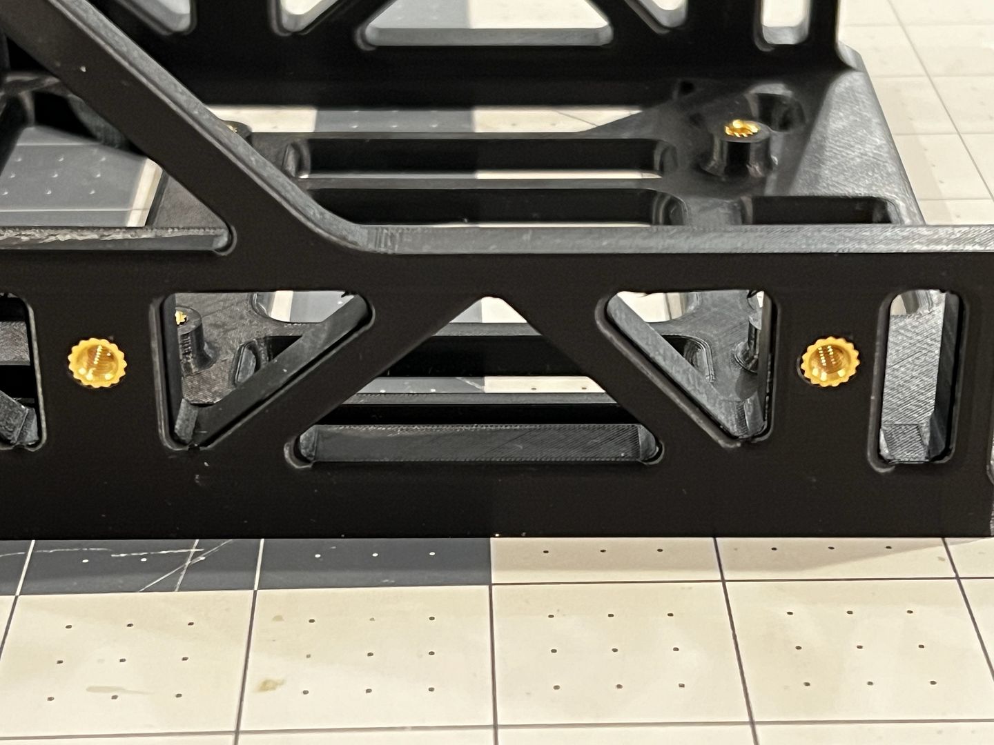

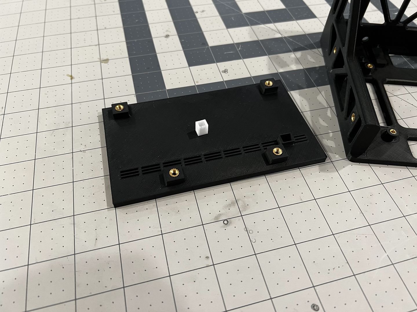

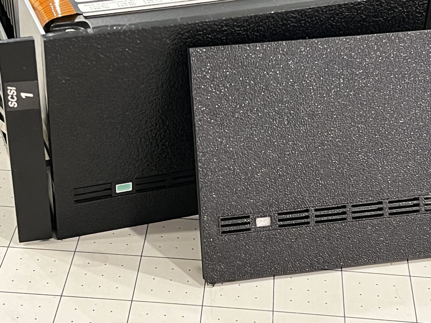

With a solid design that balanced strength and less material, I started printing. One thing to note is that the front texture on most FH drives of the era can be emulated very well by the textured PEI beds that are on the market. In my case I used a Bambu Lab P1S with a textured bed to recreate the faceplate texture and it came out looking almost exactly the same. Once I had the three pieces printed I installed the heat-set inserts, the ZuluSCSI, Beleth’s Drum, and wiring. Installed in the sled it looked really slick.
I relied on heat-set inserts and screws from CNC Kitchen. A combination of M3 and M4 screws allows the faceplate, ZuluSCSI, and frame to be installed and removed as needed. You could glue the front plate to the sled if so desired, but I like being able to take things apart in the event something breaks and needs to be replaced. Of note, the frame and faceplate were printed in PLA, with the LED diffuser printed in clear PETG.

The ZuluSCSI is a phenomenal replacement for these older machines. It is extremely simple to configure and does a great job of working just like the older SCSI drives it replaces. While there are no major quirks I’ve run across, I will note one minor issue: IRIX 4 and IRIX 5 are not able to accurately read the drive size within the disk manager application. The drive will show that it needs to be initialized and will report an incorrect size. That being said, inst reads the drive with no issue and shows total space, used space, and free space. I’m not sure why this discrepancy exists, but it’s something to be aware of and, at least in my experience, hasn’t been an issue with daily use.

     -          Beleth’s Drum (creates period-correct clicking sounds to emulate head seeking)
     -          Molex to 2x Berg Floppy (only needed if using Beleth’s Drum)
