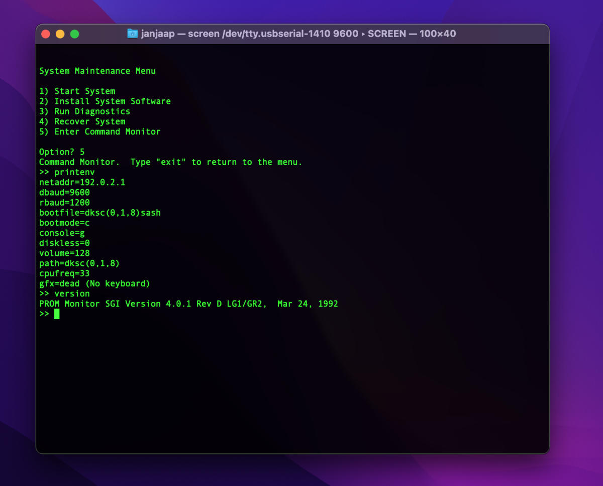

I was curious so I gave it a try. This is an R3000 Indigo Elan. I normally use it with a keyboard, mouse & screen attached.
[Image: screenshot.jpg]
The graphics board is still in the system...
If the 'console' is set to 'd', then you'll get the "Running Power-On Diagnostics" and "Press ESC to enter PROM" messages as well.
