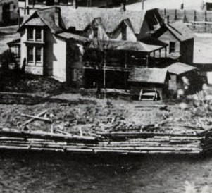

I've done some pretty big projects that would have been completely impossible without a lot of help, I built a three-car garage. Gutted, rebuilt and winterized a two-story screen porch. Roofed new houses and re-roofed old ones, painted a bunch of houses including my mom and dad's 1860s era house on the Chippewa River in Eau Claire, WI (picture circa 1910).
