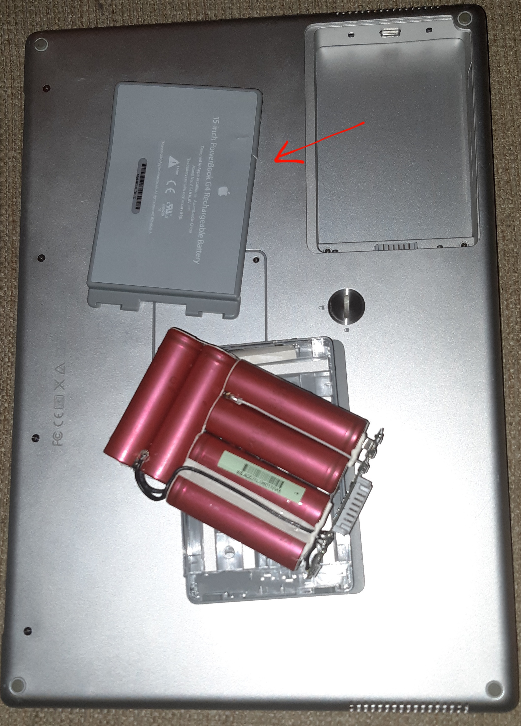

I have a few G4 laptops with worn out batteries that need a rebuild with fresh cells. I'm a tad nervous about soldering directly to the terminals but I think it'll be okay as long as I don't keep the iron on it too long.
Can someone who knows what they're doing give me a little help with purchasing parts? I don't know anything about batteries. Is it okay to use the highest capacity batteries I can buy or should I try to match the originals? What other specs should I look for?

The cells should be replaced with the same chemistry as the BMS (battery management system) is programmed for that specific voltage/charge curve.
The original cells were NMC chemistry types like the Sony US18650GR, so they should be replaced with NMC 18650s without a button or internal protection, and with partial wrap (exposed ends) because that saves the step of cutting the wrap back to attach the tabs.
Suggest you use a tab welder and not a soldering iron because it is rather difficult to solder to the cells. NMC is not likely to explode but any extended heating will damage them and reduce capacity/life.
This user was successful in soldering replacements, but he used sets from Dell batteries with tabs already attached in the right manner (2P4S). You might be able to find cells with preattached tabs somewhere.
http://www.neufeld.newton.ks.us/electronics/?p=149

Thanks for the info. Do you know where I could get the Sony cells you mentioned? I looked around found some used ones but they're listed as Lithium Ion G8 and they don't mention NMC. Those are here:   https://higherwireenergy.com/products/so...0mah-rated
My PowerBook battery is also a lot different than the one from the article you linked. I don't know if that makes a difference. It's one of the later models with a 1.67GHz CPU.
I managed to get it open with minimal damage to the casing. I don't want to spend the extra money on a tab welder machine so once I get the parts I will just try to do the repair with a soldering iron.

The specific brand isn't important (although don't buy UltraFire or anything else named after a fire).
You simply can't solder with normal methods to a battery case, it's made of stainless steel. Look for cells with tabs preattached.
