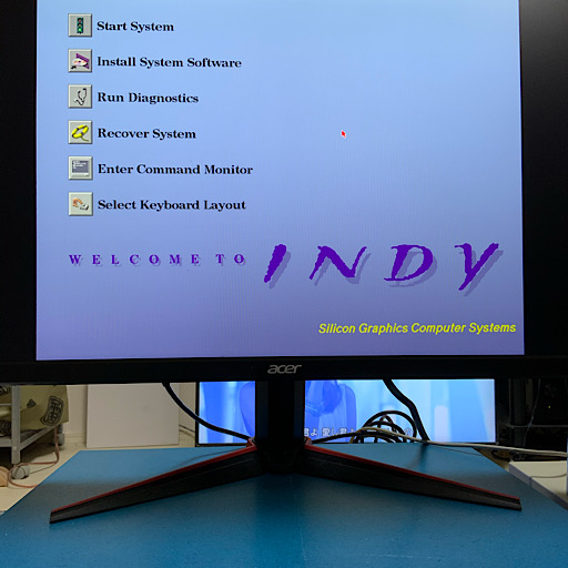

Hi, I returned to start line again.
Failure is on system board, I replaced, then run and sound of tune is there ! I bought YAMAHA’s CD-R/W drive. I am ready to install OS (I have 5.3 and 6.2).

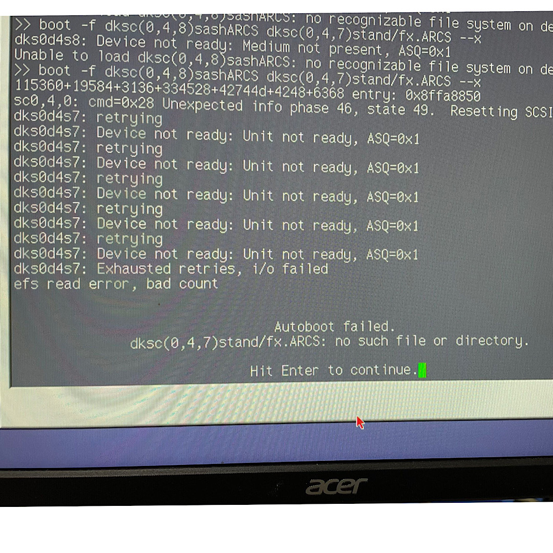

Now I meet scsi error (see photo).
I accessed inside of YAMAHA CD-R/W drive, it does not short 512B Block jumper.

Now Indy can access to SCSISD v5.2 and recognizes it. I try to format with fx on IRIX5.3 or 6.2, then meet an error of directory in CD-ROM for the fx, or error on aynch on SCSI2SD (shown in the picture).
I address “stand/fx.ARCS” because of it is IP22.
Does anyone know or suggest solution, picture is case of 6.2, 5.3 is same state.

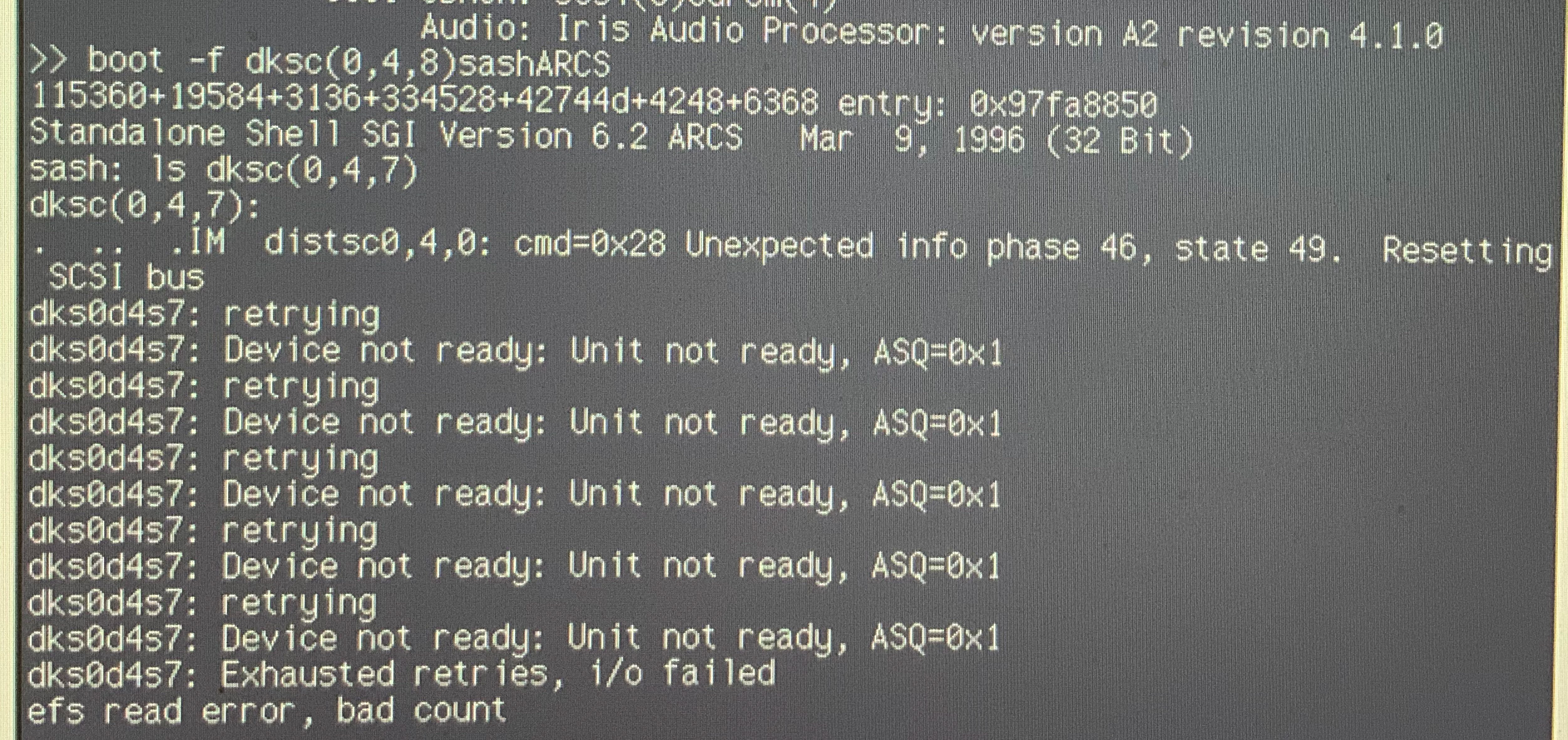

It does appear that something is amiss with the CD-ROM drive or the SCSI bus.
Try this, to see if the Indy can access the CD-ROM:
>> hinv -v
should appear:
SCSI CDROM: scsi(0)cdrom(4)
try:
>> ls dksc(0,4,8)
>> dksc(0,4,8)sashARCS
sash:  ls dksc(0,4,7)
sash:  ls dksc(0,4,7)stand
sash:  dksc(0,4,7)stand/fx.ARCS -x
If any communication with the CD-ROM drive produces errors, then there is something wrong with the SCSI cables, the SCSI termination, the drives, or the mainboard.
SCSI is a shared bus. One drive (for example, a SCSI2SD) can misbehave and cause problems with accessing another drive (for example, a CD-ROM).
For this reason, I would suggest that you remove any SCSI devices from the Indy, and try to boot from the CD-ROM as the only device connected to the Indy.
After you have verified the CD-ROM is working, you can connect another drive and test it.
Note that external SCSI devices must be powered on before starting the computer.

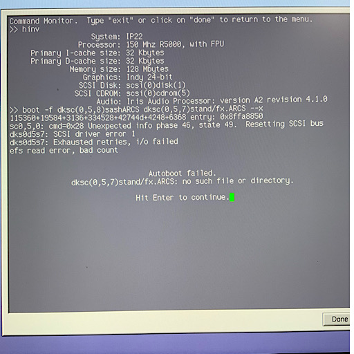

Hi,
I tried to check;
1) SCSI2SD v5.1 stand alone
2) CD-ROM Drive standalone
with Robespierre-san's advice (huge thanks to you!).
SCSI2SD has no problem, but CD-ROM drive makes many errors for a bus resetting.
I doubt SCSI2 cable, and now order it at eBay.
