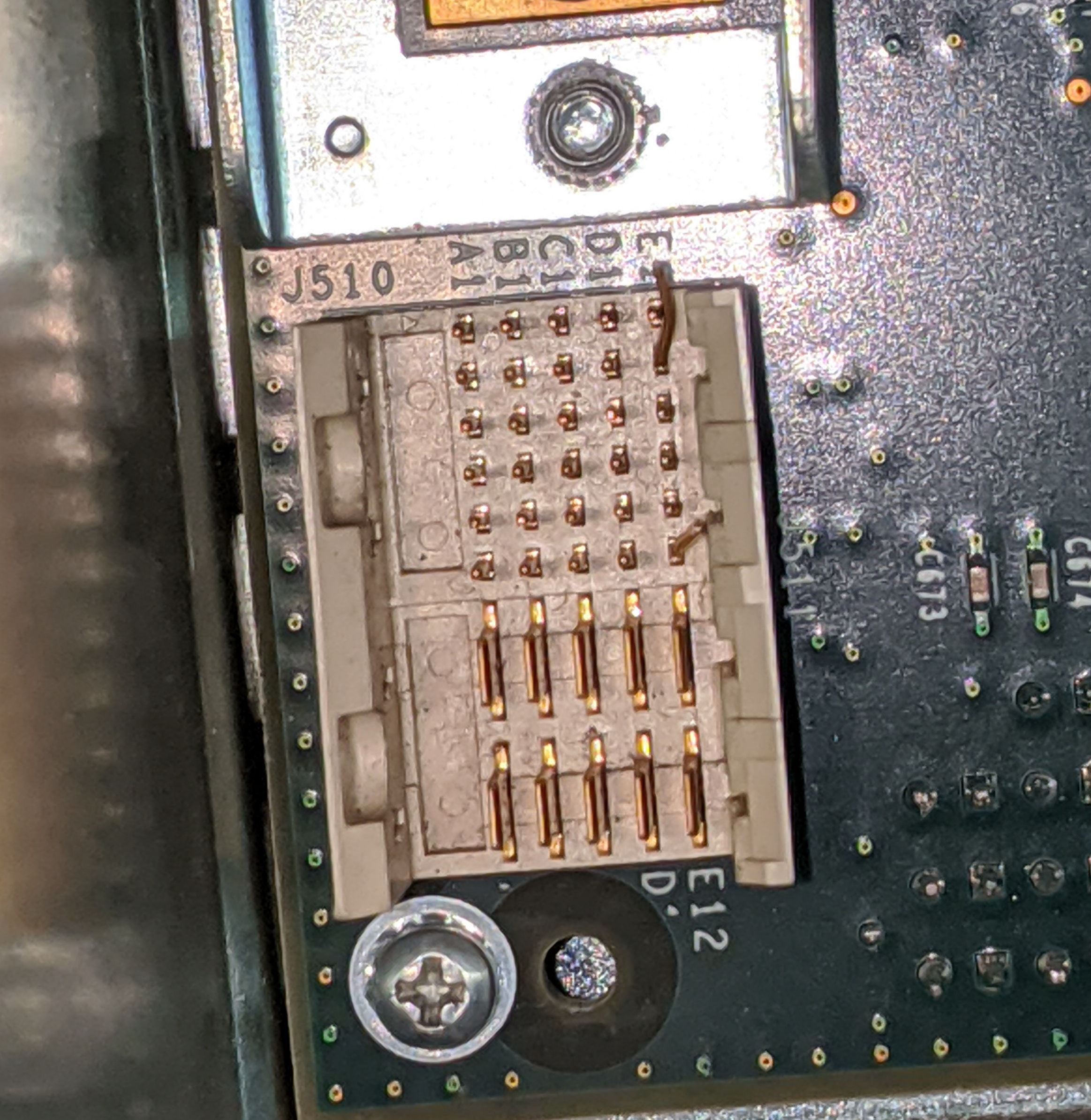

New day. Clear head. Fresh coffee. And...let's see if I can attach an image. I think I've found the issue.
tl;dr (or if the attachment doesn't work, because I'm a n00b): Several bent pins where the mobo connects to the frontplane. Not sure how best to unbend them, or if I should just try to get a new frontplane. Maybe a good time to upgrade my xbow version.
That explains why it used to work, then stopped. I must have borked them when reseating the mobo one of the times I did it. ID-10t error.
/thread
"The file "IMG_20200416_071456.jpg" is too large. The maximum size for that type of file is 2048 kilobytes" oops
Image attached this time.

Ouch. Very ouch. Might as well try straightening them. Fortunately frontplanes are somewhat common on eBay, I bet Ian has some as well.

RE: Attemting fresh IRIX install, mkfs crashes
I sure hope you come right, as pins that are that bent usually just snap when you try to straighten them! :(
