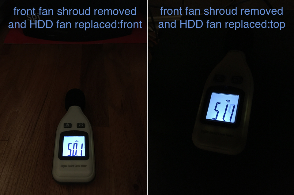

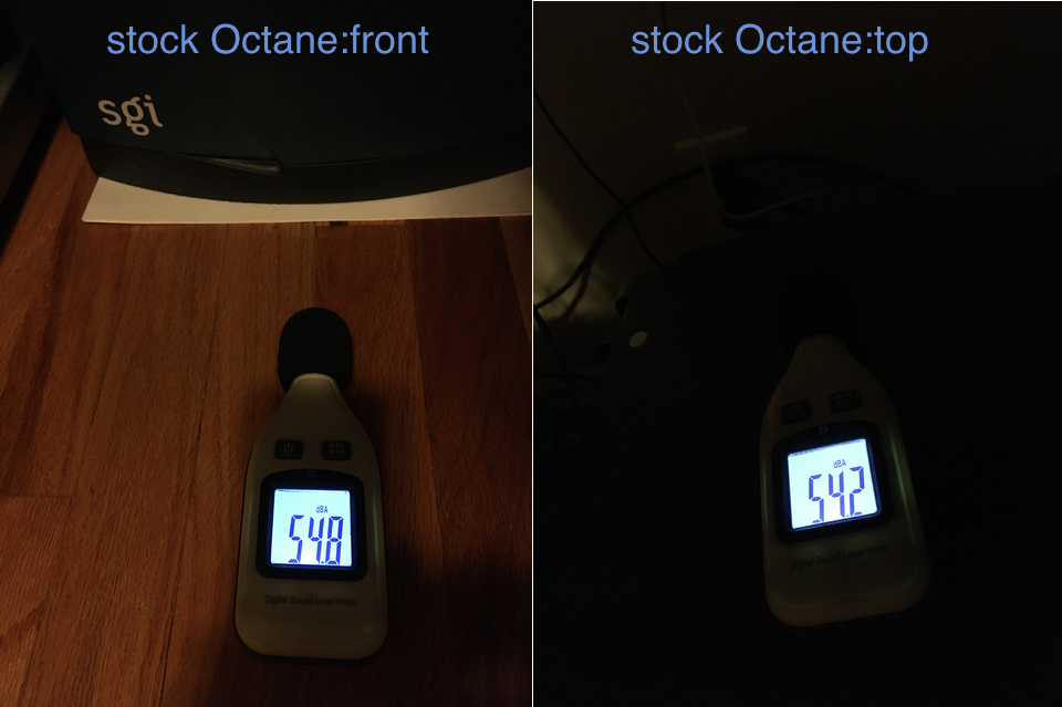

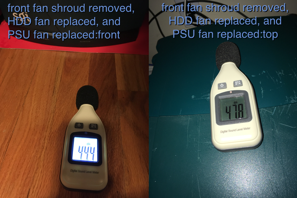

In case others are interested, I did some measurements and posted a separate thread here. I took measurements of my Octane in three states and two positions:
1. stock Octane, measured from front and top
2. Octane with restrictive aluminum baffle removed and HDD fan changed, measured from front and top
3. as above with stock Cherokee fan replaced with Scythe, measured from front and top
The changes made a big difference. I followed JacquesT lead with fan choices. His post on silencing an Octane is great and my octane is quieter than my sons PC.
