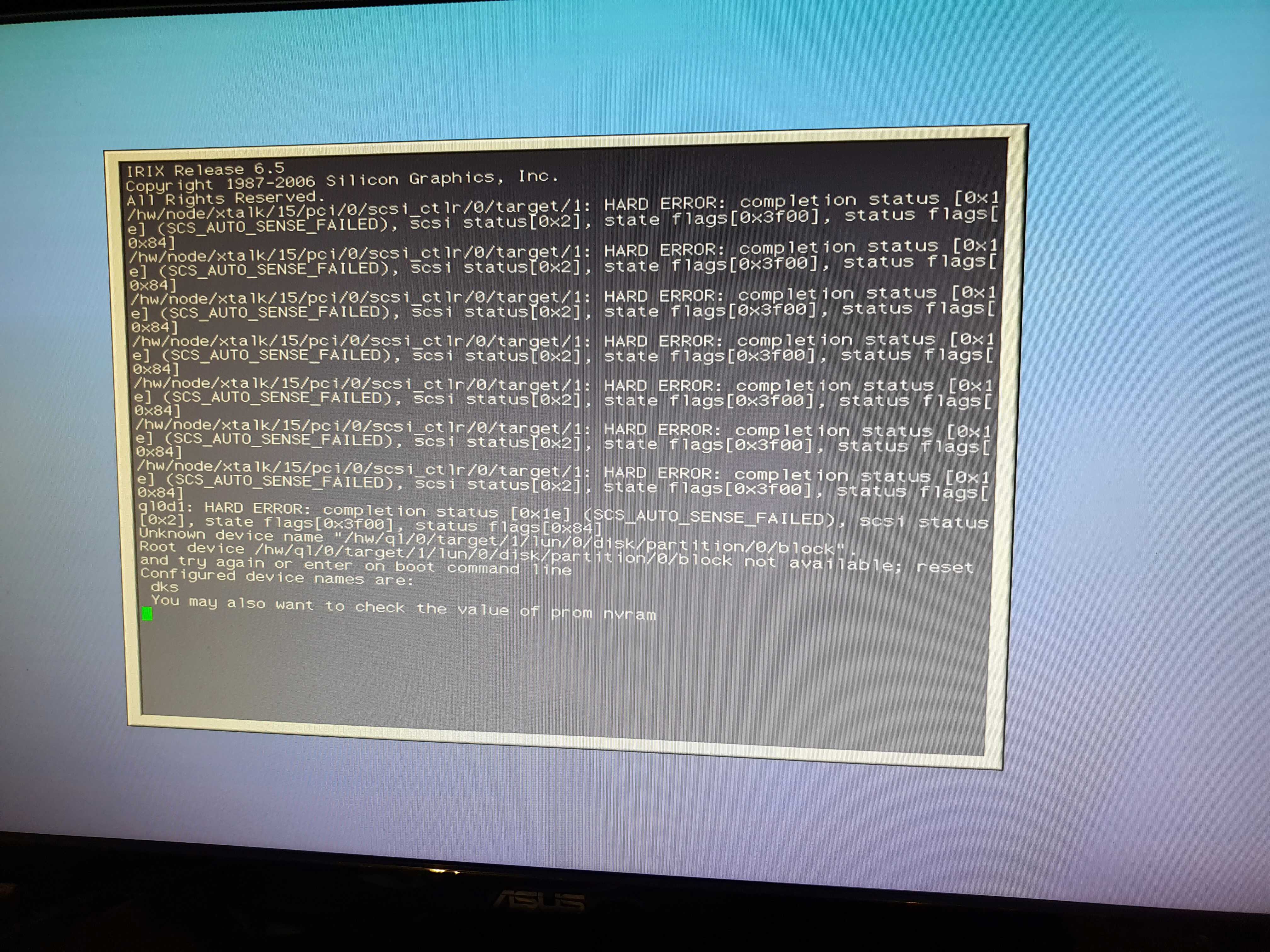

When I initially installed the current drive into my octane I didn't have the correct length of screws, 6/32 x 3/8", I took this time to put the correct screws in. At the same time I installed the 300g drive in hopes of doing a dump onto rather than doing a full blown install all over again.
When booting the octane, I noticed it was taking far too long. Attached is the error on the console, I'm hoping there's an easy fix rather than going the install route.

So wait, you're saying you created the new disk using dd and are trying to boot it? Unless the disk you dd-ed from is the same size (preferably the exact same disk from the same manufacturer), it won't work. You need to use Ian's disk cloning procedure instead, link:
http://www.sgidepot.co.uk/disksfiles.html#CLONE

I was attempting to follow this guide:
http://www.cspry.co.uk/computing/Indy_ad...ackup.html
However, my octane won't even boot now even before I attempted to do anything other than reseating the drive. The only other thing that was done was the installation of the target drive I was going to do the xfsdump to.
