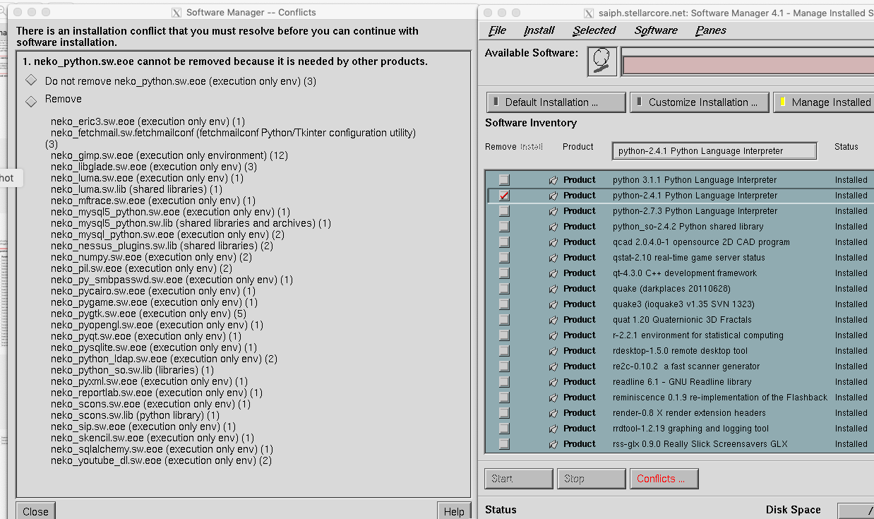

The Dependencies on Python 2.4.1 from nekoware and extensive. Screenshot.

(01-22-2020, 08:10 PM)mgtremaine Wrote:  The Dependencies on Python 2.4.1 from nekoware and extensive. Screenshot.
Scary, right? This is why it is essential to have a proper python first, before you can build the packages that rely on python.
Also, Python modules have many dependencies on other lower level libraries so before you can build Python, you need to do those first, which is why it took me two years to arrive at this point.
