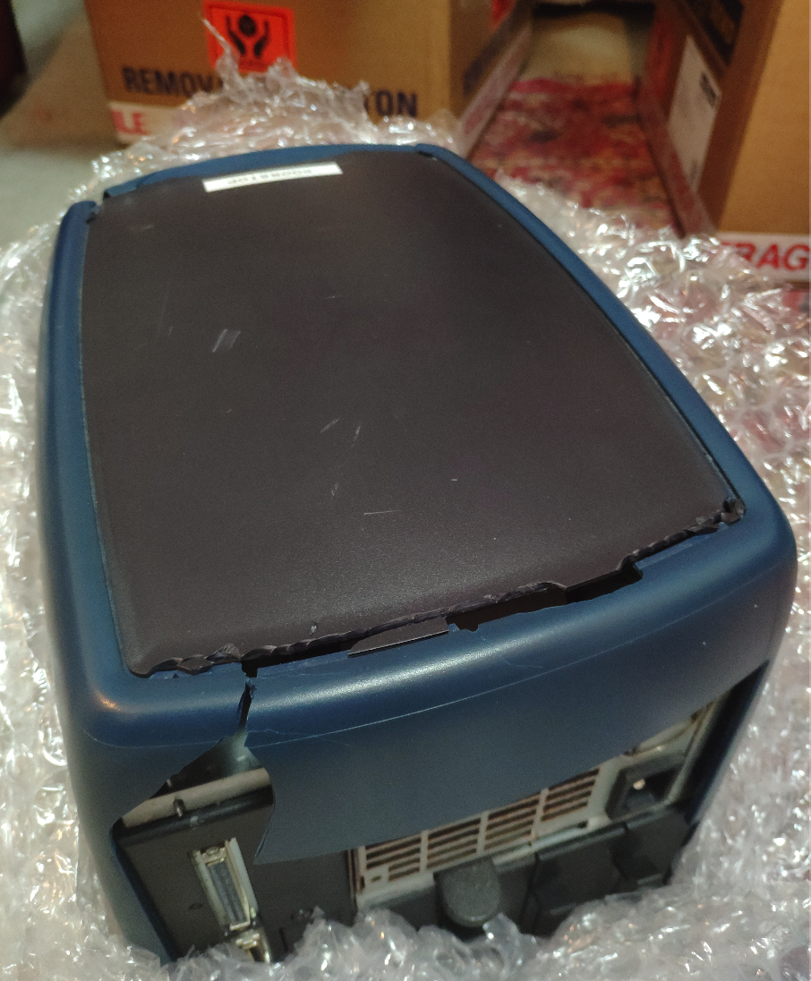

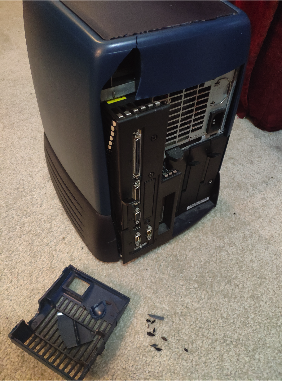

Hi All.
I have a tragic story, long one short, I was given 3 SGI's, all of them were thrown off the freight truck and cases were very badly broken.
One O2 was an old style case and one a new style.
the Octanes flip panel broken too.
Can these cases be replaced?
any recommendations.
Its a shame as the 2 O2's were in factory shape.
Im really saddened by this, I hate to replace the existing cases but the restorer in me feels they have gone too far to repair.

I would say that is a doable repair job. Tape the bits together on the outside, then use a mesh and expoy on the inside where you won't see the repair works. Take your time and check the fitting of pieces before glueing. Don't use super glue / crazy glue as it will leave white marks on your case.
You may be left with some hairline cracks on the outside. Replace the top panel completely, these aren't that difficult to come by. You can also replace the cd drive cover, somebody will have one. I think there is one one on ebay.

I will repair for now, but man these are brittle plastics, im glad the 1600 monitor survived, that thing fired up perfectly.
