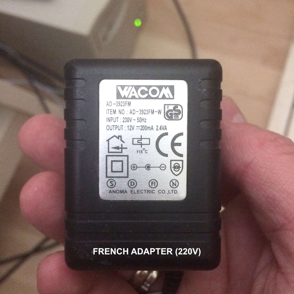

Hi def13, I’ve finally got an original AC adapter so the Wacom is powering up now. Unfortunately I’ve still had no luck in getting the wacom to run. I’ve recorded a video that shows what I’m doing to install the drivers. Would be great if any of you guys could have a look at it and possible point out what I might be doing wrong.

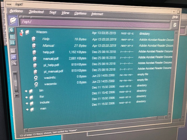

Thanks for the file. Installed the control panel, but it only dropped one file. TabCP-En.znc. The fsck instructions say to now run /usr/sbin/wacom, but I don't have that. Maybe it's expecting me to extract the wacom.tar via swmgr somehow but I don't want swmgr to follow the installation scripts. I just need the tar from the product and manipulate everything manually.
Ok, managed to copy over the wacom.tar mid-install and then uninstall. Have to start from square one with reinstalling optional input devices from Overlays 1 and re-configuring X11 input config, but I did get the control panel (wacomcpl-6.5_3 for MIPS3 or wacomcpl-6.5_4 for MIPS4). Unfortunately, I still get the "Could not initialize the Driver Interface" error even with this version. Oddly enough, the 4.7.2 package popped up a license manager window first asking me where's my Wacom device and it didn't seem to recognize it (probably since I didn't set the serial port to be a Wacom device first?). 4.8.0 didn't spring up any license manager. Maybe the latter doesn't require a license? But for either version, I'm ending up with that Driver Interface issue.

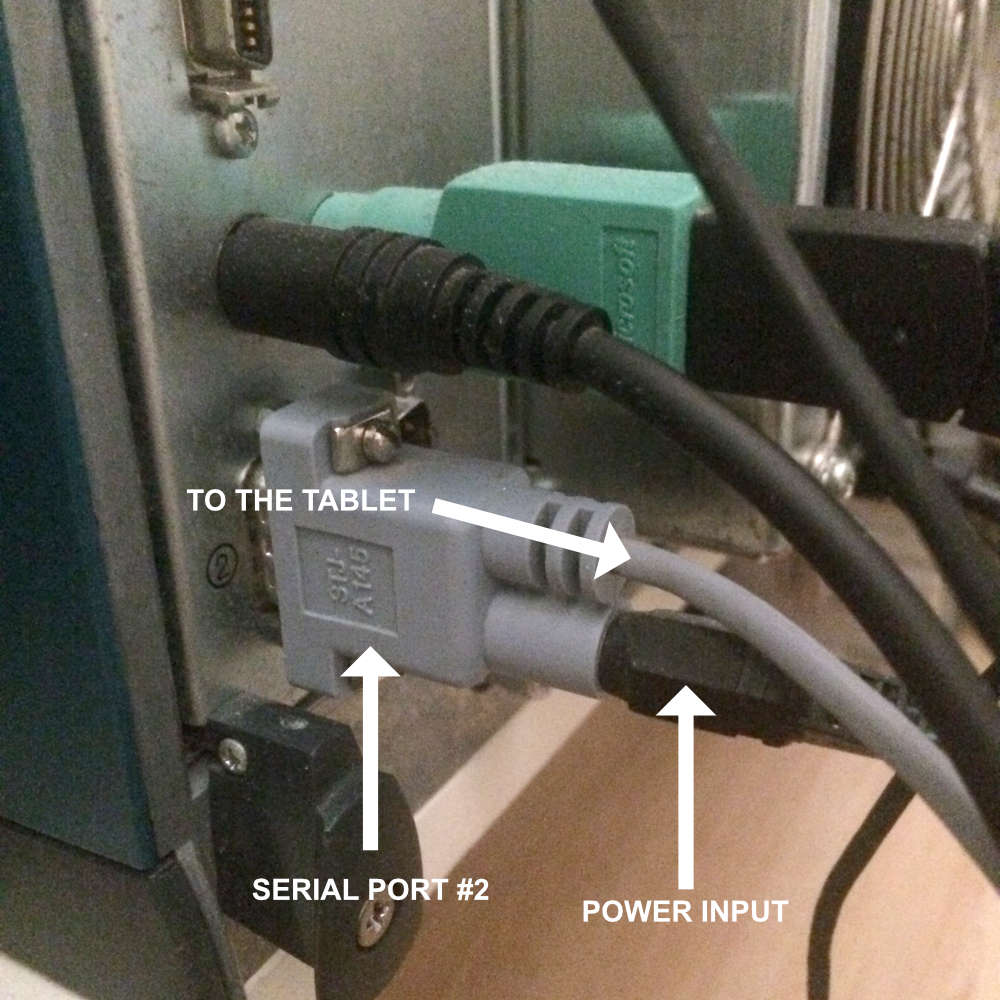

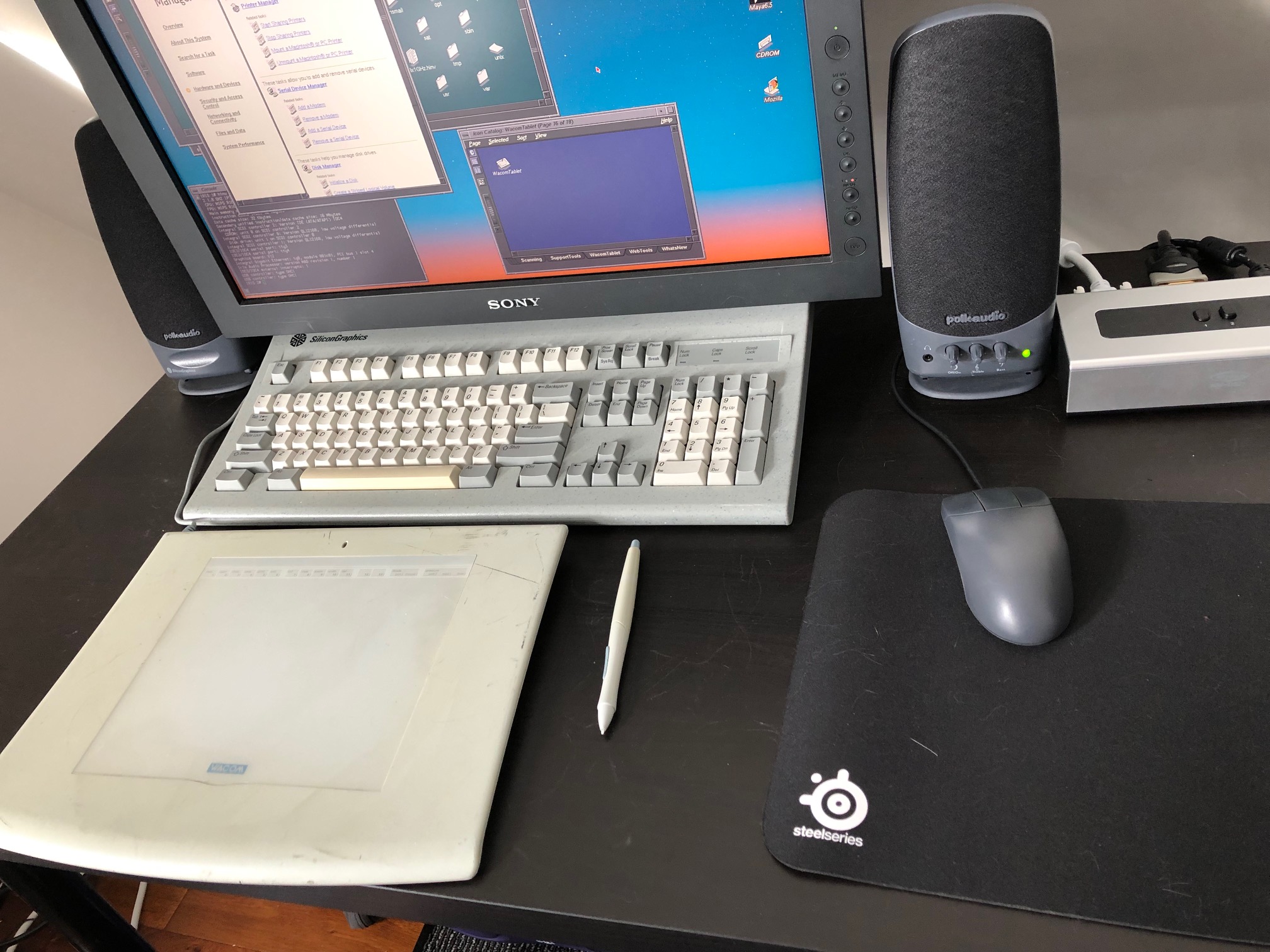

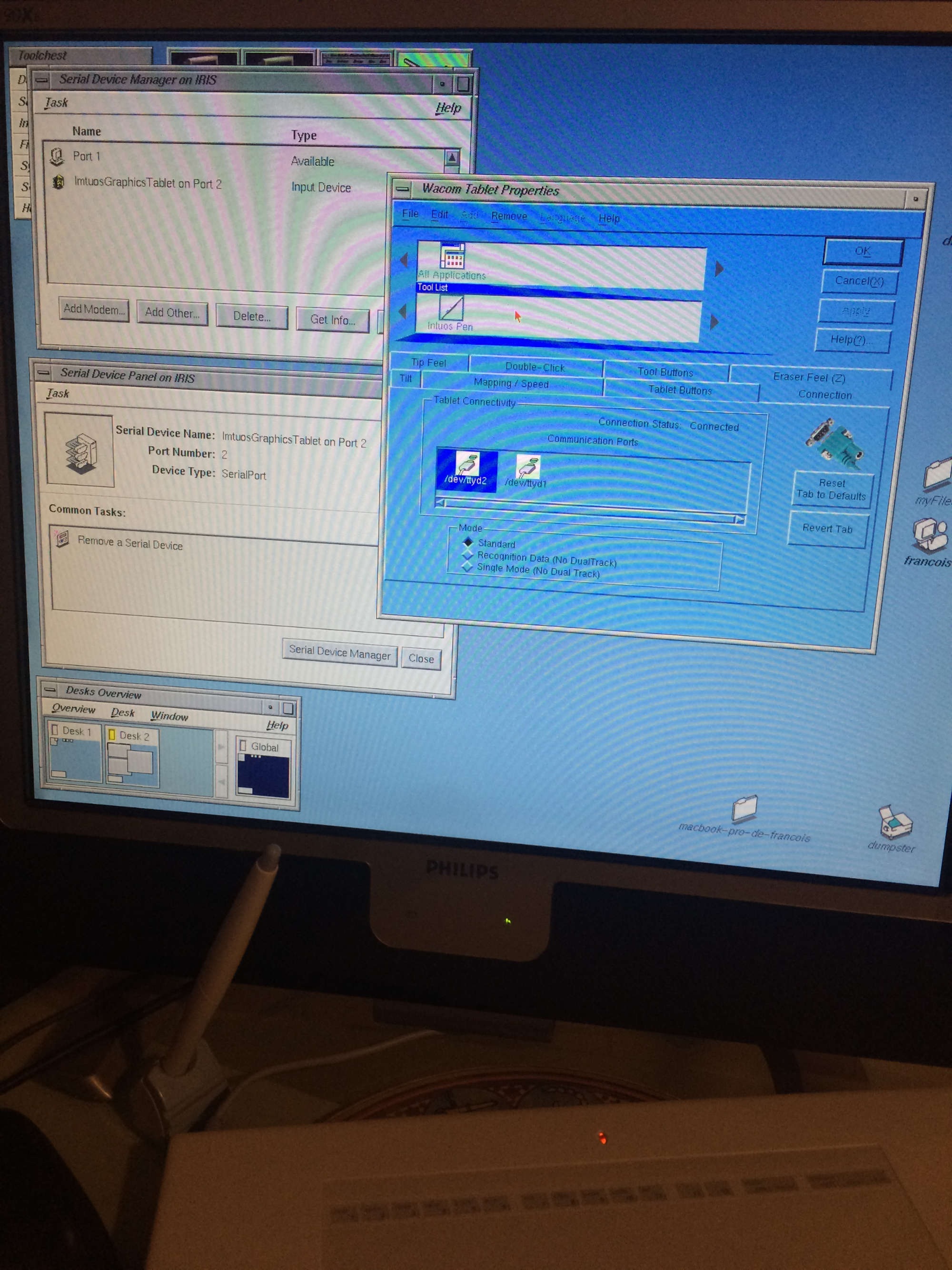

Even greater news, I got the drivers to work perfectly now. It seems the install expects you to have the tablet connected to serial port 1 when it's normally for terminal. No need to associate any of the ports as a Wacom port, nor you need a wacom config file in X11 input config.
So here's how I got it to install and work correctly on my O2:
1. Make sure eoe optinput is installed and restart.
2. Go to the Serial Device Manager and delete each port association to ensure they're all available.
3. Connect the Wacom tablet serial to port 1.
4. Install the Wacom 4.8.0 driver and restart.
5. Once you get to the log-on screen, you should see the cursor move in tandem with your pen.
6. Log in to your user account and proceed to calibrate the pen through the control panel.

1. This has been tested in 6.5.30 on my O2.
2. optinput comes from foundation 1. In my case, the software manager did ask me to have overlay 1 alongside foundation 1 to install it.
3. My Wacom is the Cintiq 18SX. It came out in 2003, so my steps mostly apply to just 6.5. I have not tested 6.2 or 5.3.
