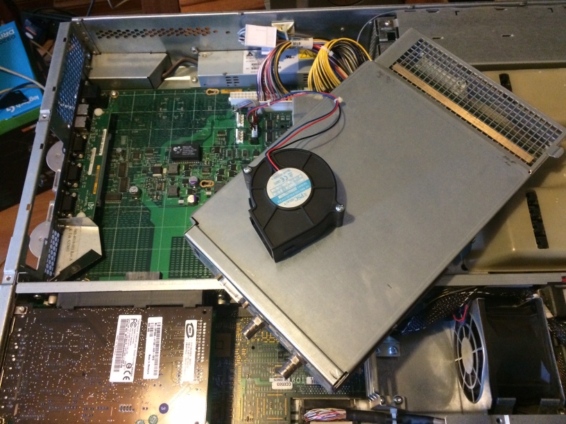

As you've probably already discovered there should be a fan attached to the underside of the graphics board. It connects to a standard three-pin fan header on the system board, but uses the non-standard IP35 SGI fan pin-out.
If your graphics board is disabled due to mechanical failure, if an original O350 rack-style graphics board isn't readily available you should be able to temporarily replace it with a Fuel V12 or V10 until an original replacement becomes available.

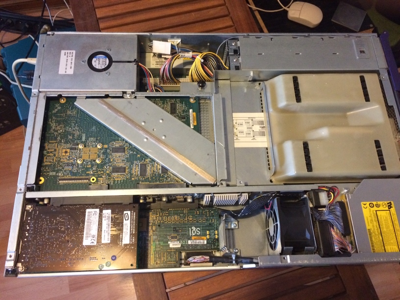

Here's the sick child (quad 700mhz, 8GB RAM, V12):
And here's the fan that seems to be dead:

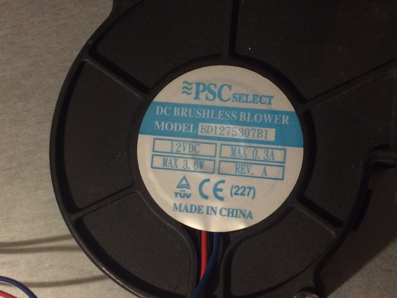

This is the blower details in close up:
And from a little hunting (manufacturer website is still there!) - it seems to be very similar to their current products listed on this page:
http://www.pscmf.com/product/showproduct...15&lang=en
From the product number on my dead fan - BD1275307B1
BD12 - Blower DC 12V
7530 - Seems to be the product housing / dimensions
7?
B1 - Ball bearing
Which matches up to the RBD7530B1, which is rated 12VDC 0.5A, 3800 rpm.
So my first attempt I guess will be to try and source a replacement fan (taking care to respect SGI wiring) and see if that brings the V12 back to life.
I tried booting headless, but unfortunately it doesn't like that - so no go till I resolve this.
