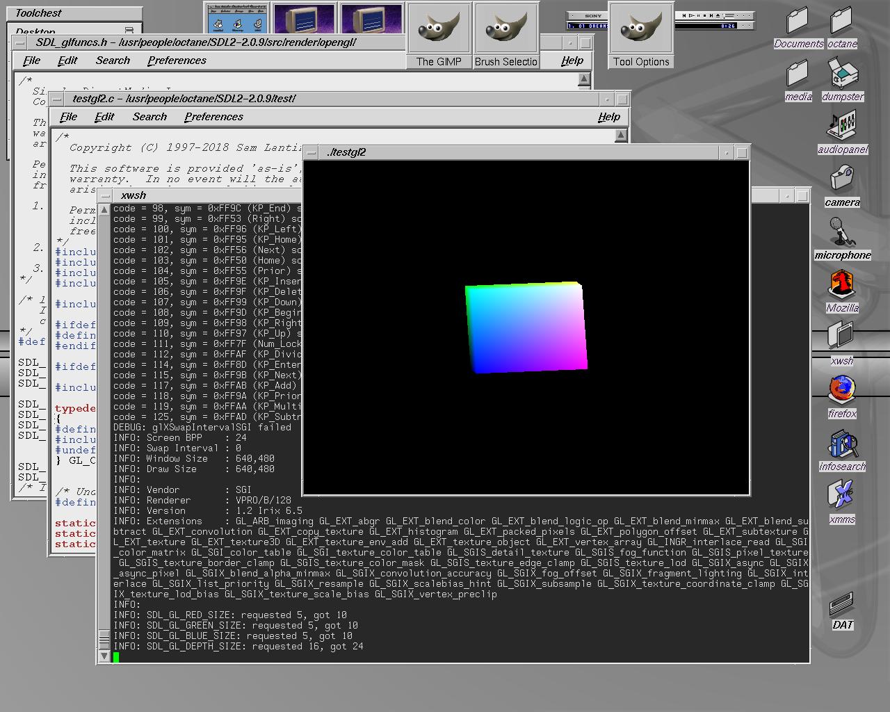

I had a look at the Neko GemRB, and in my not so professional opinion, I's not going to be a pleasant experience without SDL2/OpenGL on IRIX. Now, that said, I have SDL2 and SDL2_mixer building on IRIX now and GemRB building against that. The SDL still needs a bit of work before it's usable.
I don't know if this will address the random crashing, which I didn't observe in my ~15 mins of playing the Neko tardist. But I can say with confidence, it's not worth putting time into this until there is a working SDL2.

03-05-2019, 08:06 PM
RE: 1000$USD Bounty to fix GemRB for IRIX
I though I'd share a little pornography.

The SDL2 is working and a few people here have the patch.  I have some very minor loose ends to wrap up and I'll post it here.  OpenGL, audio, threading, atomic ops, etc. are all working.
