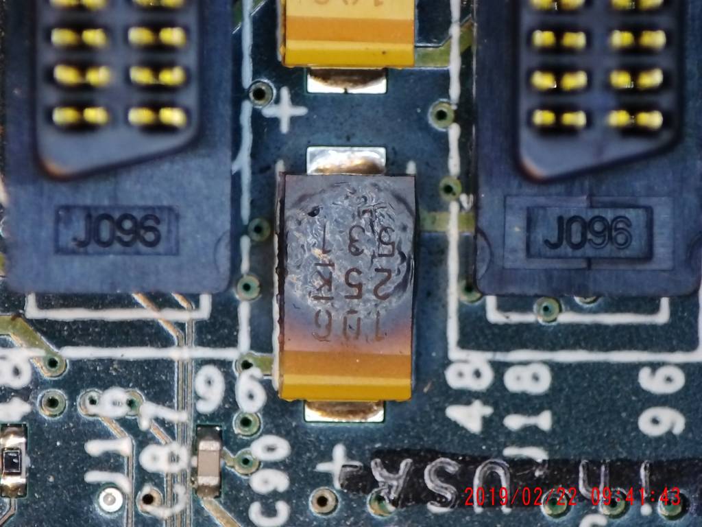

I was building a mini-DIN8 to RJ45 serial adapter cable to connect systems using those (Indy, Indigo2 ...) to my Cyclades console server yesterday. Used my Challenge S to try out the finished product and after a couple of seconds realized the smell wasn't good. First I thought I screwed up my cable, but it blew a tantalum cap between the GIO sockets on the mainboard:
Took it to work this morning (I took this photo in the lab). Amazingly we still had some of those (10ยต 25V) in a box of old junk so if I have some time this afternoon I'll replace it.
The system never stopped working by the way.

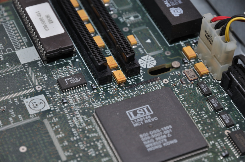

Wow, looks like the Challenge S is not immune to blown Tantalum caps. I've seen this happen on Indy's at a different location near the Indycam connector, which renders the Indy unable to boot.

RE: Challenge S blew a tantalum cap - jan-jaap - 02-24-2019
(02-23-2019, 12:19 PM)dexter1 Wrote:  Wow, looks like the Challenge S is not immune to blown Tantalum caps. I've seen this happen on Indy's at a different location near the Indycam connector, which renders the Indy unable to boot.
I looked around if these capacitors are common: Mouser has them:
https://eu.mouser.com/Passive-Components/Capacitors/Tantalum-Capacitors/Tantalum-Capacitors-Solid-SMD/_/N-75hr4?P=1z0wrkrZ1yx4awy&Keyword=10UF%2c25V&FS=True
I can order from Farnell using a company account which saves a lot. But we still had a few.
The Challenge is back in working order. It's not my best soldering job ever, but we have only one soldering station for leaded work left and it didn't have a very fine tip in it.

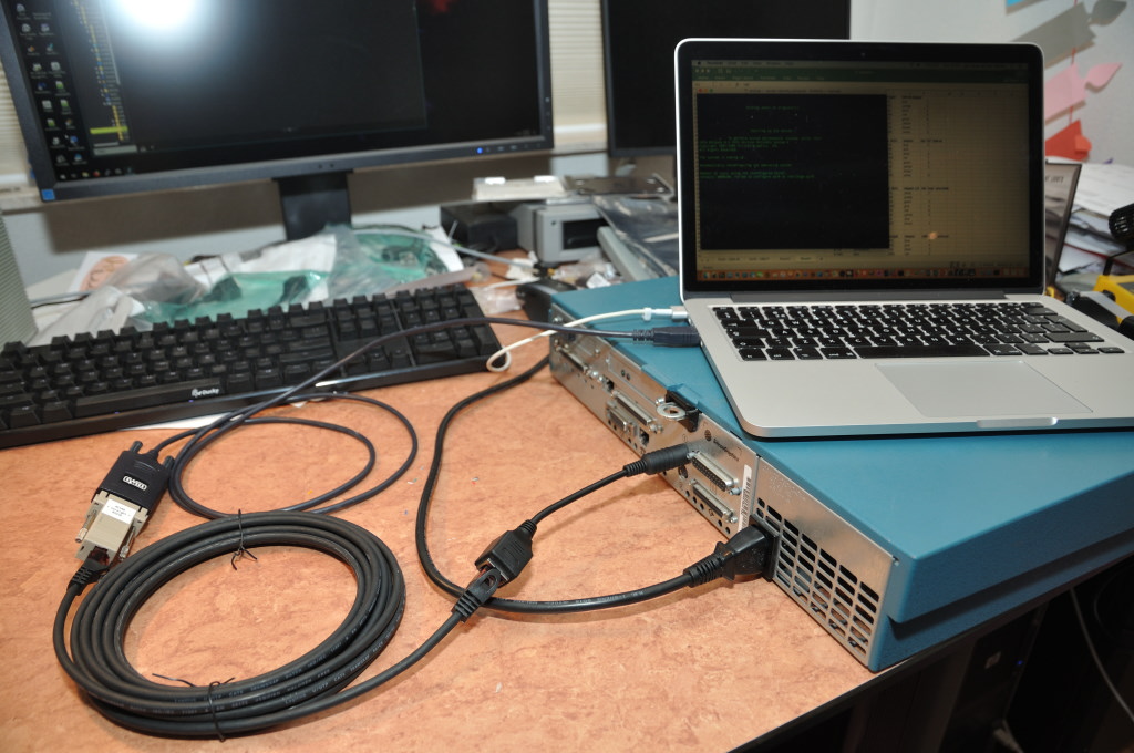

This is what I was making, btw: a short pigtail cable from (female) RJ45 to mini-DIN8, with NULL modem crossover. Here it's tested with my Macbook, but normally it's to be used with my Cyclades ACS48 console server
