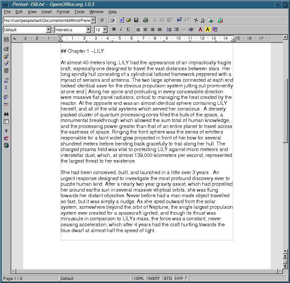

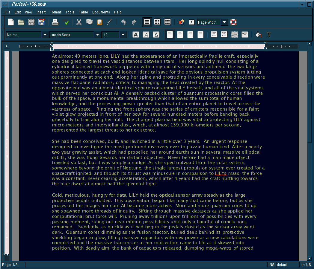

Uploading some screenshots of OpenOffice and AbiWord as examples.  I actually kinda like GTK1 apps because i've been able to tweak them so they blend pretty seamlessly with theme I use on my desktop.  Sylpheed and Pidgeon still work great for me and I have no problem with their fonts.   OpenOffice on the other hand is a trainwreck (I mean just look at it).  It looks liek Abiword 2.2.7 might be doing some sort of antialiasing but its not very good.  Its useable though.  The good news is that the SGI "screen" font for the console is prob one of the most readable non proportional font I've ever used.  Worst case I can write in NEdit and that, but not ideal.

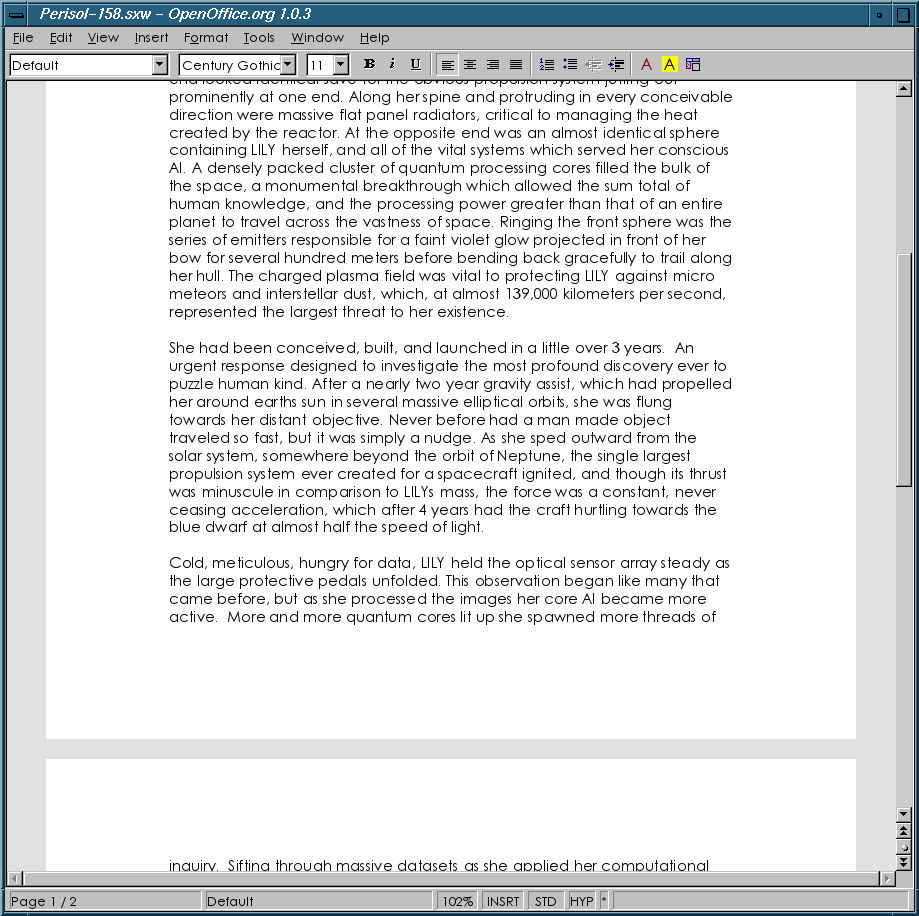

This actually yielded some decent results so thanks.  Just tried a sans serif font I found and replacing the interface and text font in OpenOffice yielded much nicer results.  I still don't know if I would want to bang out a lot of hours writing on it but it's a major improvement from the screenshot I posted above.  I'm going to be upgrading my display from 1280x1024 to 1600x1200 which should give me a nice bump in PPI and help a little also.
