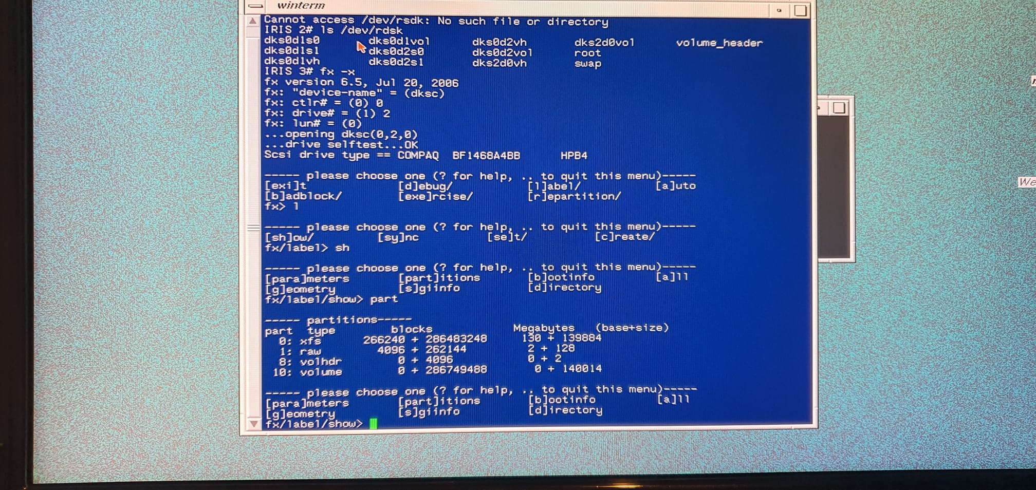

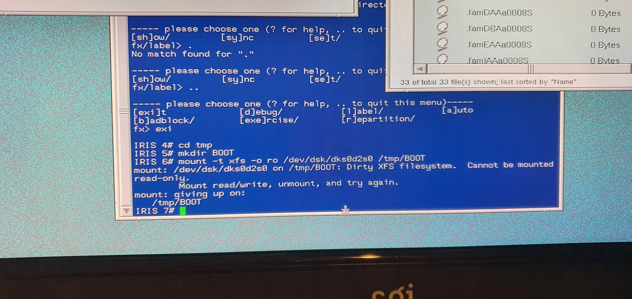

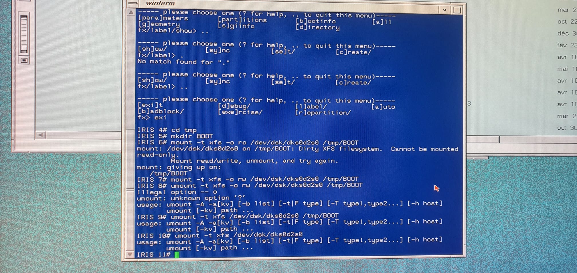

RE: big problem on IRIX due to an error on my part - jmjsgi - 01-25-2024
Thank you for answering me.
I tried with the fx command on my onyx with my system HDD tezro at slave. I have the same information displayed except the xfs part, in fact I don't know what this can do for me.
I would like test to mount the disk with the mount command but what will this cause?
Can I click on one of the commands offered by Disk Manager to make the contents of my system disk visible?
"mount a local filesystem"
or
"initialize a disk"

RE: big problem on IRIX due to an error on my part - jwhat - 01-27-2024
HI jmjsgi,
Start by reading IRIX filesytem documentation: https://techpubs.jurassic.nl/library/manuals/2000/007-2825-013/sgi_html/index.html
This explains the XFS file system layout and naming conventions.
Your Boot Disk will have partition 0 (root) & 1 (swap) & optionally 6 (usr).
To find the disk do:
# ls /dev/rdsk
dks0d1s0 dks0d1vol dks2d0s7 dks2d1s7 dks2d3s0 dks2d3vol volume_header
dks0d1s1 dks1d2vh dks2d0vh dks2d1vh dks2d3s1 root
dks0d1vh dks1d2vol dks2d0vol dks2d1vol dks2d3vh swap
The disk will be one with:
dksXdYs0 & dksXdYs1 (ie with partition 0 & 1), where X == Controller & Y == disk
Once you identified the disk you can mount it read-only: https://help.graphica.com.au/irix-6.5.30/man/1M/mount
For example:
cd /tmp
mkdir BOOT
mount -t xfs -o ro /dev/dsk/dksXdYs0 /tmp/BOOT
If it fails to mount then it means there is not a valid xfs file-system on that partition and it is been clobbered.
Having the partition label saying it has XFS partition does not mean it has a valid file-system.
To make a valid file system you need to run the mkfs (make file system) command, this would need writable disk and really will clobber what ever you have on the disk.
Man Page for mkfs: https://help.graphica.com.au/irix-6.5.30/man/1M/mkfs
